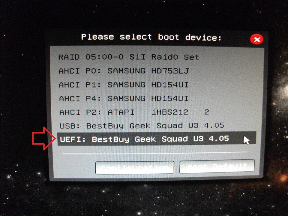

EXAMPLE: UEFI Bootable USB Flash Drive
NOTE: This is it listed in the motherboard's boot menu.

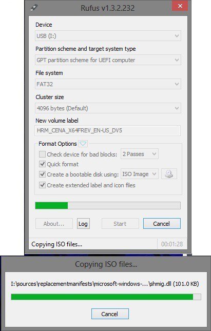

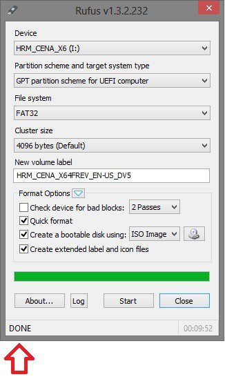

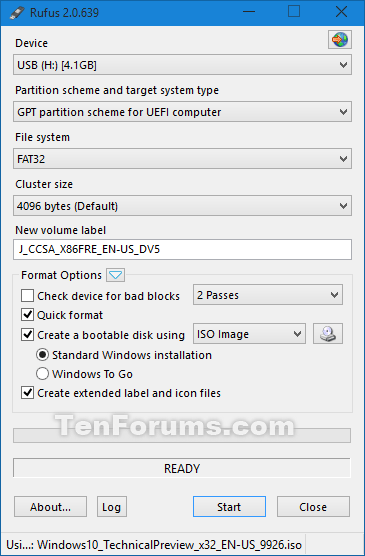

To Create a Bootable UEFI USB Flash Drive using Free Program "Rufus"
This is a standalone exe file that doesn't install anything to your PC
  • Under Format Options, check Create a bootable disk using, click/tap on the browse icon icon.jpg to navigate to and select your 64-bit Windows 7 or Windows 8 or Windows 8.1 ISO file, and then make sure that Standard Windows installation is selected (dotted).
  • Under Partition scheme and target system type, select GPT partition scheme for UEFI computer.
  • Under File system, select FAT32.

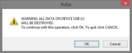

7. Rufus will now start creating the bootable UEFI USB flash drive. (see screenshot below)
9. You are now ready to do a clean install of Windows 7 or Windows 8/8.1 using UEFI with your bootable UEFI USB flash drive.

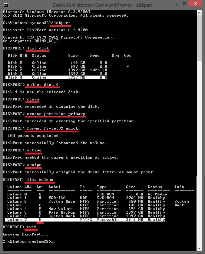

3. In the elevated command prompt, type the commands below one at a time and press Enter after each one. (see screenshot below step 5)
  • diskpart
  • list disk
4. Make note of the Disk # (ex: Disk 4) for the USB flash drive. (see screenshot below step 5)
It is critical that you use the correct disk #. If you do not, then you could delete the wrong drive below and lose everything on it
5. In the elevated command prompt, type the commands below one at a time and press Enter after each one. (see screenshot below)
NOTE: Substitute # in the first command with the actual disk # from step 4 above. For example: select disk 4
  • select disk #
  • detail disk (this is to verify that you selected the correct disk before using "clean" below)
  • clean
  • create partition primary
  • format fs=fat32 quick
  • active
  • assign
  • list volume
  • exit
6. Make note of the volume letter (ex: K) for the USB flash drive in the command prompt. (see screenshot above)

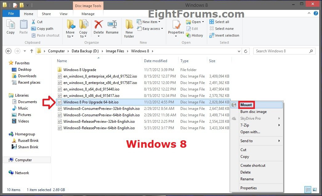

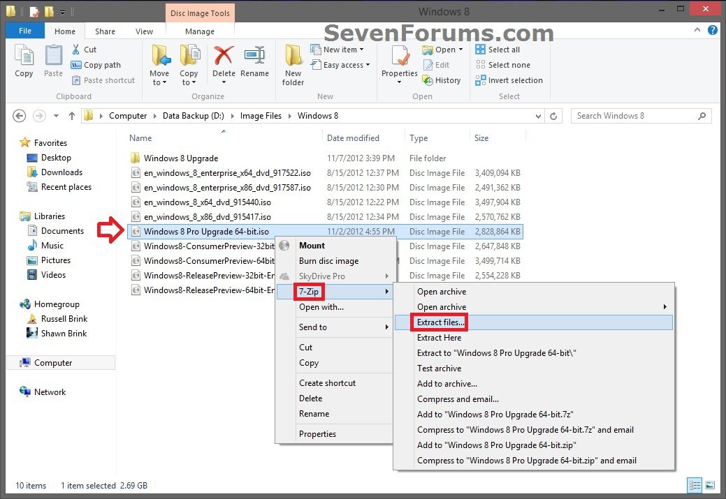

8. If Using a Windows 7 or Windows 8/8.1 ISO File in Windows 8
NOTE: For a Windows 7 ISO or Windows 8/8.1 ISO file.
A) Open File Explorer, navigate to the .iso file, right click or press and hold on the .iso file, then click/tap on Mount. (see screenshot below)
B) The mounted .iso file will now automatically open. Select all files in it, right click or press and hold on the selected files, click/tap on Send to and the Removable Disk for your USB flash drive letter (ex: K) from step 6 above. (see screenshot below)
C) This could take a bit to copy the ISO contents to the USB.
D) When finished, go to step 11 below.

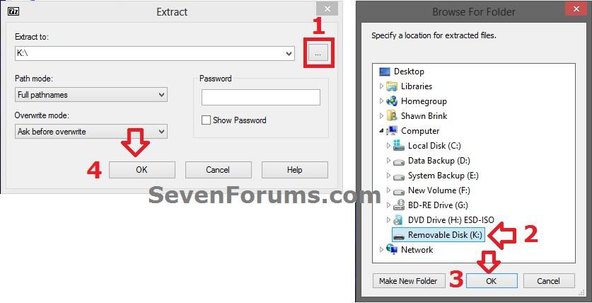

9. If Using a Windows 7 or Windows 8/8.1 ISO File in Windows 7
A) If you have not already, you will need to download and install the latest alpha version of the free program 7-Zip.
NOTE: You can use any program that performs the same function to extract or mount an ISO, but I just find 7-Zip easier to use.
B) Open Windows Explorer, navigate to the .iso file, right click on the .iso file, then click on 7-Zip and Extract files. (see screenshot below)
C) In the Extract dialog, click on the browse button, select the Removable Disk for your USB flash drive letter (ex: K) from step 6 above, and click on OK, and OK. (see screenshots below)
D) This could take a bit to copy the ISO contents to the USB.
E) When finished, go to step 11 below.

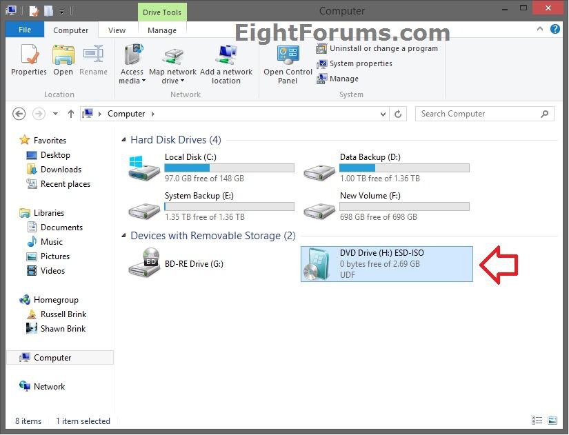

10. If Using a Windows 7 or Windows 8/8.1 Installation DVD
A) Insert the Windows 7 or Windows 8 installation DVD into the CD/DVD drive.
B) In the Computer window, open the DVD. (see screenshot below)

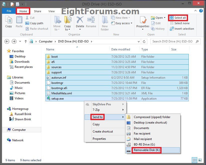

C) Select all files in it, right click or press and hold on the selected files, click/tap on Send to and the Removable Disk for your USB flash drive letter (ex: K) from step 6 above. (see screenshot below)
D) This could take a bit to copy the DVD contents to the USB.

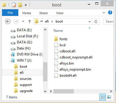

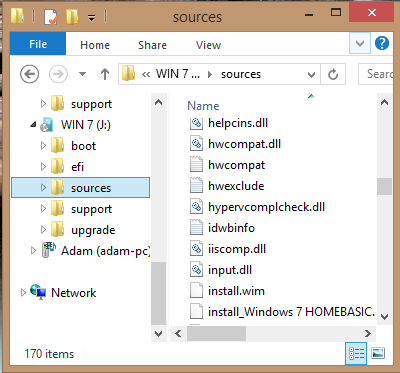

11. If Using 64-bit Windows 7
Thanks to theog for this step
You do not need to do this step unless you are creating a 64-bit Windows 7 UEFI USB flash drive.
If you are not, then go to step 12 below instead.

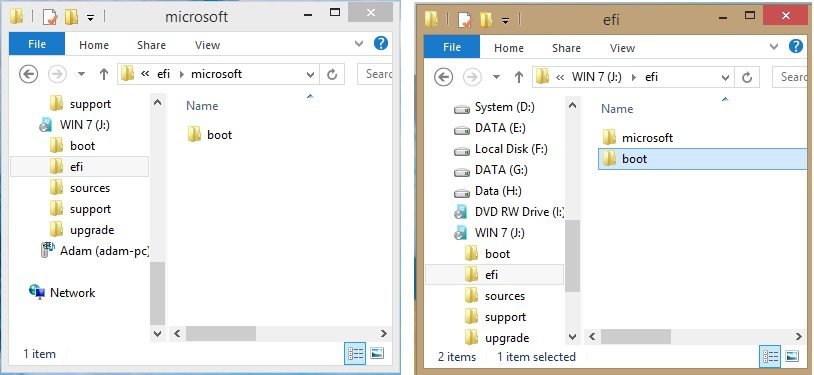

A) On the USB flash drive, "copy" the efi\microsoft\boot folder up one level into the efi folder as efi\boot. (see screenshot below)
B) If you have not already, download and install the latest alpha version of the free program 7-Zip, then run 7-Zip.

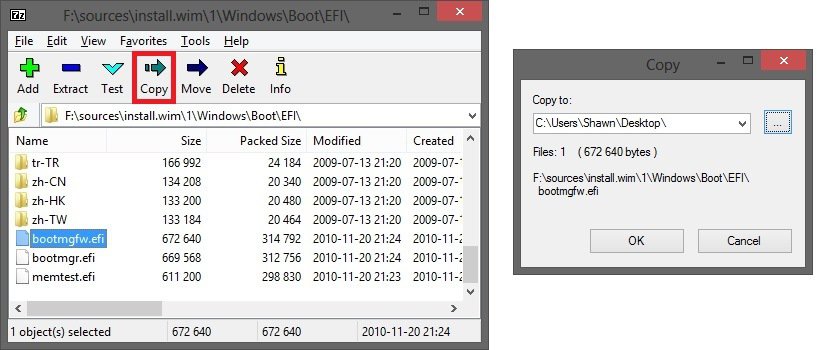

C) In 7-Zip, navigate to the sources\install.wim\1\Windows\Boot\EFI\bootmgfw.efi on the USB flash drive, select the bootmgfw.efi file, copy it to your desktop, click/tap on OK, and close 7-Zip. (see screenshot below)
D) Rename the bootmgfw.efi file on your desktop to bootx64.efi.
E) Copy/Move the renamed bootx64.efi file into the efi/boot folder (step 11A) on the USB flash drive.
F) Go to step 12 below.

In step 11A,
copy the efi\microsoft\boot folder up one level into the efi folder as efi\boot
Do I do a copy or a cut?

You would copy it. :)
Hi, Brink. Thanks very much. I successfully created a Windows 7 64-bit UEFI bootable flash drive, and I'll try it in a few days. This is yet another great source of info, just as SevenForums is. I love it here. :thumb:

B) Having the free program 7-Zip installed, right click on the sources\install.wim file on the USB, and click/tap on 7-Zip and Open archive. (see screenshot below)​
C) In 7-Zip, navigate to and "Copy" the sources\install.wim\1\Windows\Boot\EFI\bootmgfw.egifile to your desktop, and close 7-Zip. (see screenshot below)​
D) Rename the bootmgfw.egi file on your desktop to bootx64.efi.
E) Copy/Move the renamed bootx64.efi file into the efi/boot folder (step 11A) on the USB.​
For my iso, I was unable to open '/sources/install.wim', but I found bootmgfw.efi at '/sources/boot.wim'.

Sorry, but posting the file is not allowed as it will violate Microsoft's distribution of copyrighted material policy.
Are you able to use "Extract Files" to extract the install.wim to a new folder on your desktop instead at step 11B, then proceed from there to get the bootmgfw.egi file?
It'll take a while to finish extracting though.
