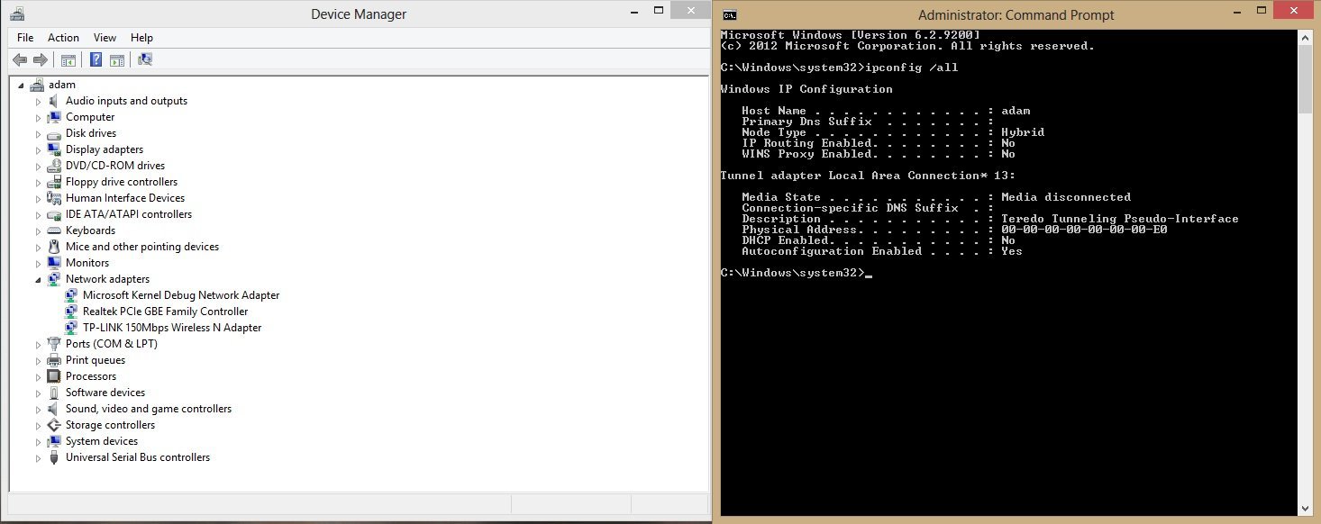

Could you please follow this tutorial and post back your ipconfig of the machine (when connected but with the yellow warning sign) - http://www.eightforums.com/network-sharing/26581-network-posting-tips.html
Also are you able to upload a screenshot of your device manager so that we can see what device drivers you have installed since some can conflict with each other

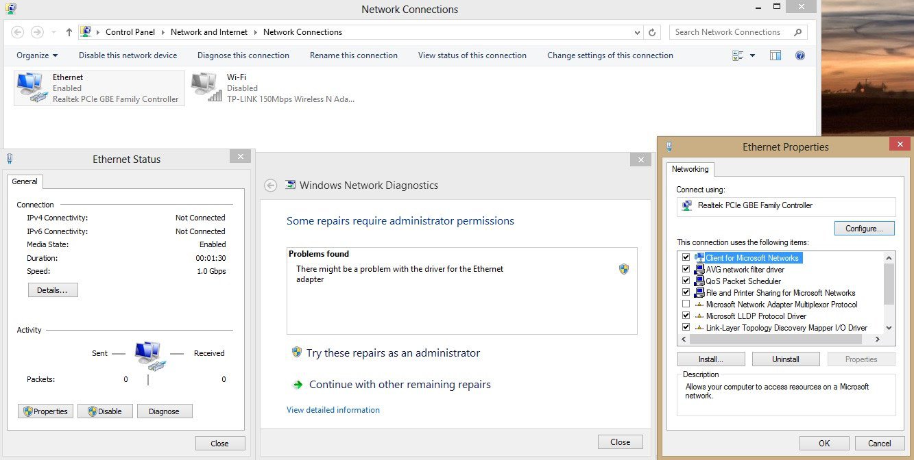

here is a picture of my ipconfig and device manager
ive tried everything i can think of but nothing seems to make it work.
just tried connecting wireless and it picks the signal up and connects but still no internet and still has the yellow triangle
Your device manager looks fine however your ipconfig shows that you are currently not connected to anything at all. Please attempt to connect to the internet and once the yellow triangle appears re do the ipconfig screenshot

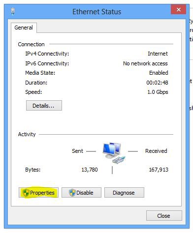

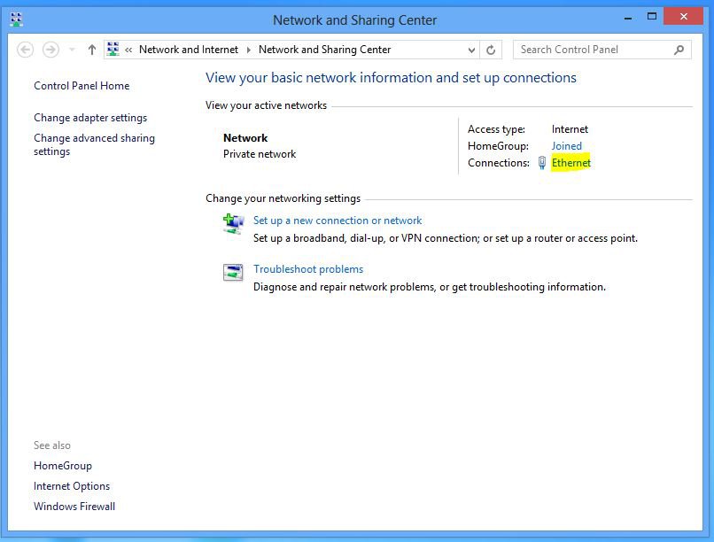

On the Windows 8 machine could you right click you network icon in the system tray next to your time and then click on Networking and Sharing Center. Open that up and should give a control panel windows similar to mine:

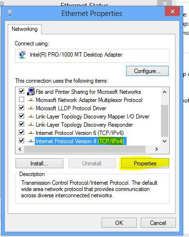

With the local connection connected click on ethernet then go to properties

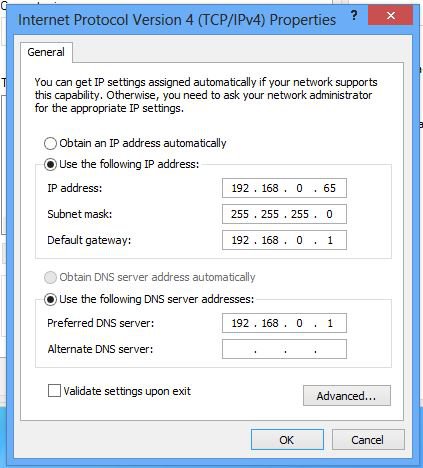

Then search for TCP/IPv4 and then click on properties. You should be presented with a similar windows similar to the one below. As a test could you enter exactly what you see in the image:
Upon completion please click OK and then close all other Windows. Does this resolve your issue?
Josh
ive tried inputting all the same details as you said but still nothing

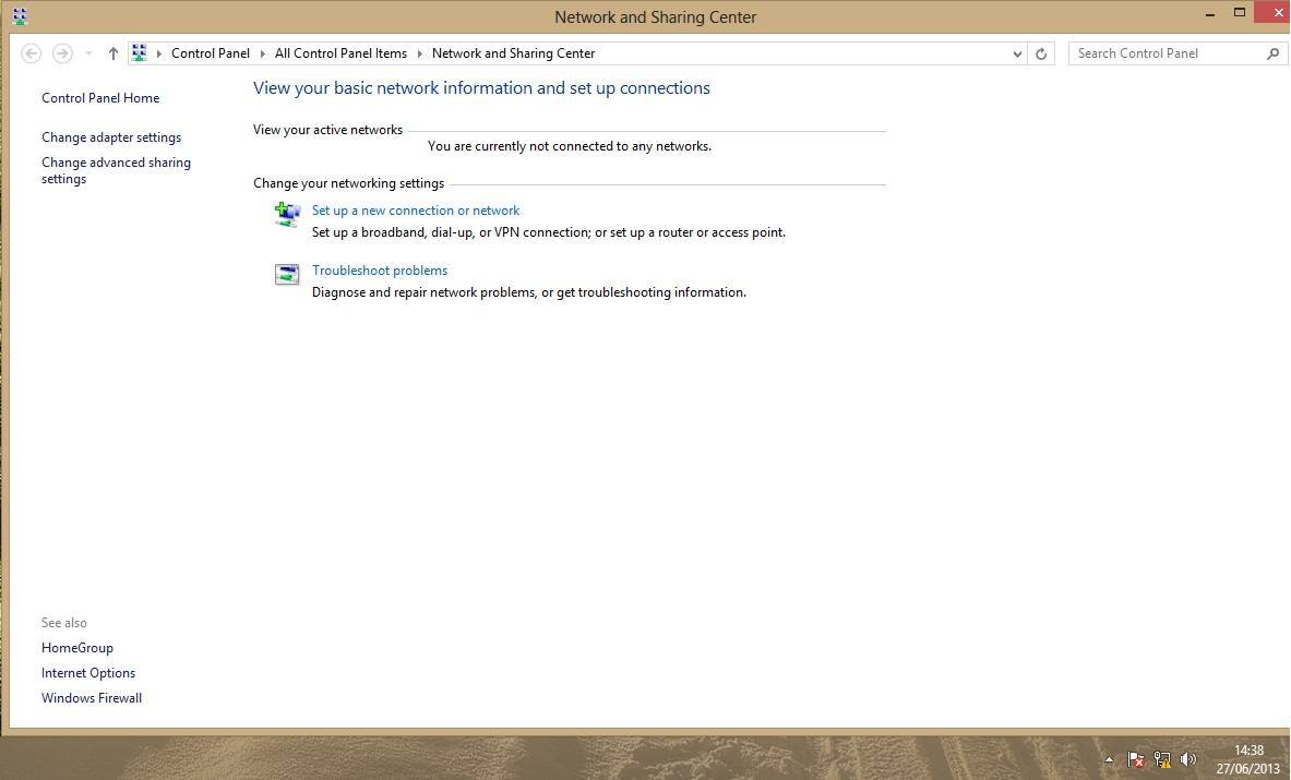

when i first click on network and sharing center i only get this tho
Could you click on change Adapter settings on the left hand pane and then upload a screenshot
