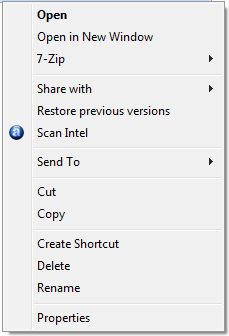

EXAMPLE: "Turn Off Display" added to Desktop Context Menu
