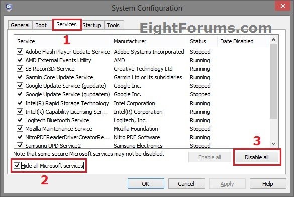

3. Click/tap on the Services tab, check the Hide all Microsoft services box, and click/tap on Disable all button. (see screenshot below)​

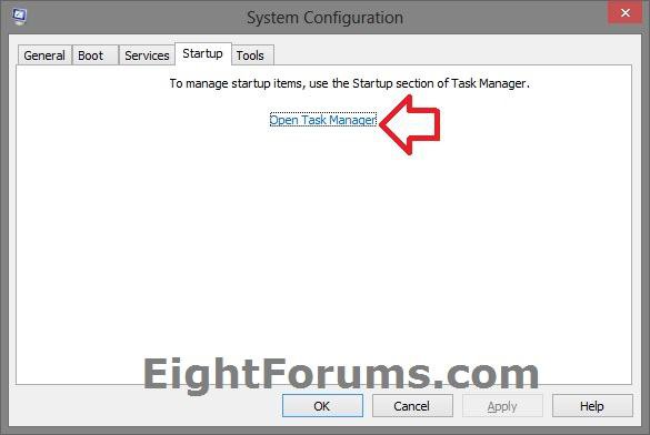

4. Click/tap on the Startup tab, and click/tap on Open Task Manager. (see screenshot below)​
NOTE: Do not close this System Configuration (msconfig) window yet. You need to wait until you get to step 7 below.​

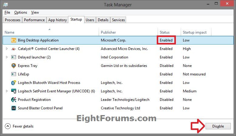

5. In the Startup tab of Task Manager, select all "enabled" startup programs one at a time, and click/tap on Disable for each one. Repeat this step until all startup programs are disabled. (see screenshot below)​

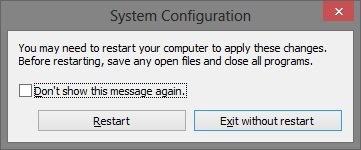

8. Click/tap on Restart to restart the computer and start Windows 8 in a clean boot. (see screenshot below)​

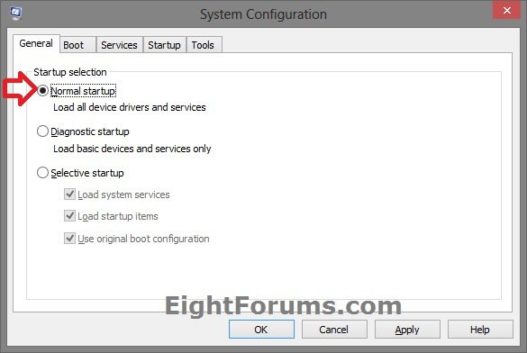

3. Click/tap on the General tab, select (dot) Normal Startup. (see screenshot below)​

In Part 3 step 4, would you want to enable "all" tasks, or just the ones that were already enabled when you started in Part 1, step 5 (i.e. would you leave "Express Tray" and "Product Registration" disabled)?

Hello,
You would want to:
Part 3 step 4. Click/tap on the Services tab, uncheck the Hide all Microsoft services box, and click/tap on Enable all button.
For Part 1, step 5, you are basically just disabling all currently enabled startup programs.
