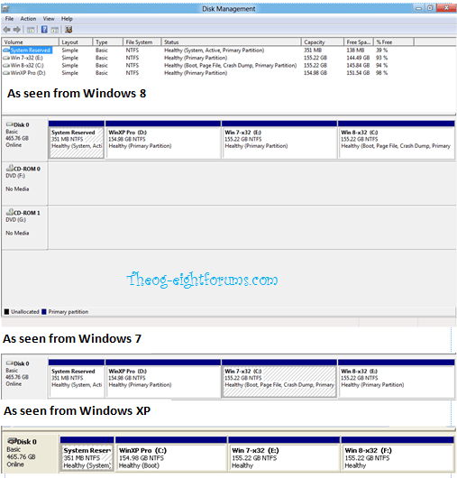

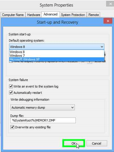

This is not recommended.
1) Install Windows XP.
2) Install Windows 7.
3) Install Windows 8.
theog, I don't understand. Why is this not recommended?? What you posted above is almost identical to one of my systems.
The only difference is my system is:
C = Windows XP (Drive 1)
D = Windows 7 (Drive 2 (Partition 1))
E = Windows 7 (Drive 2 (Partition 2))
Now for me to install Win8 I will or want to Upgrade Windows 7 on Drive E to Windows 8. This is why I'm asking if it will work, I really don't want to lose the XP or other Win7 installation.
Note: I will be using Windows 8 Pro NOT the Windows 8 Pro Pack to do this.

Okay, I spent a few days "experimenting" on another system before I did the upgrade.
The only problem I had was when I installed XP then Win7 and then the second installation of Win7. After the first copy of Win7 was installed the added a second copy, my computer would only boot into WinXp or the second copy of Win7... So I didn't bother trying to fix it, I just again reinstalled everything.
On my second attempt, everything installed as it should, si the system had WinXP, Win7, Win7...
Then when I installed Win8 Pro, it went off without a hitch.... The system then showed WinXP, Win7, Win8..
After playing with that for a few days, and having no problems, I upgraded one copy of Win7 on my main system. As it is right now, it's running perfect. I thought I'd need to use something like EasyBCD but discovered it wasn't needed.
The boot screen now shows:
Windows 7
Windows XP
and again all 3 copies (versions) of Windows stayed intact and run very smoothly.
