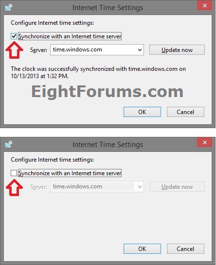

ok I turned off the auto sync in all 3 installs and tried the sync on win 8.1 and no soap .. I previously mentioned that I totally uninstalled the mcafee and that did not help .. also I connected with a simple dial up modem with the cable modem disconnected and tried to sync .. that di not work is it possible that here is acommunication problem between the bios and the os.. the bios is a common base for all os .. I upgraded the bios a few months ago and I can't honestly say the last time I looked at the sync function and recognized it as working . .. But, I am sure that it previously rmember that it did work but not when .. I am not sure it has worked since I installed win 8 . I bot the disk for win 8 and installed it may 2013 and added win 8.1 and media center on april 2014 that was the time I started to use win 8 regularly .. I gradually got the start menu and other features pretty close to win 7 and have not used win 7 very much since then .. I did have couple programs that I used in win 7 but have gotten work arounds , so I could dump the win 7 os's ..But since they are not eating any hay . I keep them for spare tires .. Where is Einstein when you need him .. Remember whebn I was working for a living .. we would get these unsolvable rpoblems in the plant and some bur headed techie would come in and say did you try x on x off .. again thanks for your hand ,, john

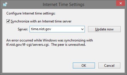

Ok. Try one of the default time servers. The time.nist.gov server works good for me, and I'm from the same location as you. You may need to click on the Update now button more than once if it doesn't sync the first time.
When I try the tf.nist.gov/tf-cgi/servers.cgi server like in your screenshot, I get the same error.

I tried it about 10 times on the win8.1 os usig the nist.gov site .. most times I GOT THE TIMED OUT NOTICE AND ONCE I GOT THE PEER IS UNREACHABLE .. time.windows produced the timed out note ..
Another clsed door tested ..
