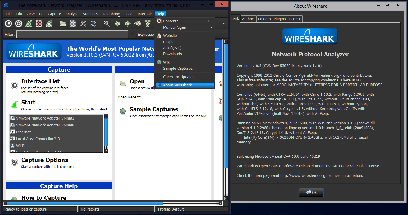

And another one on the list: Wireshark for Windows
Thank you Wikipedia,
But Abiword doesn't seem to do it... I'm missing some files here...
But wait,
Wireshark 64bit does run with the same theme too:
:cool:
Again, I just copy the needed theme dll from gimp's directory.

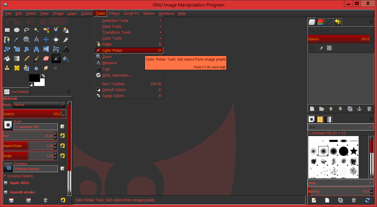

Well, since I've upgraded to GIMP 2.8.10 x64 Partha's version* (Partha's Place) I needed to add the themes to: Gimp-2.8\share\gimp\2.0\themes otherwise the manual method wouldn't work.
But it works this way. :)
@lehnerus2000, using the preferences menu is the proper way to do it. :thumb:
*has more plugins installed
Moving all my plugins wasn't so easy, but was worth it.
Extra engines and binaries are also placed in 'frameworks' instead of 'bin' and in 'frameworks\lib\gtk-2.0\2.10.0\engines' instead of 'lib\gtk-2.0\2.10.0\engines' respectively.
By the way, with all the extra engines loaded, you're free to create and try new themes based on your favorite engine, for instance another one of mine running on Crux like:
Crux-Daybreak theme
:cool:
Cheers!

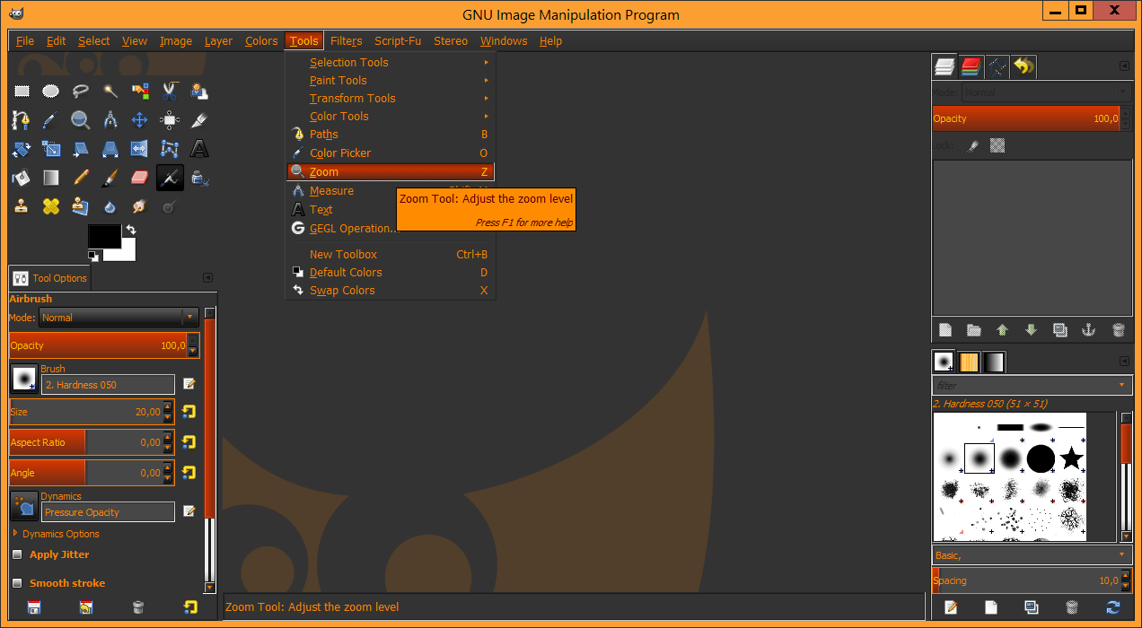

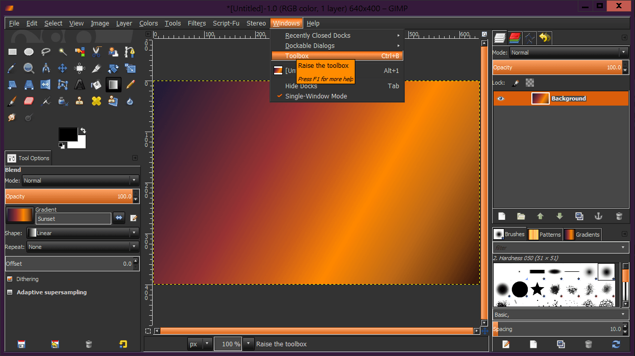

Playing with the color intensity and brightness gave IMHO even better results.
Crux-Daybreak:
Crux-Red:
White text isn't always a must. :D
Cheers!

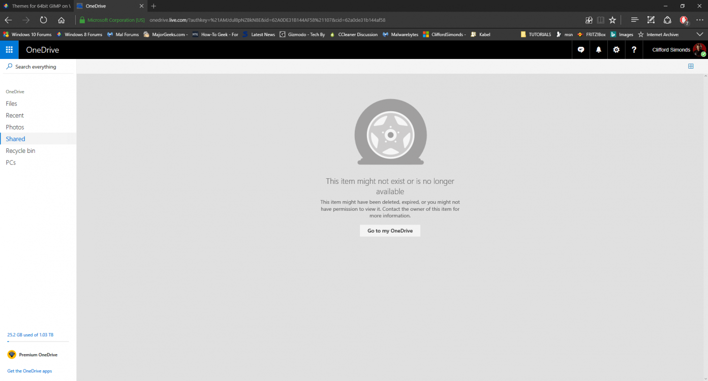

Hey Horace, I think Falcon might mean the 64bit link in post #1:
But for 64bit we don't have this but still, we can have themes and can those are to be selected manually.
The most complete 64bit GIMP (v. 2.8.10) I have is here: link.<-This one
I hope the link works since that GIMP is already themed and has some useful extra plugins included.
To add themes to your own GIMP install (64bit) you will need to place some files in a few folders:
..\GIMP-2.8\lib\gtk-2.0\2.10.0\engines (here you add the theme engines: dll's found in previous links)
and
..\GIMP-2.8\share\themes (here you need the theme settings files, get them from here or the first two links)
Regarding the already-themed GIMP:
You can extract the zip and use the program. Placing it in Program Files means the same as installing (except you don't have context menu option only if you install the program first and then replace all files with the ones provided here.
I get this when I click it too:

Thanks Cliff!
My bad, that link was dead for quite some time now. :eek:
Just in case, I've updated the version to my x64-only 2.8.14 themed pack, all from previous version, and more, is included.
Skydrive link fixed.
Cheers!
