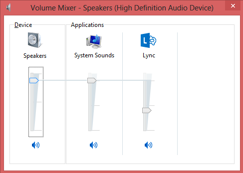

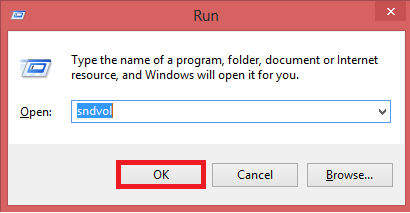

There is a way to check what application is using your sound card by using the volume control application.
if you press these keys together:
:winkey: + R (this will bring up a run box)
Enter snvdol > then click OK
this application will then show you what application is running and presently using you sound card : for example:
Hope that helps,
Cheers,
Harry

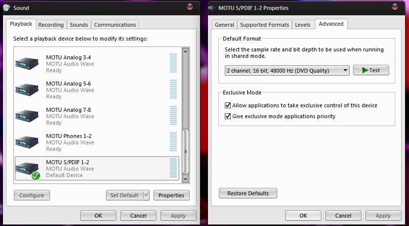

Hey dude. That's my specialty.
You gotta check the box to allow applications to take exclusive control in Playback tab | Double click adapter | Advanced
You should also disable Windows sounds if you're doing any kind of serious recording at all. It's not necessary, but it's how you do.
Also check options in ProTools about it. I don't actually need the above setting when I use Cubase. I could have a million things going at once if I need or want, but of course, your interface is different. Mine is MOTU Traveler. (It's all about the driver too, and MOTU is top of the line.)

I tried it out (amongst all other possible settings combinations!) but still nada. By the way, when I checked in sndvol, it did display the "system sounds" even though I disabled windows sounds, as you suggested.
