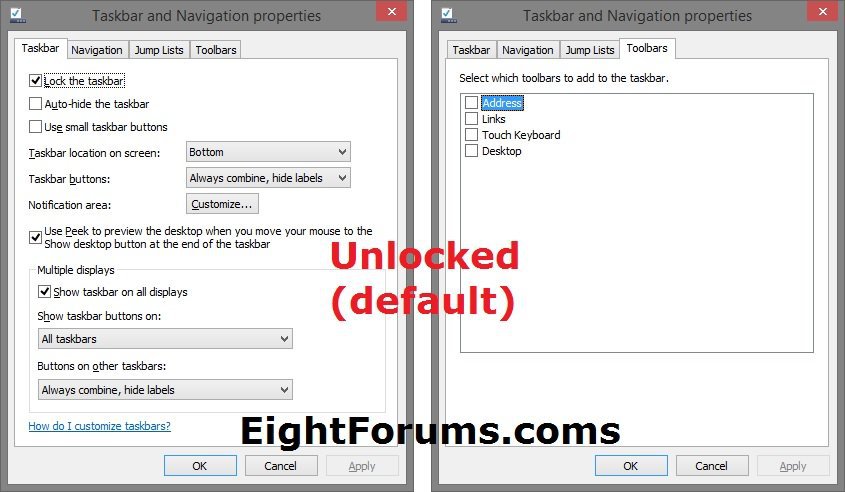

This tutorial will show you how to lock or unlock taskbar settings such as being able to resize or move (arrange) toolbars on taskbar, lock or unlock taskbar(s), and open Taskbar and Toolbars tabs in "Taskbar and Navigation properties" for specific or all users in Windows 8, Windows RT, Windows 8.1, and Windows RT 8.1.
EXAMPLE: Taskbar and Navigation properties

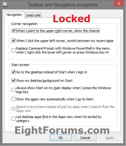

NOTE: If locked, users will only be able to open "Taskbar and Navigation properties" to set Navigation and Jump Lists settings from the Control Panel (icons view) -> Taskbar since the option to do so from the taskbar will be grayed out.

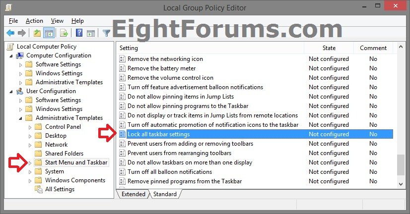

Lock or Unlock Taskbar Settings in Group Policy
NOTE: This option for using group policy is only available in the Windows 8/8.1 Pro and Windows 8/8.1 Enterprise editions.
2. In the left pane, click/tap on to expand User Configuration, Administrative Templates, and Start Menu and Taskbar. (see screenshot below)
3. In the right pane of Start Menu and Taskbar, double click/tap on Lock all taskbar settings to edit it. (see screenshot above)

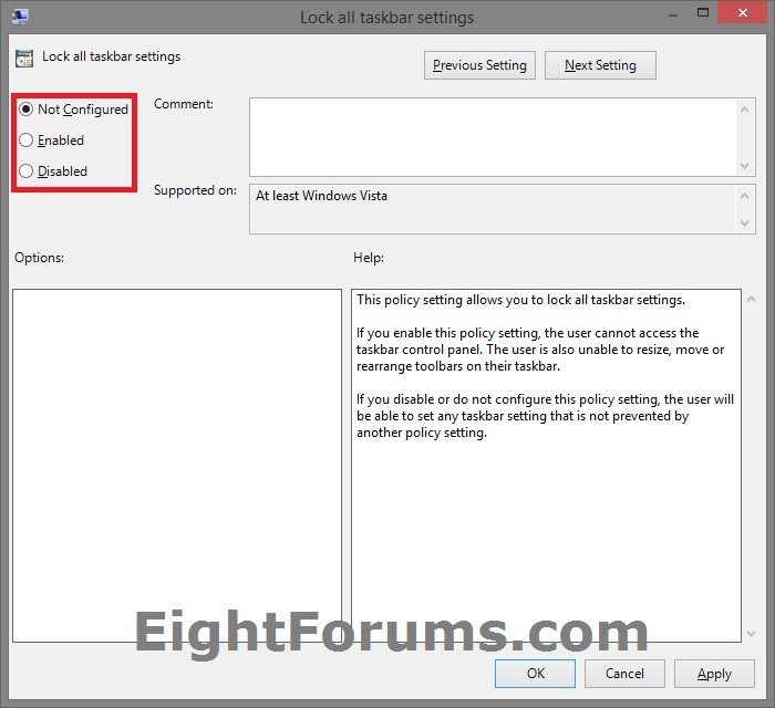

5. To Unlock Taskbar Settings
A) Select (dot) Disabled or Not Configured, click/tap on OK, and go to step 7 below. (see screenshots below step 7A)
6. To Lock Taskbar Settings
A) Select (dot) Enabled, click/tap on OK, and go to step 7 below. (see screenshot below)
7. Restart explorer, sign out and sign in, or restart the PC to fully apply.
