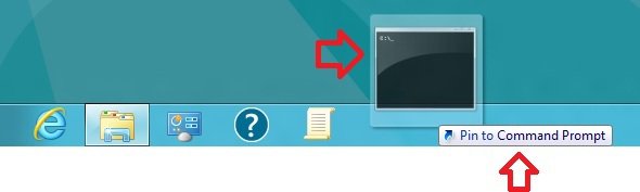

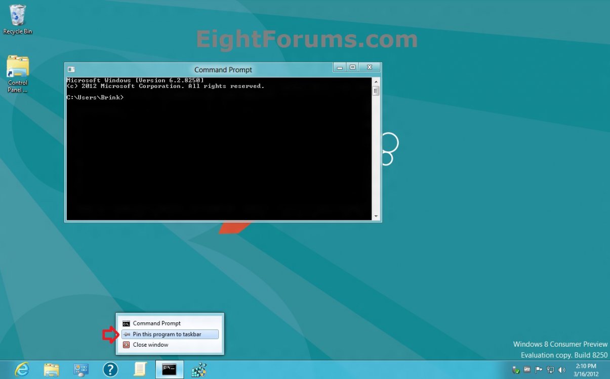

2. To Pin an App to the Taskbar
A) Drag a .exe file or shortcut of an .exe file to the taskbar until you see the Pin to (app name) pop-up, then drop the app on the taskbar. (see screenshots below)​
OR
B) While you have the app (ex: CMD) open, right click or press and hold on it's icon on the taskbar, and click/tap on Pin this program to the taskbar. (see screenshot below)​

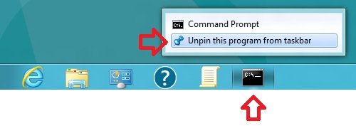

3. To Unpin an App from the Taskbar
A) Right click or press and hold on a pinned app's icon, and click/tap on Unpin this program from the Taskbar. (see screenshots below)​

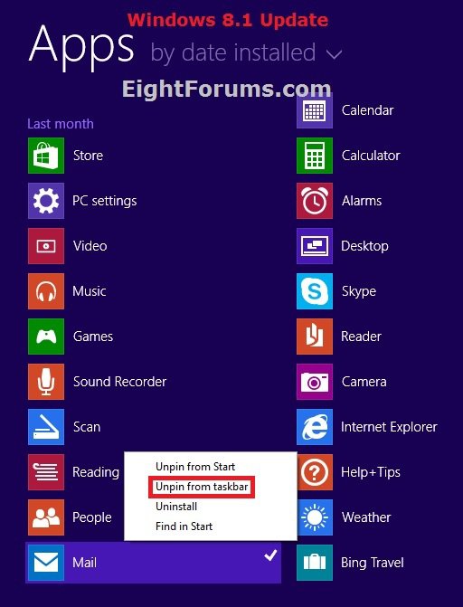

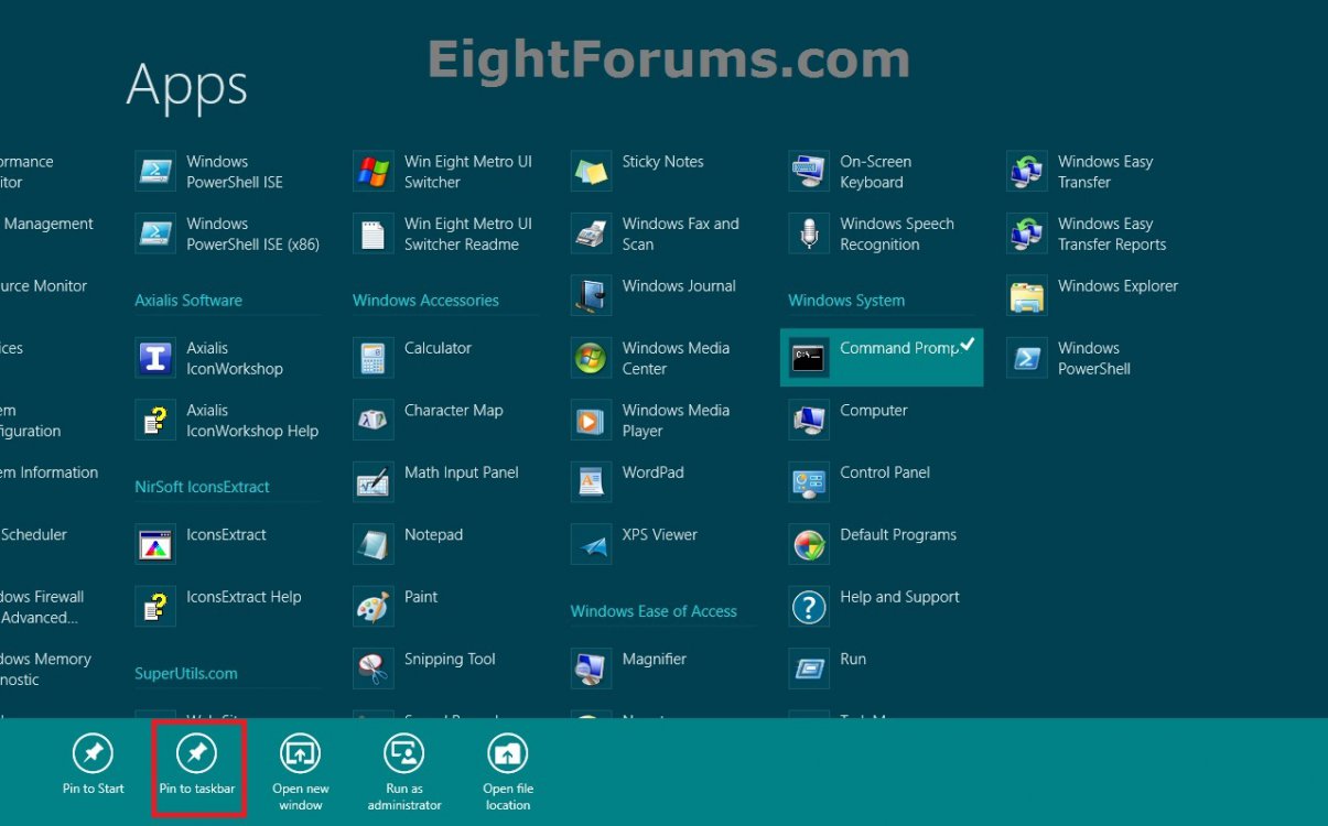

To Pin or Unpin Apps on Taskbar from the "Apps" Screen
1. Open the Apps screen, and do step 2 or 3 below for what you would like to do.​
2. To Pin a App to Taskbar

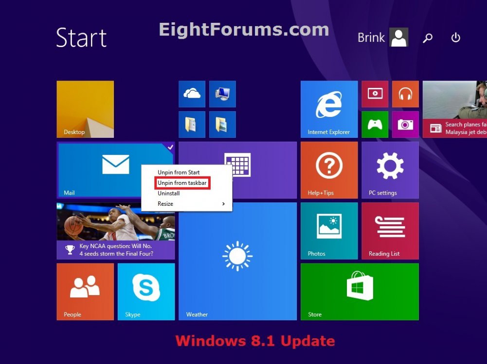

A) Right click or press and hold on a listed app that you would like to pin to the taskbar to select (check it), then click/tap on Pin to taskbar in the bottom application bar or context menu. (see screenshots below)​

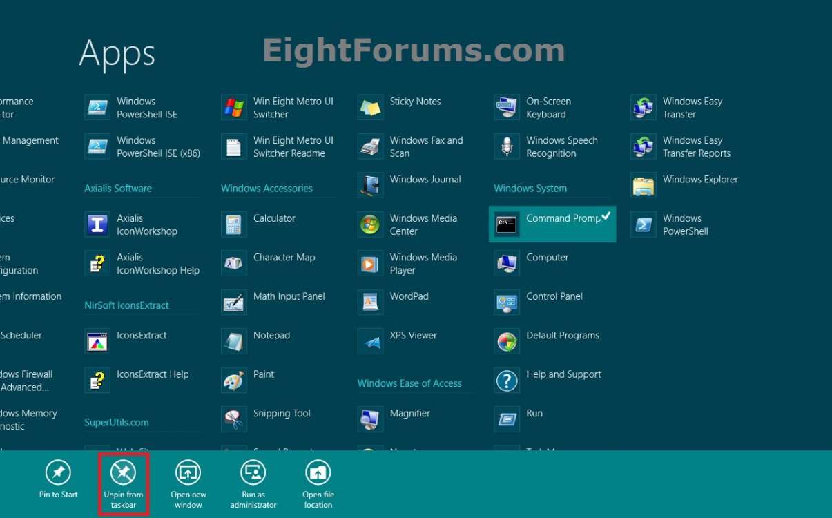

3. To Unpin an App from Taskbar
A) Right click or press and hold on a listed app that you would like to unpin from the taskbar to select (check it), then click/tap on Unpin from taskbar in the bottom application bar or context menu. (see screenshots below)​

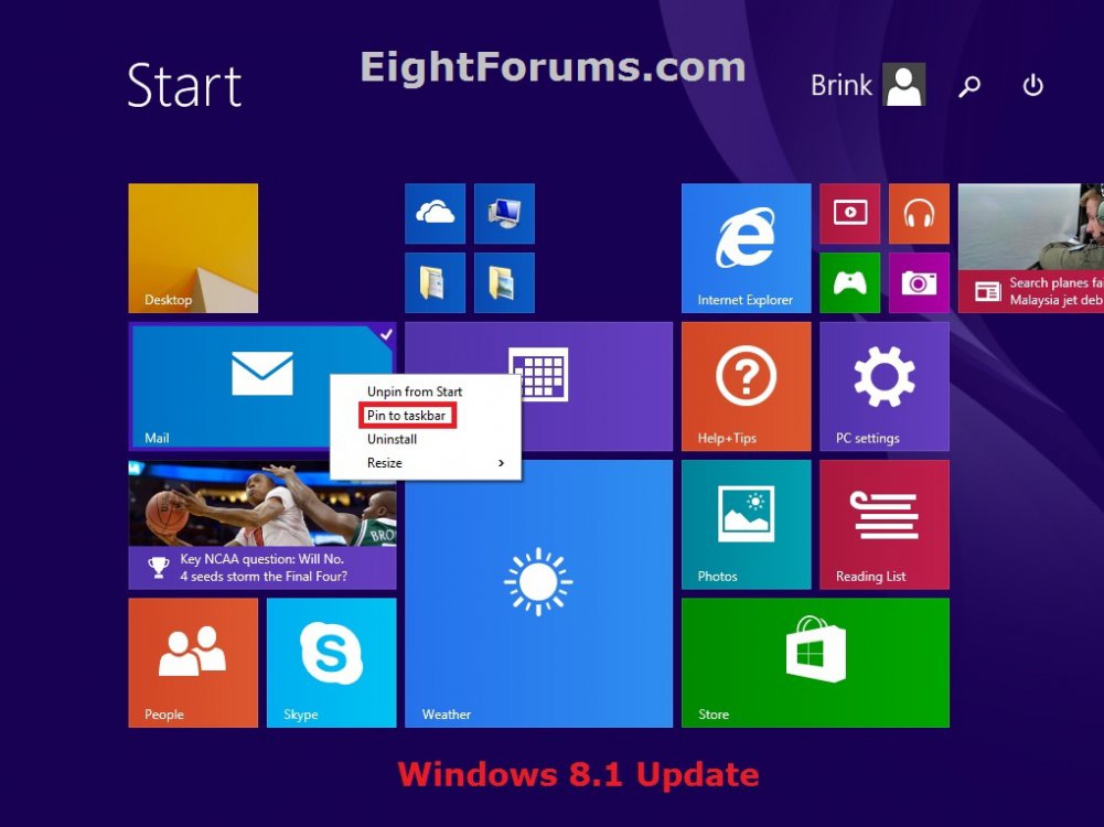

To Pin or Unpin Apps on Taskbar from the "Start" Screen
1. Go to the Start screen, and do step 2 or 3 below for what you would like to do.​
NOTE: You could press the Windows key to go to the "Start" screen.​

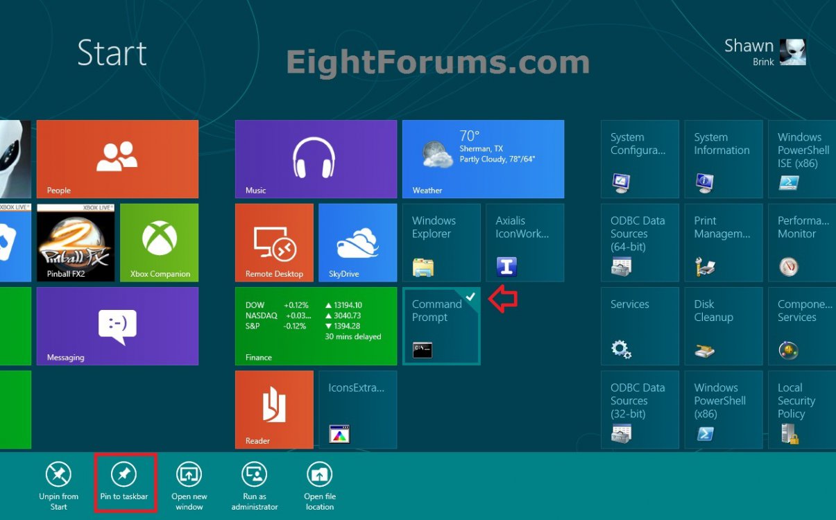

2. To Pin an App to Taskbar
A) Right click or press and hold on an app already pinned to Start that you would like to pin to the taskbar to select (check it), then click/tap on Pin to taskbar in the bottom application bar or context menu. (see screenshots below)​
A) Right click or press and hold on an app already pinned to Start that you would like to unpin from the taskbar to select (check it), then click/tap on Unpin from taskbar in the bottom application bar or context menu. (see screenshots below)​

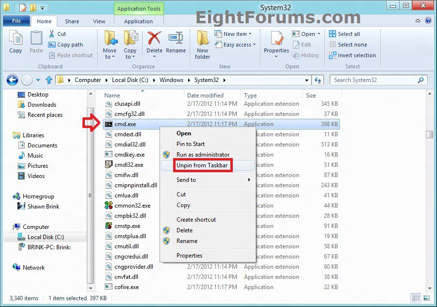

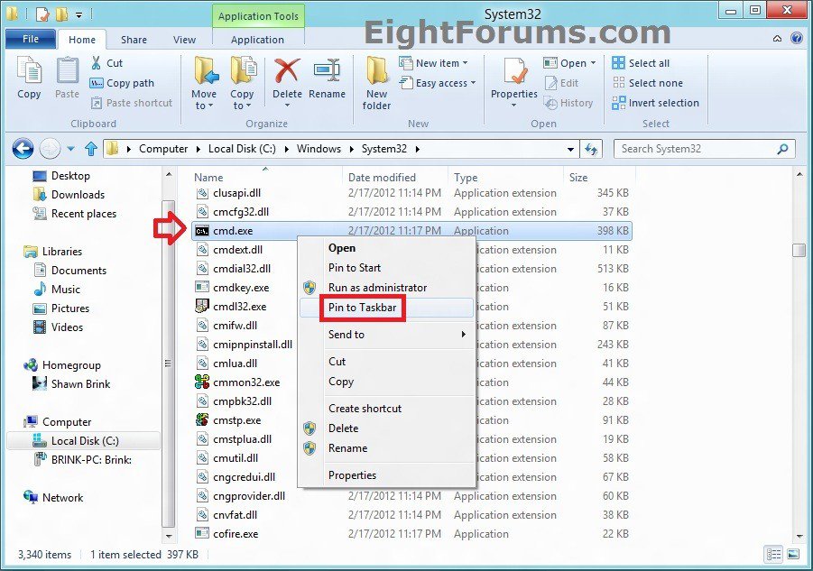

OPTION FOUR
To Pin or Unpin Apps on Taskbar from Windows Explorer
1. Open Windows Explorer, and do step 2 or 3 below for what you would like to do.​
NOTE: You could press the Windows + E keys to open Windows Explorer.​
A) Navigate to the .exe file or shortcut of an .exe file that you would like to pin to the taskbar, right click or press and hold on it, and click/tap on Pin to taskbar. (see screenshot below)​
A) Navigate to the .exe file or shortcut of an .exe file that you would like to unpin from the taskbar, right click or press and hold on it, and click/tap on Unpin from taskbar. (see screenshot below)​

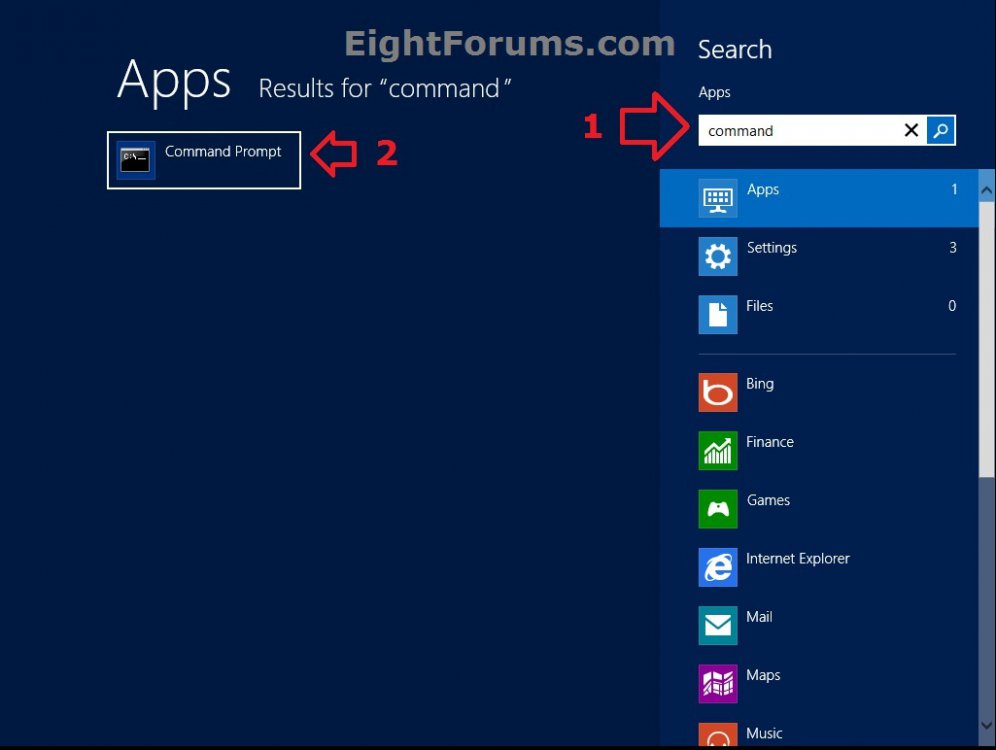

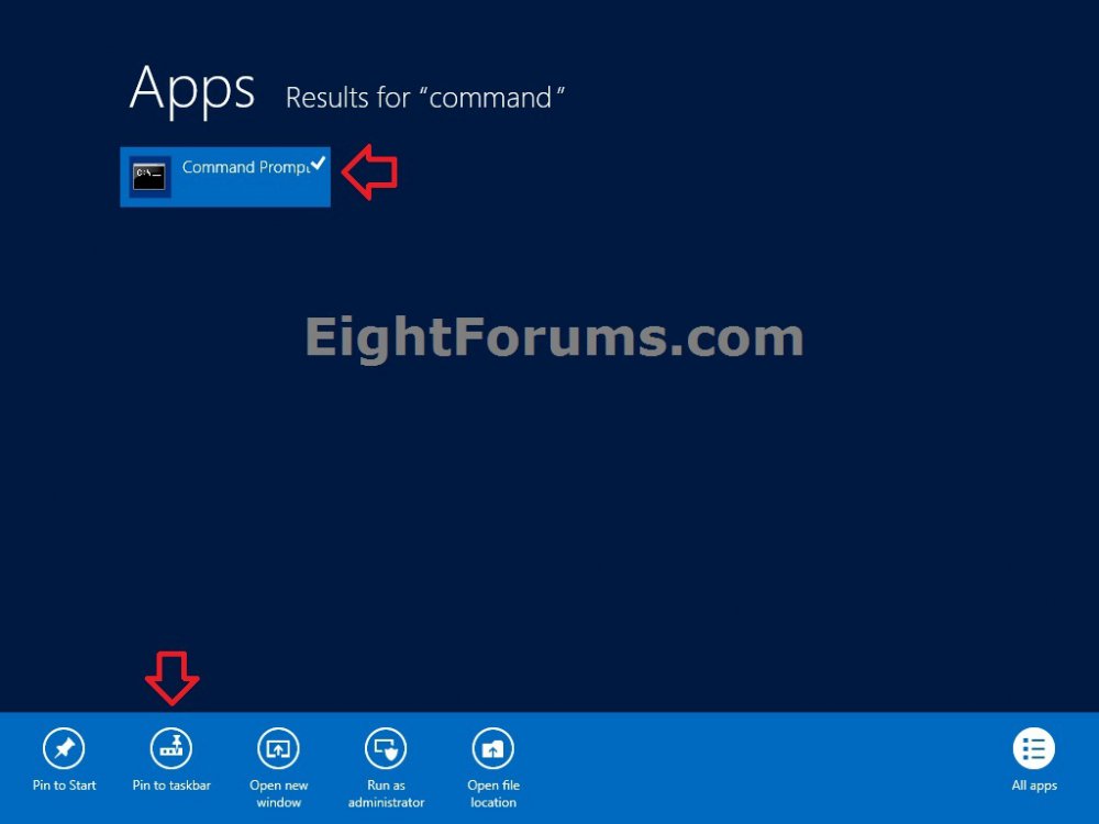

To Pin or Unpin Apps on Taskbar from "Search" Apps
1. Start a Search for the name of the app you want to pin or unpin from the taskbar. (see screenshot below)​
NOTE: For example, by just start typing the name of the app while on the Start or Apps screen.​
2. Right click or press and hold on the app in the search results, and do step 3 or 4 below for what you would like to do. (see screenshots below)​
3. To Pin an App to Taskbar
A) Click/tap on Pin to taskbar in the bottom application bar. (see screenshot below)​
4. To Unpin an App from Taskbar
A) Click/tap on Unpin from taskbar in the bottom application bar. (see screenshot below)​

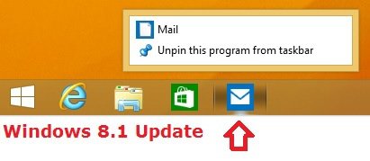

Tutorial updated for Windows 8.1 Update to be released on April 8th 2014 via Windows Update, you will now be able to Pin to Taskbar modern apps.
Using Win8.1 Update... and I can pin various Modern apps, like Mail, Stocks, Photos to the Taskbar... but when I pin Weather to the Taskbar, there is no icon... it simply pins a blank rectangle and I didn't notice this at first until I stumbled on it later. Does this happen to anyone else? Any idea on how to fix?
Hello RpD, and welcome to Eight Forums.
The Weather app displays it's icon properly for be when pinned to the taskbar.
You might see if uninstalling and reinstalling the Bing Weather app, then pin again may help.
Hope this helps for now, :)
Well... it took two tries.
After uninstalling and reinstalling the Bing Weather app, I had only two options on right-clicking the app in the Modern interface... "Unpin from Start" and "Resize >" ...it no longer offered 'Pin to taskbar' or 'Uninstall' ...even after reboot ...but it worked to show weather. I also downloaded 'The Weather Channel', which did not go to Start, but was shown in All Apps and offered "Pin to Start" and "Pin to taskbar" and "Uninstall". So I went back to the Store and back to the Bing Weather app... which said it was available to install. So I hit Install, and it installed -again-... and now it has all the normal right-click options, still has all my locations, and, shows an icon when pinned to the Taskbar.
