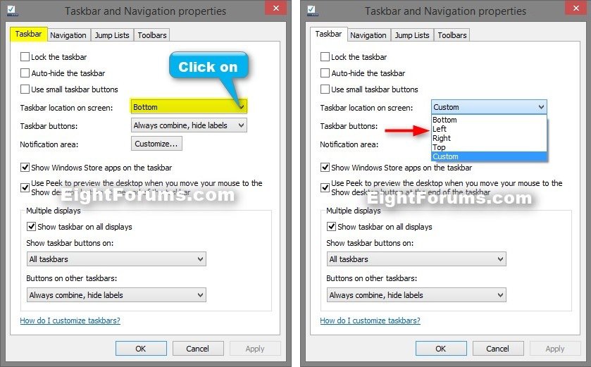

1. Do step 2 or 3 below for how you would like to open "Taskbar and Navigation Properties".​
2. Open the Control Panel (icons view), click/tap on the Taskbar and Navigation icon, and go to step 4 below.​
3. Right click or press and hold on the taskbar, click/tap on Properties, and go to step 4 below. (see screenshot below)​
4. Click/tap on the Taskbar location on screen drop down menu, click/tap on Bottom, Left, Right, or Top, and click/tap on OK. (see screenshots below)​
If you see a Custom option, then it means that you have multiple displays set to show taskbar on all displays, and at least one of the taskbars currently has a different location than the other taskbars.
