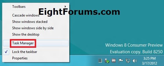

4. While on the desktop, right click on the taskbar, click/tap on Task Manager, and go to step 7 below. (see screenshot below)

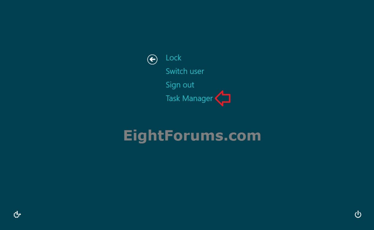

5. Press the CTRL+ALT+DELETE keys, click on Task Manager, and go to step 7 below. (see screenshot below)

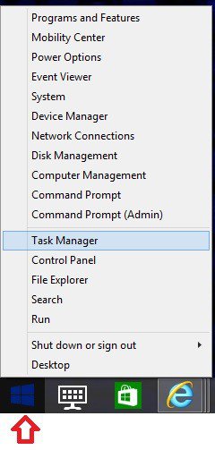

6. Open the WIN+X Power Users menu, click/tap on Task Manager, and go to step 7 below. (see screenshot below)

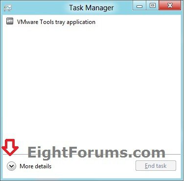

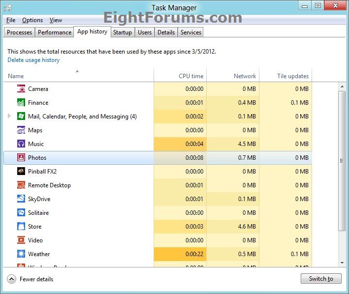

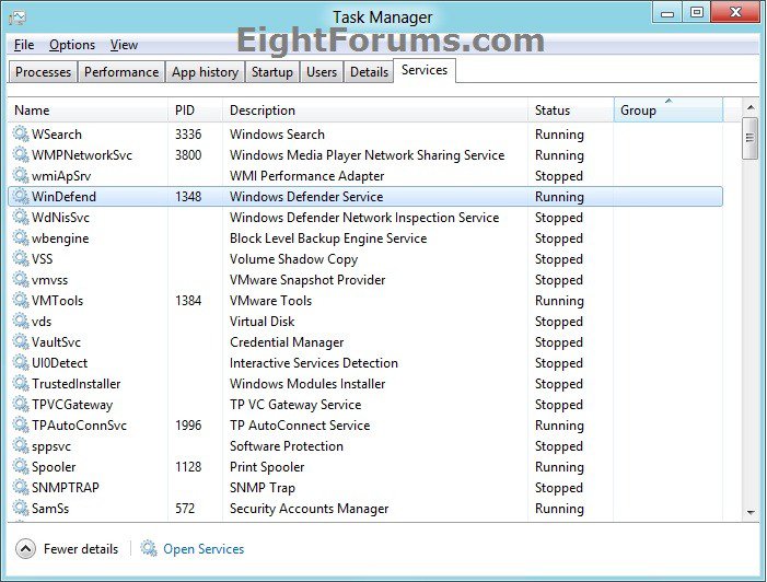

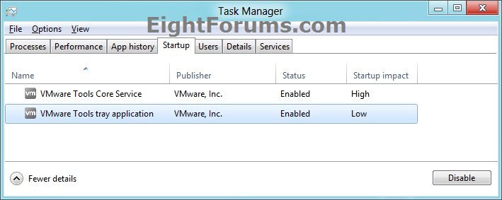

8. Select to have Task Manager in Fewer details or More details view. (see screenshot below)
NOTE: Task Manager will open to the same Fewer details or More details view it was last closed as.

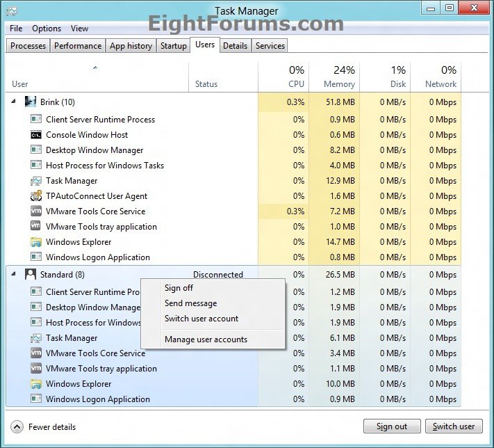

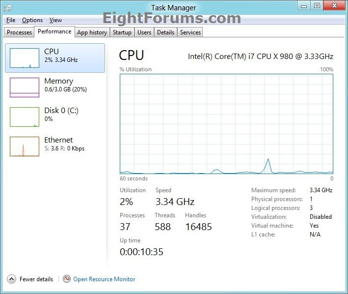

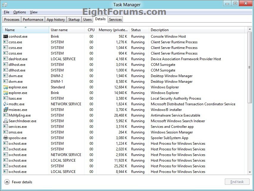

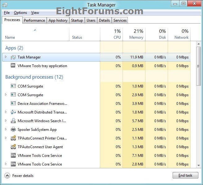

9. Here is what you will see in the new More details view of Windows 8 Task Manager. (see screenshots below)
In the Performance tab below, you can also double click/tap on the left or right side to switch to summary view. To return to normal view, just double click/tap anywhere in the small footprint mode window.

Sure, you could, but it's already on the right click context menu of the taskbar.
