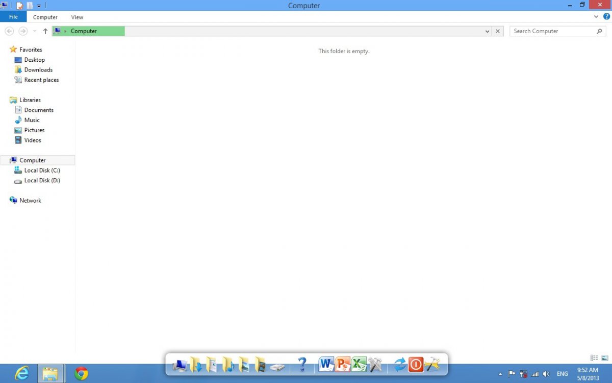

I'm using Windows 8 Pro N with 32-bit. I found some problem SOMETIME whenever I tried to open My Computer, it takes a very long time to show up my drives and removable disks.
Here's the screenshot of it. The Green Bars is moving damn slow, For sometime only. Besides, I also encountered problem when the folder is not responding, where can I end the task? Just like in Windows 7, I can simply end the task using task manager.
Any guides to my problem? thanks!

Thanks for your info. As the statement said that it will work on internal HDD but not SSD. I'm working on SSD now.
the issue can occur this way, after I browse website or do something else for sometime, the moment when I go to My Computer, it can delay for a long time( doesn't happen frequently). I have to restart my laptop and it will respond normally.

Shawn, the problem still persisted even tough the removable devices are not there.

Hi Arachnaut, thanks for your help by pointing the issue of the ATHI2013, I finally solve the problem by installing the latest version, things work fine now, thanks!
Hi Brink, the problem has been solved due to my software issue, thanks anyway for your guides and help, I really appreciate that! Thanks!
