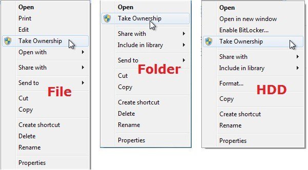

This tutorial will show you how to add Take Ownership to the context menu of all files, folders, and drives for all users in Windows 8.
This will allow you to be able to instantly take ownership of a file, folder (and all contents), or drive (and all contents) by changing the owner to the current user and grant the Owner_Rights SID (current owner) full access permission.

EXAMPLE: Take Ownership in Context Menu

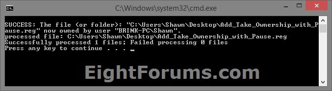

3. To Add "Take Ownership" with Pause to Context Menu
This option pauses the command when you use the "Take Ownership" context menu to be able to see the command results. This can be handy to verify setting ownership and permissions was successful or not.
