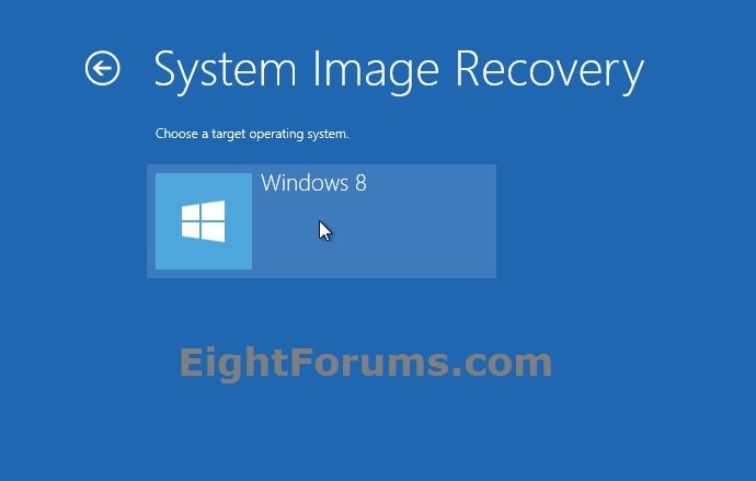

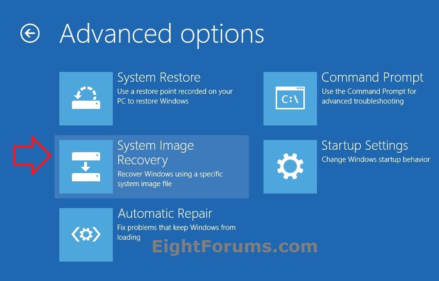

1. Boot to the System Recovery Options screen, and click/tap on the System Image Recovery option. (see screenshot below)
2. If prompted, choose the OS (ex: Windows 8) that you want to do a System Image Recovery with. (see screenshot below)

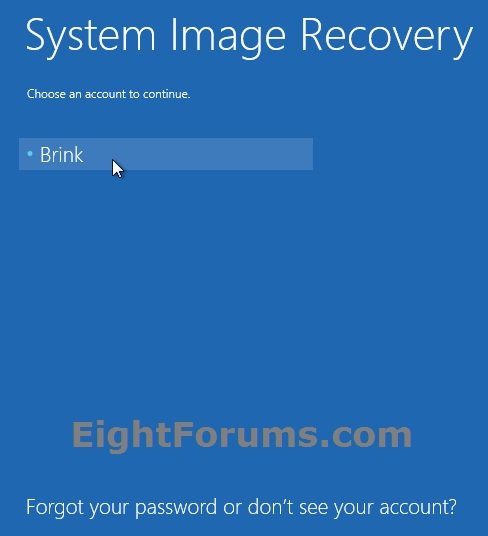

3. If prompted, select and click/tap on an administrator account on the computer that you are doing a system image recovery on. (see screenshot below)

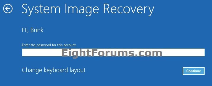

4. Type in the password for the selected administrator account, and click/tap on Continue. (see screenshot below)

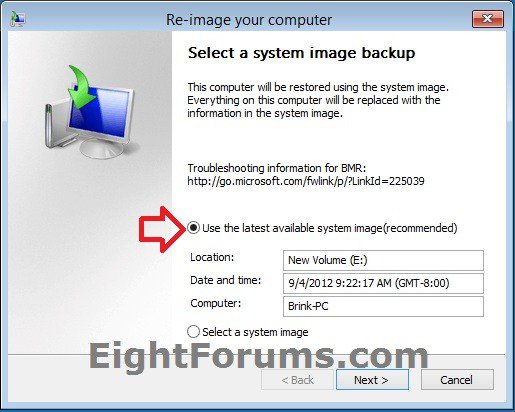

6. To Use the Latest Available System Image
A) Select (dot) Use the latest available system image, click/tap on Next, and go to step 8 below. (see screenshot below)​

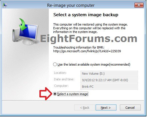

7. To Select to Use Another System Image
A) Select (dot) Select a system image, and click/tap on Next. (see screenshot above)​
NOTE: This is if the system image that you want to use is not listed here, and/or is saved at another location that you wish to choose from instead. If you saved your system image to a set of DVDs instead of a HDD/SSD, then insert the last DVD from the image set first.​

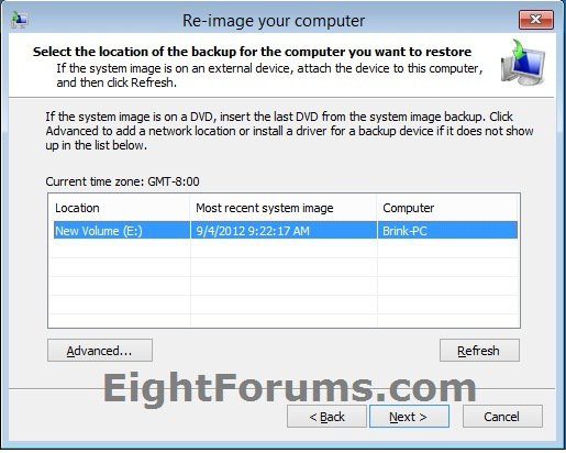

B) Select the location of the system image for the computer that you want to restore, and click/tap on Next. (see screenshots below)​

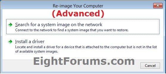

To add a image from a network location, click on the Advanced button, and on the Search for a system image on the network option.
If the drive cannot be seen to select a system image from, then you may need to use the tutorial below to load your SATA or RAID drivers before it will be seen. You would click on the Advanced button, and on the Install a driver option.​

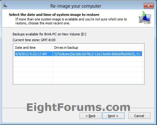

C) Select a system image with the date and time that you want to restore, click/tap on Next, and go to step 8 below. (see screenshot below)​

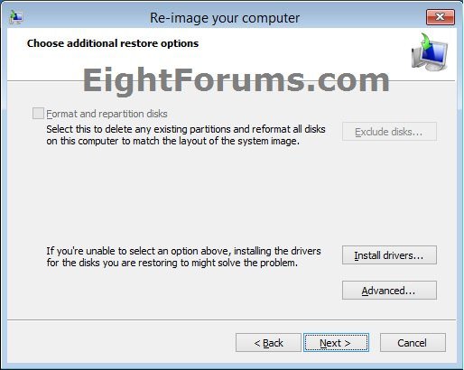

8. Do step 9, 10, or 11 below depending on what options you have and would like to do. (see screenshots below)
Format and repartition disks box:
NOTE: Special thanks to MJF for this addition.​
1) Grayed out and selected
You are forced to have the whole disk formatted and repartitioned to match the partition structure of the disk the image was made from. This can occur when restoring an image to a new disk or the original disk with a modified partition structure. Data on other partitions on the disk you are restoring to will be lost.​
2) Grayed out and unselected
You are not given the option to format and repartition the disk. This will occur if you are restoring Windows from a partition on the same disk.​
3) Not grayed out and unselected
Here you have the option to select format the whole disk and repartition or not. In this case the disk the image was taken from has a matching partition structure to the disk you are restoring the image to. By not selecting the format and repartition option your image will be restored and other partitions untouched such as valuable data partitions.​

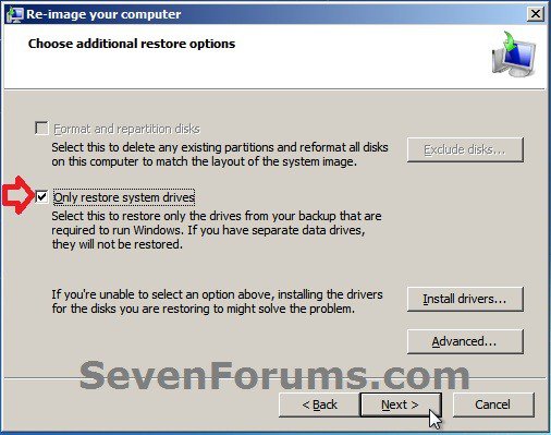

9. To Do a Full System Image Recovery
NOTE:
Use this option if you want to delete any existing partitions and format all disks on this computer to match the layout of what was included in the system image when it was created.
A) Check the Format and repartition disks box (if not grayed out) and uncheck the Only restore system drives box (if available), and click/tap on Next. (see screenshots below step 8)​
B) Go to step 11 or 12 below.​
10. To Only Restore System Drives from System Image
NOTE: Use this option if you want to format and restore only the drives from your system image that are required to run Windows. If the system image included that you moved anything like your page file, user folders, or user profile to another drive location than the default C, then that drive location(s) will also be formated and restored to how it was in the system image. If you have separate data drives, they will not be restored.
A) If an available option, check the Only restore system drives box, click/tap on Next, and go to step 12 below. (see bottom screenshot below 8)​

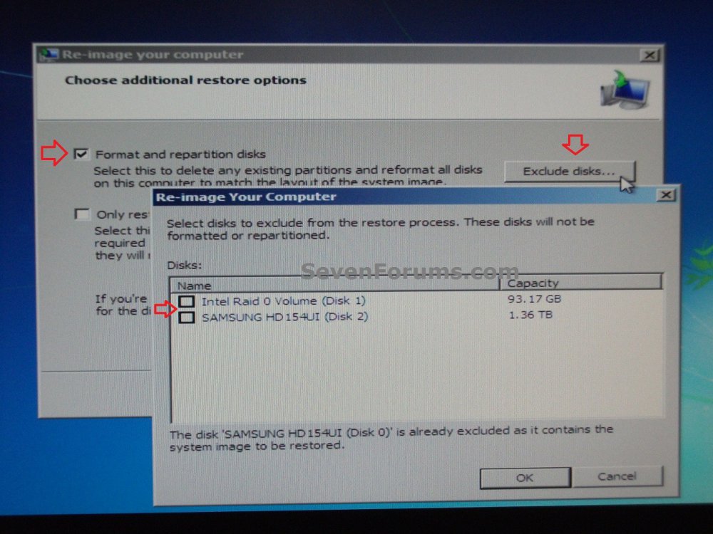

11. To Exclude Restoring Specific Drives when Doing a System Image Recovery
NOTE:
This option will allow you to exclude specific disks from the restore process to make sure that these disks will not be formated or repartitioned.
A) Check the Format and repartition disks box (if not grayed out), and click/tap on the Exclude disks button (if not grayed out). (see screenshots below step 8)​
NOTE: If the Exclude disks button is grayed out, then the HDD that you are restoring to is empty, or you do not have any disks in the system image that are able to be excluded from being restored.
B) Check the disks that you want to exclude from being restored from the system image, and click/tap on OK. (see screenshot below)​
C) Click/tap on Next, and go to step 12 below. (see screenshots below step 8)​

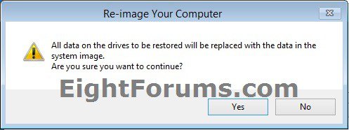

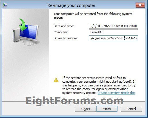

12. When finished selecting what you want to restore from the system image, click/tap on Finish. (see screenshot below)
13. Click/tap on Yes. (see screenshot below)

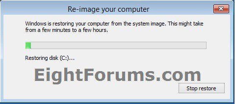

14. You will now see this screenshot below.

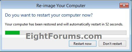

15. When it is finished, click/tap on the Restart now button. (see screenshot below)
NOTE: You will have 60 seconds before the computer restarts automatically.

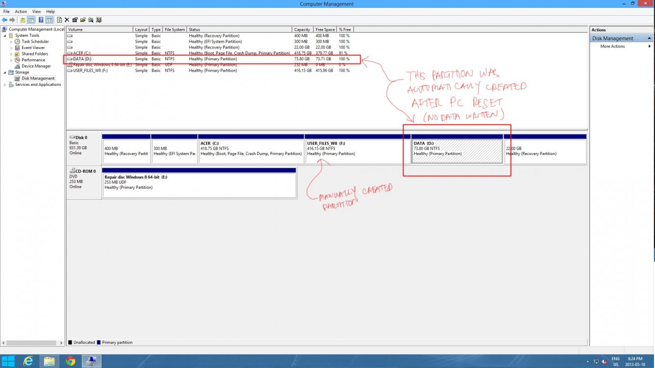

Actually I just have one question Shawn.
After completing the PC reset, I noticed that there is a new partition in the hard drive named "DATA". And when I check the properties, it is 73GB in size but nothing is written on it. Can I just delete that partition?

25,204
Go ahead and post a screenshot showing the full layout of your Disk Management window to see what it says first.
Here it is Shawn:

25,204
Since this was a factory recovery, the Data drive is most likely something Acer uses. Possibly for backups.
Before just deleting the partition, test by removing only the drive letter to make sure that you have no ill effects from it for a few days.
If you do, then you could just add the same drive letter back.
If not, then you should be fine to delete it and extend say F: into it.
