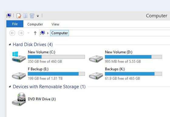

I have a different problem now, though: When I boot into Windows7 and open "My Computer" it looks as it always has, with W7 being on "C" and drive "F" being shown as where W8 is installed -- which is correct (screen shot below)
But when I boot into Windows8 and open "My Computer", it shows itself being the OS on the "C" drive and does not show the drive where Windows 7 is at all:
Each OS is on a seperate physical disk and I know there both there as I can boot to either. How can I get W8 to recognize the "missing Disk?
Philip
OK, I went to disk management it showed, so I assigned the first possible letter available to the "unnamed" disk and it shows up fine in "My Computer" now as Disk "L".
Before I mark this "solved", though, I'd like to ask how much changing and swapping around of disk letters I can do (without getting into trouble, that is...:D)
You're ok - as long as you don't try and change the os letter. I don't think diskmgmt will let you do that from memory.
