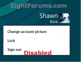

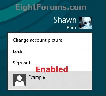

EXAMPLE: Add or Remove "Switch User" from "Start" Screen
NOTE: This is when you click/tap on your user name or picture.

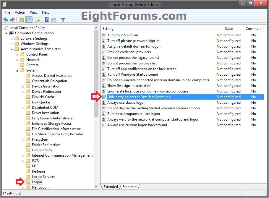

To Add or Remove "Switch User" in Local Group Policy Editor
1. From the Start screen, start typing gpedit.msc and press Enter when finished.
NOTE: You could also press Windows+R to open the Run dialog, type gpedit.msc, and click/tap on OK.
2. If prompted by UAC, then click on Yes.
3. In the left pane, click/tap on to expand Computer Configuration, Administrative Templates, System, and open Logon. (see screenshot below)

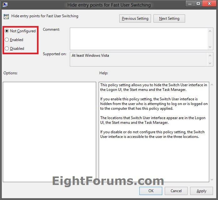

4. In the right pane of Logon, double click/tap on Hide entry points for Fast User Switching. (see screenshot above)
6. To Add "Switch User" for All Users
A) Select (dot) Disabled or Not Configured, click/tap on OK, and go to step 8 below. (see screenshot below step 7A)
7. To Remove "Switch User" for All Users
A) Select (dot) Enabled, click/tap on OK, and go to step 8 below. (see screenshot below)
