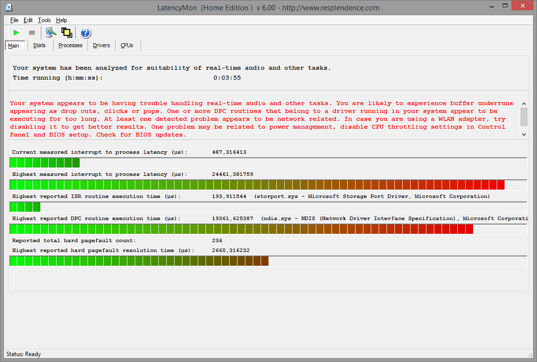

I experience heavy video/audio stuttering when playing a video or general latencies when downloading a file when connected via LAN/Ethernet NOT when connected via WLAN/Wifi. According to my observations the stuttering only happens when the LAN network driver is somehow busy, which means preloading the video or downloading a file. As soon as the video is chached/loaded or the file is downloaded, the stuttering disappears. So in my opinion it is definetly a driver problem.
I recently updated the LAN driver due to suddenly occuring BSOD. The update fixed the BSODs but now the stuttering appeared. I already tried to switch to other versions of the driver or even use just the Windows driver, but the problem doesn't disappear.
With updating the LAN driver I also updated all the other drivers (BIOS, Soundcard, PCI, Chipset, etc.) because my system was a little outdated. Everything works fine and in games (like Borderlands) everything works like a charm. Just when the LAN driver is busy the CPU has a 90%-100% load. The process causing the CPU load is in these cases not Chrome, it's the System process according to the task manager. Another hint that the driver should be responsible.
The Graphic card is up to date and running on the latest beta driver from AMD (tried the normal driver too, no difference).
LatencyMon showed me that ndis.sys is causing excessive latency.

Hi broe23.. Thanks again for help, but I guess you missunderstood my problem a little. I don't have problems with the video loading or something. The problem is: when the video is loading (or a file is downloading) it causes havey latencies/lags on my computer which are perceivable by the audio stuttering and distorting or the mouse movement lagging or just the video stopping for milliseconds ALTHOUGH the video is already precached lets say a few minutes.. so its really not a matter of ISP or download speed or something.. it's my computer lagging as hell when Ethernet card is busy.
Maybe I should record a video to show what I mean :/
Did a short LatencyMon test while watching a video. Hope that helps..
