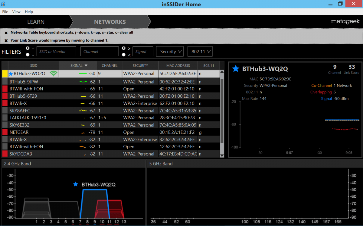

You need to try and determine where your problem lies. Did you change router wireless channels ? There is a free program called InSSider that will show all the WiFi activity around you. This shows my router on channel 9 which is theoretically a poor choice but it is the channel that works well for me. I had odd weird connection issues and my speed falling from around 38mbs down to 1 or 2 mbs. The problem was the WiFi channel automatically chosen by the router. I changed to manual and found 9 the best. I also got limited connectivity like yourself. At first I too tried rebooting the router and it fixed both speed and connection issues. I didn't automatically associate wifi channel with the problems I had because I could connect OK to the router at all times. But it was.
I think I got InSSider from Major Geeks,
Download inSSIDer - MajorGeeks
Be careful what you click on.
