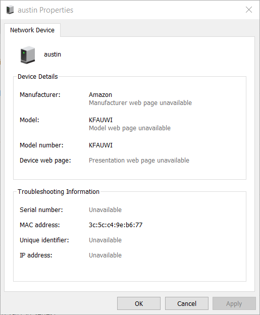

I presume you mean unrecognised devices appear in Explorer under Network. It's annoying, but not a security problem. Your neighbor's devices like an Amazon Echo announce themselves to the world and may be listed, but they are NOT connected to your network or have any access. You can confirm this by looking at their Properties. Note that they have no IP address assigned, without one they cannot access anything on your network (nor can you access them).
More on this here: Network Device: Amazon KFAUWI

That is more worrying. You router's table should show whether the devices are currently connected, or just a record of a connection in the past. If they are no longer connected, could it be a device that a visitor may have connected with your or the other person's permission? The Amazon KFAUWI device in my post, for example, appears to be an Amazon Fire tablet: Amazon KFAUWI
Depending on the make of router, you should be able to disconnect any device you don't recognise, or even block its mac address from connecting again. Check your router's manual.
