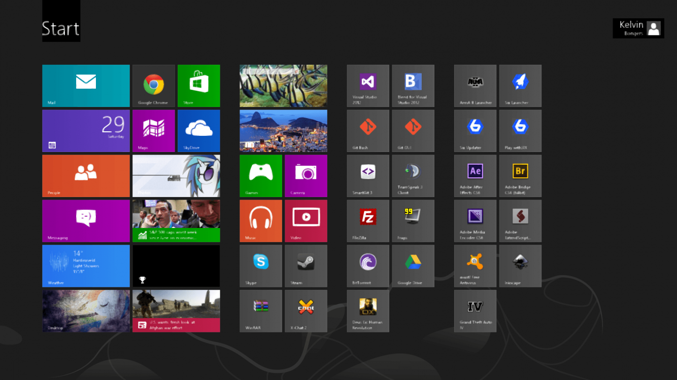

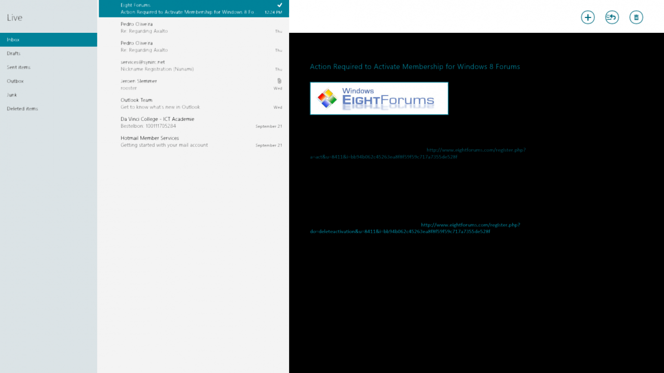

Windows 8 has been having very strange rendering errors, the desktop still works fine but the rest is all strange blurred with black boxes.
I have no idea what the problem is it just suddenly showed up as that.

I just found a fix. So reinstalling the driver did the job, however, if you fiddle around with the Nvidia Control Panel settings again, you may turn on Antialiasing - FXAA. << That's the issue. I turned it on again unknowingly and it began to blur with black boxes.
Fix:
1. Go to Nvidia Control Panel
2. Manage 3D Settings
3. Turn off Antialiasing - FXAA
I only turn it on when gaming or need it. Otherwise I'd turn it off for everyday use.
