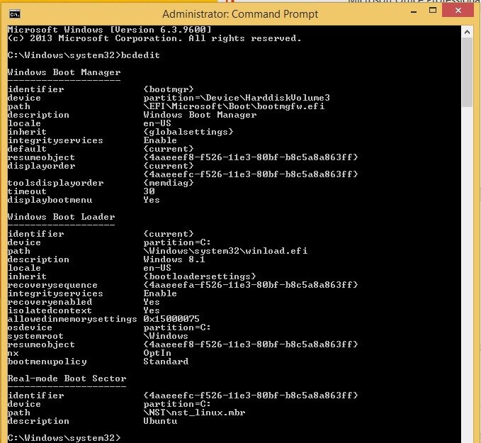

sametoxxo
Posts
#27
@Brink Hello :)
i have tried couple times, and google it but i can't solve this problem;
first, I have installed EasyBCD and now when i run, i get old screen with Win8 and Ubuntu
however, to get standard; i followed ur steps; but when i type
bcdedit /set {current} bootmenupolicy Standard ------> also my identifier is same as urs {current}
i get this error:
The integer data is not valid as specified.
Run "bcd edit /?" for command line assistance.
The parameter is incorrect.
    multi OSX, Win, Ubuntu
Posts
23,992
#28
Hello sametoxxo, and welcome to Eight Forums.
Ubuntu may be throwing a monkey wrench in this. Go ahead and type bcdedit in the elevated command prompt, press Enter, and post back with the results to see what the issue may be. :)

23,992
#30
sametoxxo,
I don't see anything that stands out for why this is happening, but I'm not familiar with dual booting with Ubuntu either. I would have to guess that something with Ubuntu may be the cause, but can't say what. :(
I've asked others to take a look to see if they may know.
