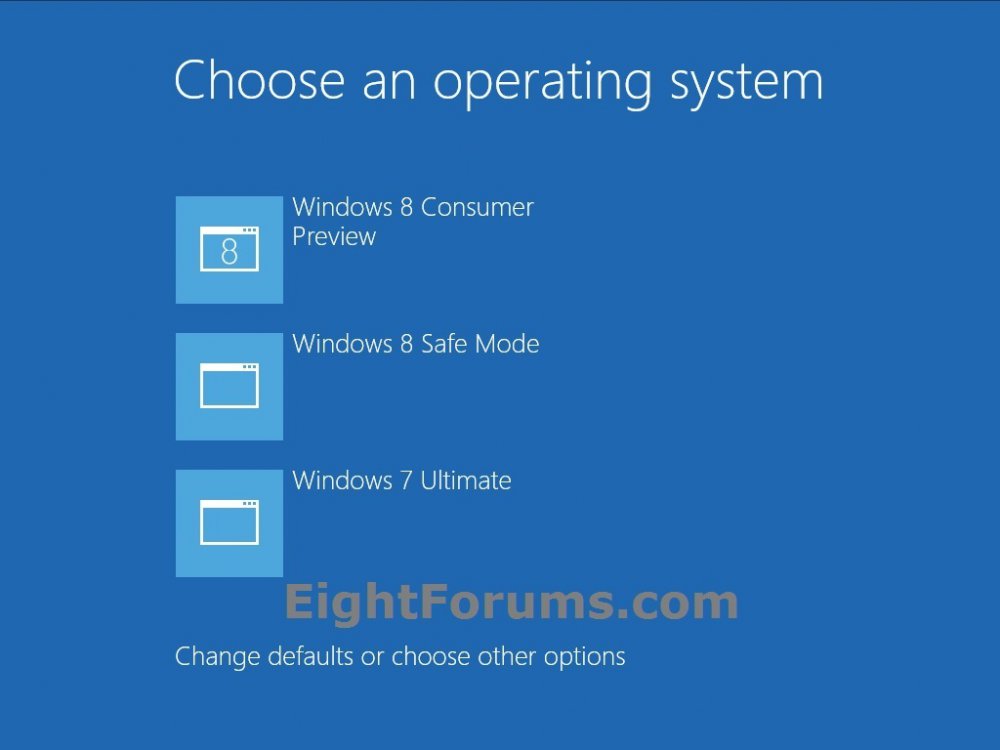

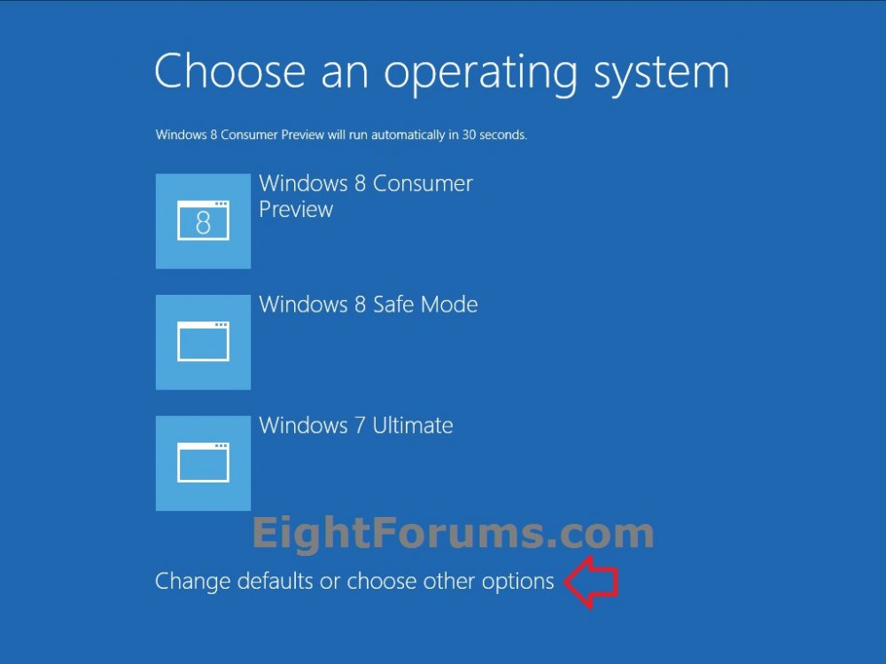

1. Boot to the Startup Options screen.​
2. Click on Change defaults or choose other options at the bottom. (see screenshot below)​

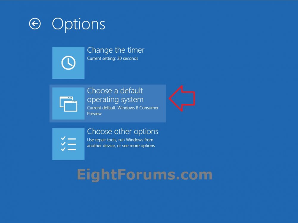

3. Click on Choose a default operating system. (see screenshot below)​
NOTE: This will also show you what your current default OS is.​
4. Select (click on) a listed OS that you want to be the new default OS to run at startup automatically. (see screenshot below)​
NOTE: You will also see what your current default OS is at the top.​

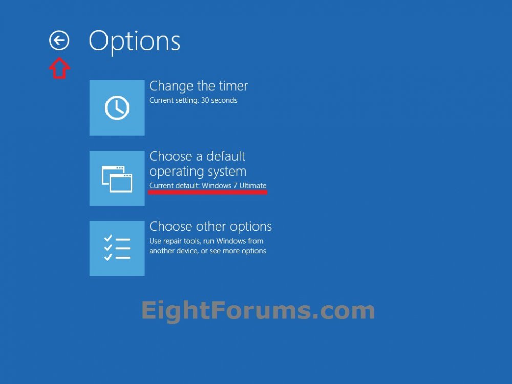

5. Verify that this is the default OS you want, and click on the back arrow at the top left corner. (see screenshot below)​
NOTE: If the default OS shown is not what you wanted, then repeat step 3 above.​
6. You are finished, click on the OS that you want to run at startup for just this time. (see screenshot below)​

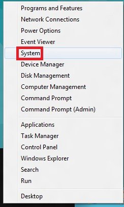

1. Do either step 2 or 3 below for how you would like to open System.​
2. Open the Power Users Task Menu, and click on System. (see screenshot below)​
A) Go to step 4 below.​

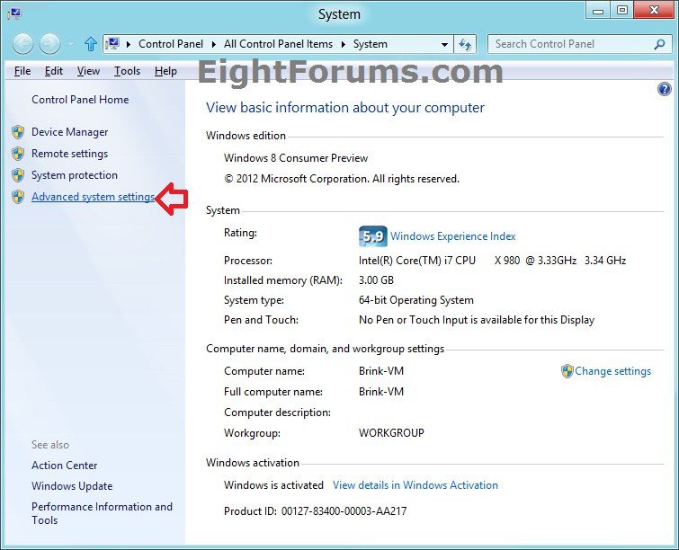

4. In the left pane, click on the Advanced system settings link. (see screenshot below)​
5. If prompted by UAC, then click on Yes, and close the System window above.​

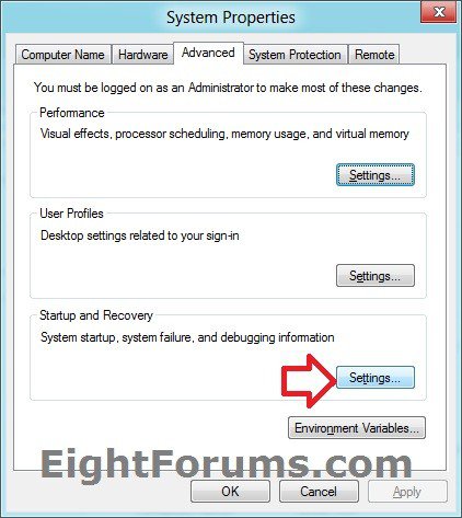

6. In the Advanced tab, click on the Settings button under Startup and Recovery. (see screenshot below)​

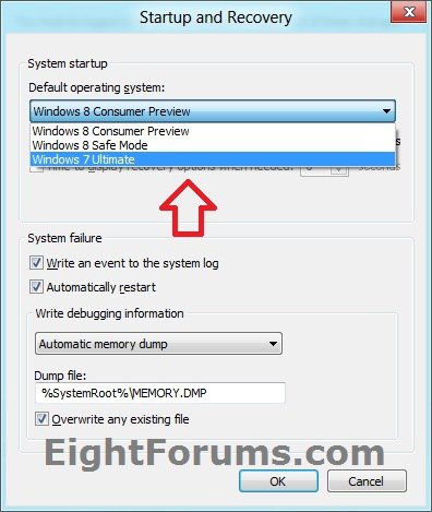

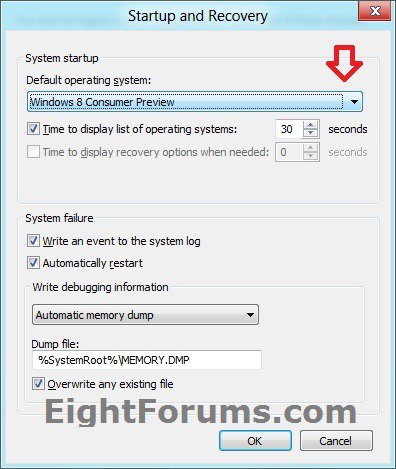

7. Under System Startup, select a OS from the drop down menu that you want to be the default OS to run at startup automatically, then click on OK. (see screenshots below)​
8. Click on OK. (see screenshot below step 6)​

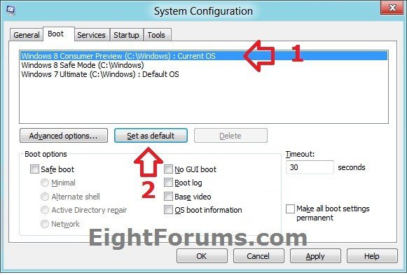

3. In the Boot tab, select (highlight) a listed OS that you want to be the new default OS to run at startup automatically, click on the Set as default button, and click on OK. (see screenshot below)​
NOTE: The current default OS will have Default OS to the right of the listed OS.​

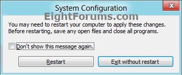

4. When ready, click on the Restart button to apply. (see screenshot below)​
WARNING: This will restart the computer immediately. Be sure to save and close anything open that you do not want to lose first.​

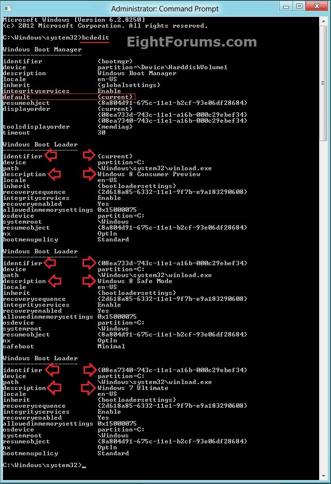

2. In the command prompt, type bcdedit and press enter. (see screenshot below)​
This will let you see what the default OS is under the Windows Boot Manager section, and to see the description (name) and identifier of the operating system(s) listed in Windows Boot Manager under the Windows Boot Loader section(s). For example, Windows 7 Ultimate (description) as {08ea7340-743c-11e1-a16b-000c29ebef34} (identifier).

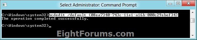

3. In the elevated command prompt, type the command below for a listed OS that you want to be the default OS to start, and press Enter. (see screenshot below)​
bcdedit /default {identifier}
For example: If I wanted to change the default OS to start from Windows 7 Ultimate (description) as {current} (identifier) to Windows 7 Ultimate (description) as {08ea7340-743c-11e1-a16b-000c29ebef34} (identifier), I would type this below and press Enter.​
bcdedit /default {08ea7340-743c-11e1-a16b-000c29ebef34}
4. When finished, close the command prompt.​
