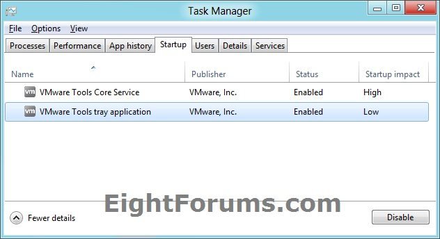

To Enable or Disable Startup Programs in Task Manager
1. Open Task Manager into the More details view, and click/tap on the Startup tab. (see screenshots below)​
2. To Enable a Startup Program
A) Click/tap on a disabled startup item, and click/tap on the Enable button.​
NOTE: If the Enable button is grayed out, then it means that you must be signed in as an administrator to be able to.​

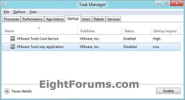

3. To Disable a Startup Program
A) Click/tap on a enabled startup item, and click/tap on the Disable button.​
NOTE: If the Disable button is grayed out, then it means that you must be signed in as an administrator to be able to.​
4. When finished, you can close Task Manager.​

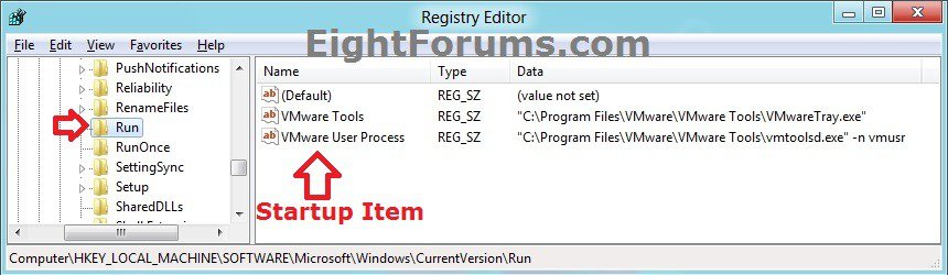

To Delete Startup Programs in Registry Editor
1. Open regedit, and do step 3 or 4 below for what you would like to do.​
NOTE: You could do this by pressing :winkey: + R to open Run, type regedit, and click/tap on OK.​
3. To Delete Startup Programs for the "Current User" Only
NOTE: This will only be applied to your currently signed in user account.​
A) In regedit, navigate to the locations below one at a time.​
[B]HKEY_CURRENT_USER\Software\Microsoft\Windows\CurrentVersion\Run[/INDENT]
[INDENT=2][COLOR=red][/INDENT]
[INDENT=2]AND[/COLOR][/B][/INDENT]
[INDENT=2][B][/INDENT]
[INDENT=2]HKEY_CURRENT_USER\Software\Microsoft\Windows\CurrentVersion\RunOnce[/B]
B) Go to step 5.​
4. To Delete Startup Programs for "All Users"
NOTE: You must be signed in as an administrator to be able to do this step.
For 32-bit and 64-bit Windows 8
[B]HKEY_LOCAL_MACHINE\SOFTWARE\Microsoft\Windows\CurrentVersion\Run[/INDENT]
[INDENT=2]AND[/INDENT]
[INDENT=2][/COLOR][/INDENT]
[INDENT=2]HKEY_LOCAL_MACHINE\SOFTWARE\Microsoft\Windows\CurrentVersion\RunOnce[/B][/INDENT]
[INDENT=2][COLOR=red][B][/INDENT]
[INDENT=2]AND (If added by [/B][/COLOR][B][URL="http://www.sevenforums.com/tutorials/208799-programs-documents-run-user-logon.html"]Group Policy[/URL][/B][COLOR=red][B])[/B][/COLOR][/INDENT]
[INDENT=2][/INDENT]
[INDENT=2][B]HKEY_CURRENT_USER\Software\Microsoft\Windows\CurrentVersion\Policies\Explorer\Run[/B][/INDENT]
[INDENT=2][/INDENT]
[INDENT=2][B][COLOR=#ff0000]AND (If added by [/COLOR][URL="http://www.sevenforums.com/tutorials/208799-programs-documents-run-user-logon.html"]Group Policy[/URL][COLOR=#ff0000])[/COLOR][/B][/INDENT]
[INDENT=2][/INDENT]
[INDENT=2][B]HKEY_LOCAL_MACHINE\SOFTWARE\Microsoft\Windows\CurrentVersion\Policies\Explorer\Run[/B]
In Addition for Only 64-bit Windows 8
[B]HKEY_LOCAL_MACHINE\SOFTWARE\Wow6432Node\Microsoft\Windows\CurrentVersion\Run[/INDENT]
[INDENT=2][/INDENT]
[INDENT=2][B]HKEY_LOCAL_MACHINE\SOFTWARE\Wow6432Node\Microsoft\Windows\CurrentVersion\RunOnce[/B]
5. In the right pane of Run or RunOnce, right click or press and hold on a listed startup item that you would like to delete, and click/tap on Delete. (see screenshot below)​
6. Click/tap on Yes to confirm deletion.​
7. When done, close regedit.​

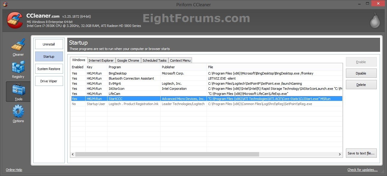

OPTION FOUR
To Enable, Disable, or Delete Startup Programs in CCleaner
1. If you have not already, download and install the latest version of the free CCleaner program.​
2. Run CCleaner, click/tap on the Tools icon on the left, then click/tap on the Startup tab. (see screenshot below)​
3. From here, you can select a startup item, then either enable, disable, or delete it. (see screenshot below)​

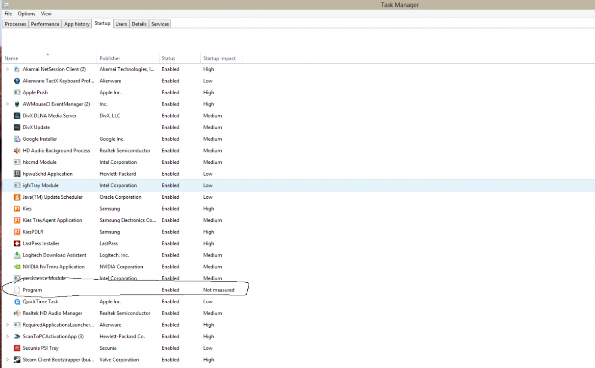

hi I have a wired process I cant find any info on it dose not even show up on CCcleaner how do I find this . here is a picture for you.t.png
    Windows 8.1 Pro

Hello Tony,
If you right click on it, does it allow you to click on Open file location or Properties?
If so, then either may help ID what this is for.
If not, then you might check all locations in the registry from OPTION THREE to see if you may find it listed in one of these registry locations.
If found in the registry, then disable this startup program in Task Manager and restart the computer first to see if you have any adverse effects with it disabled. If not, then create a restore point to be safe, then go back to the registry and delete this startup program's entry.
Hope this helps, :)
sadly i did that it not listed i even d-loaded Sysinternals autoruns and it did not show in there ether what could it be? virus scans come up normal and all malware scans are normal.

Are you able to disable it?
yes it list that but what if i do that and PC dont boot or some wired stuff like that?

i disabled it nothing happened i wonder what it may be kinda makes me wonder if its a hidden virus or something.

Possible, or some program that didn't install or uninstall properly.
You might go ahead and do a full scan of your system at boot with Windows Defender Offline to help make sure you are clean.
Sadly i can't run windows defender offline i tried it but my Rom is to new for it it UEFI Bios and windows defender offline dont recognize it. Any other offline tool i may try ?

ok i will do that any other suggestions as to what it could be Autoruns did show something called Samsung Kies air messenger with file not found do you think maybe that could be it? i did recently install Samsung Kies to update my android phone. but would it now show up in windows startup as this?
