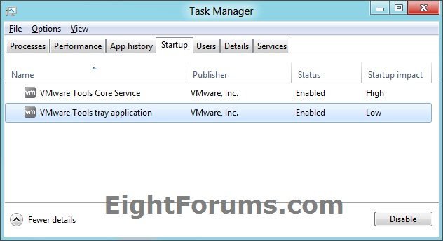

To Enable or Disable Startup Programs in Task Manager
1. Open Task Manager into the More details view, and click/tap on the Startup tab. (see screenshots below)​
2. To Enable a Startup Program
A) Click/tap on a disabled startup item, and click/tap on the Enable button.​
NOTE: If the Enable button is grayed out, then it means that you must be signed in as an administrator to be able to.​

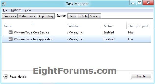

3. To Disable a Startup Program
A) Click/tap on a enabled startup item, and click/tap on the Disable button.​
NOTE: If the Disable button is grayed out, then it means that you must be signed in as an administrator to be able to.​
4. When finished, you can close Task Manager.​

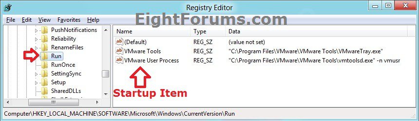

To Delete Startup Programs in Registry Editor
1. Open regedit, and do step 3 or 4 below for what you would like to do.​
NOTE: You could do this by pressing :winkey: + R to open Run, type regedit, and click/tap on OK.​
3. To Delete Startup Programs for the "Current User" Only
NOTE: This will only be applied to your currently signed in user account.​
A) In regedit, navigate to the locations below one at a time.​
[B]HKEY_CURRENT_USER\Software\Microsoft\Windows\CurrentVersion\Run[/INDENT]
[INDENT=2][COLOR=red][/INDENT]
[INDENT=2]AND[/COLOR][/B][/INDENT]
[INDENT=2][B][/INDENT]
[INDENT=2]HKEY_CURRENT_USER\Software\Microsoft\Windows\CurrentVersion\RunOnce[/B]
B) Go to step 5.​
4. To Delete Startup Programs for "All Users"
NOTE: You must be signed in as an administrator to be able to do this step.
For 32-bit and 64-bit Windows 8
[B]HKEY_LOCAL_MACHINE\SOFTWARE\Microsoft\Windows\CurrentVersion\Run[/INDENT]
[INDENT=2]AND[/INDENT]
[INDENT=2][/COLOR][/INDENT]
[INDENT=2]HKEY_LOCAL_MACHINE\SOFTWARE\Microsoft\Windows\CurrentVersion\RunOnce[/B][/INDENT]
[INDENT=2][COLOR=red][B][/INDENT]
[INDENT=2]AND (If added by [/B][/COLOR][B][URL="http://www.sevenforums.com/tutorials/208799-programs-documents-run-user-logon.html"]Group Policy[/URL][/B][COLOR=red][B])[/B][/COLOR][/INDENT]
[INDENT=2][/INDENT]
[INDENT=2][B]HKEY_CURRENT_USER\Software\Microsoft\Windows\CurrentVersion\Policies\Explorer\Run[/B][/INDENT]
[INDENT=2][/INDENT]
[INDENT=2][B][COLOR=#ff0000]AND (If added by [/COLOR][URL="http://www.sevenforums.com/tutorials/208799-programs-documents-run-user-logon.html"]Group Policy[/URL][COLOR=#ff0000])[/COLOR][/B][/INDENT]
[INDENT=2][/INDENT]
[INDENT=2][B]HKEY_LOCAL_MACHINE\SOFTWARE\Microsoft\Windows\CurrentVersion\Policies\Explorer\Run[/B]
In Addition for Only 64-bit Windows 8
[B]HKEY_LOCAL_MACHINE\SOFTWARE\Wow6432Node\Microsoft\Windows\CurrentVersion\Run[/INDENT]
[INDENT=2][/INDENT]
[INDENT=2][B]HKEY_LOCAL_MACHINE\SOFTWARE\Wow6432Node\Microsoft\Windows\CurrentVersion\RunOnce[/B]
5. In the right pane of Run or RunOnce, right click or press and hold on a listed startup item that you would like to delete, and click/tap on Delete. (see screenshot below)​
6. Click/tap on Yes to confirm deletion.​
7. When done, close regedit.​

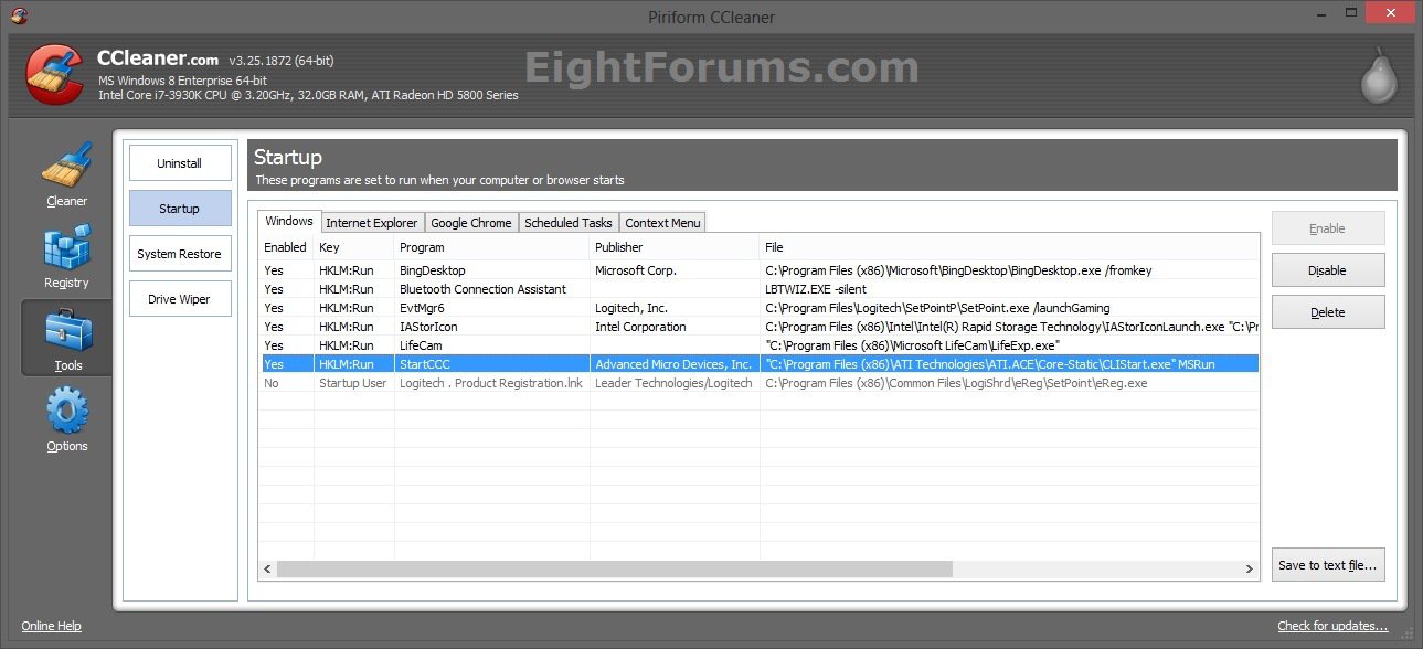

OPTION FOUR
To Enable, Disable, or Delete Startup Programs in CCleaner
1. If you have not already, download and install the latest version of the free CCleaner program.​
2. Run CCleaner, click/tap on the Tools icon on the left, then click/tap on the Startup tab. (see screenshot below)​
3. From here, you can select a startup item, then either enable, disable, or delete it. (see screenshot below)​

In my Win 8 Task Manager Startup Tab, I found two entries that were enabled called 'Program'. No Publisher is listed. If I right click on them, the Open File Location and Properties are grayed out. I disabled both of them. How can I find out what these are and delete them? Thanks!
    Win 8
Hello egruber, and welcome to Eight Forums.
Double check using OPTION FOUR instead to see if it may show a file path to help see what it is. :)
I tried that before I submitted the post. I didn't see them in there. Weird.
My apologies. I had not done Option 4, I had done Option 3. I did execute Option 4, found them and deleted them. Thanks very much for your help!
