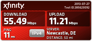

Try this test: Start a Youtube video and immediately hit the pause button. Watch the movement of the red progress bar until it fully loads the video. This obviously eliminates any buffering issues if the problem is still there when you try to play the video this way. You might also want to do a speed test on you internet connection. Here are my results:
Now, I know you are convinced that it is absolutely not a buffering issue and you have done nice testing to that end; however, I would still try the tests as described above. Good luck.

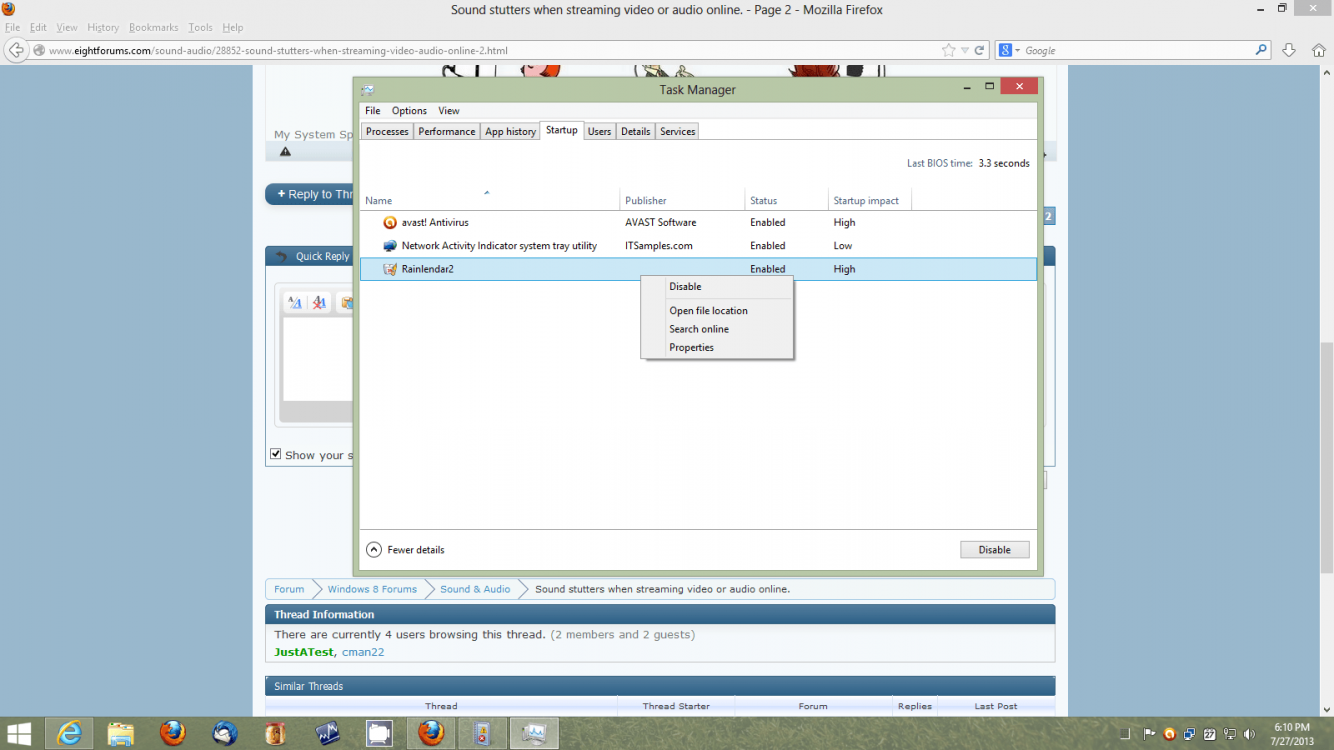

Go into task manager and disable all startup programs. Reboot and retest.
If fixed, start re-enabling programs (one at a time) until problem returns.
If no help re-enable startup programs.

Ok I'm so glad you didn't give up on me! So after disabling all startup processes, the problem is gone. Now for the painstaking process of turning them back on one by one :)
Hooray! Hip-hip hooray! Good for you. Please come back and let us know the final outcome. Glad I could help.
So far Skydrive was definitely a culprit.
Will see if there are others.
Skydrive is so full of bugs btw. I wanted to use it with Win 8 but it's awful.
Uninstalling it for sure.
