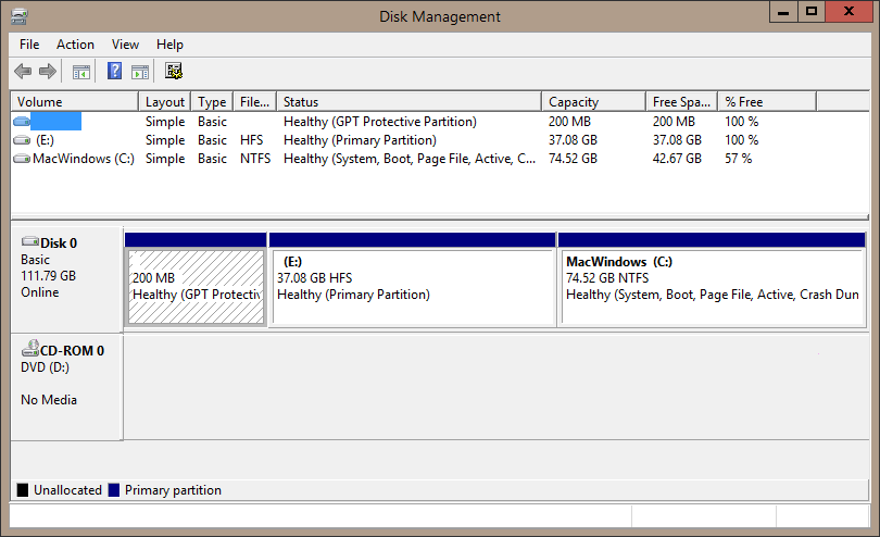

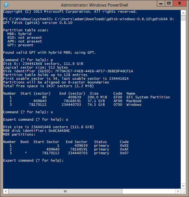

You don't give any specs but Windows will not install using a pre EFI 2.0 which includes most macs prior to 2013. If this is the case you will have to install Windows using a hybrid gpt/mbr partition which is described in the link above. This is OK but is problematic if you ever change partition sizes as you'll have to synch the mbr and gpt tables as changing partitions in OSX will not update the mbr and changing them in windows will not update the gpt. You then can end up overwriting the other OS data if you are not careful. You can use gdisk GPT fdisk | SourceForge.net to fix this if you later change partition sizes.

Edit: This is my set-up which works well dual booting.
