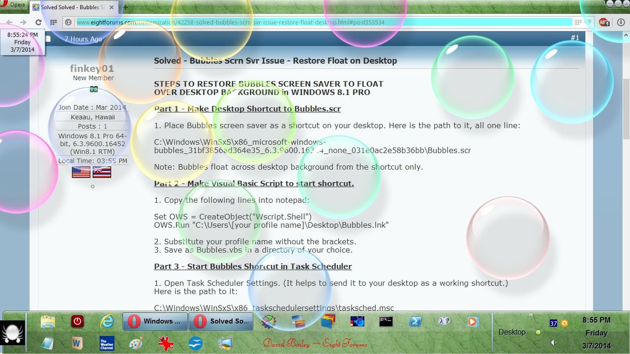

Submitted: 03/07/2014

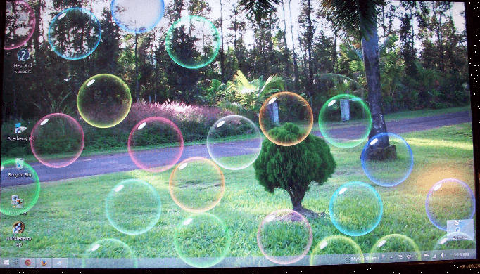

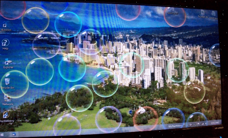

Lots of bubbles:
Lots of Bubbles - Congratulations
Well done David! Here are mine. Every time they float, it makes me happy. Glad yours works too!

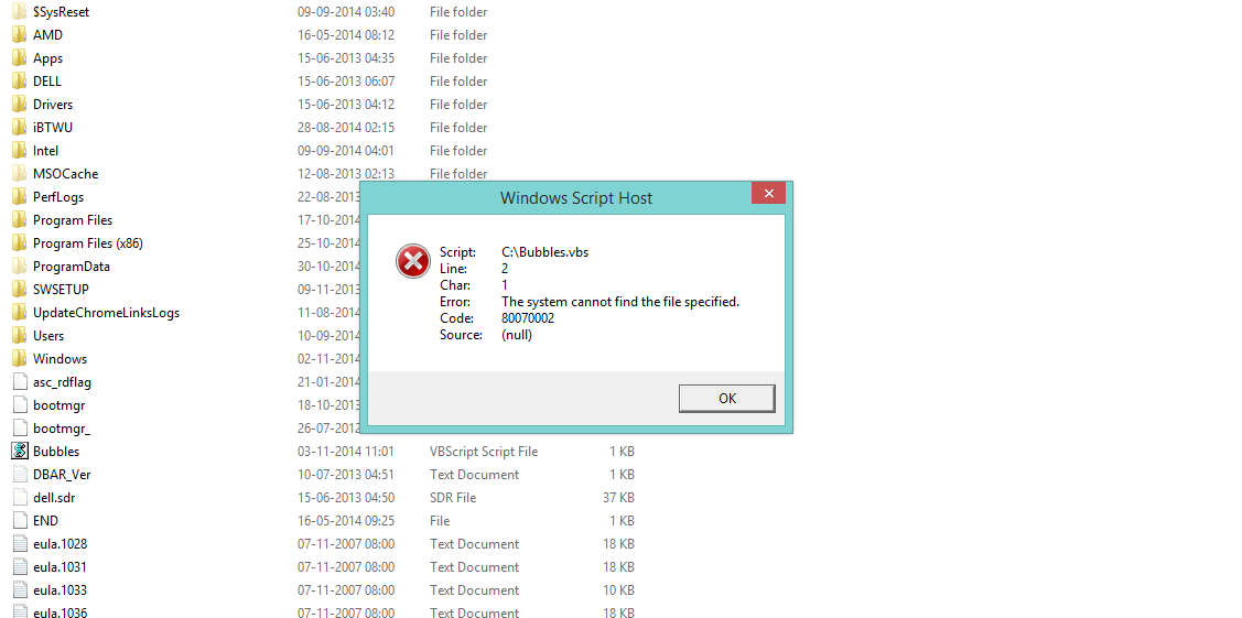

I keep receiving the error that "the system cannot find the file specified." The path is correctly entered in the Argument. I tried it with and without adding the file type (.vbs) to the end of Bubbles, since the file type is not shown in the title or the path when I look it up, but neither have worked. When I double click the shortcut to the screen saver on my desktop, it works but.. I don't understand what the problem is, how to activate it when I'm idle. I'm running Windows 8, don't know if that makes any difference. No one else seems to be having any problems.
Same here, any fix?

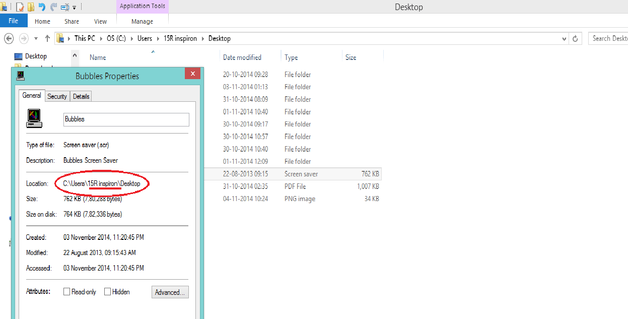

Here, I have kept it in the desktop - C:\Users\15R inspiron\Desktop\Bubbles.scr
Btw, I'm running windows 8.1.

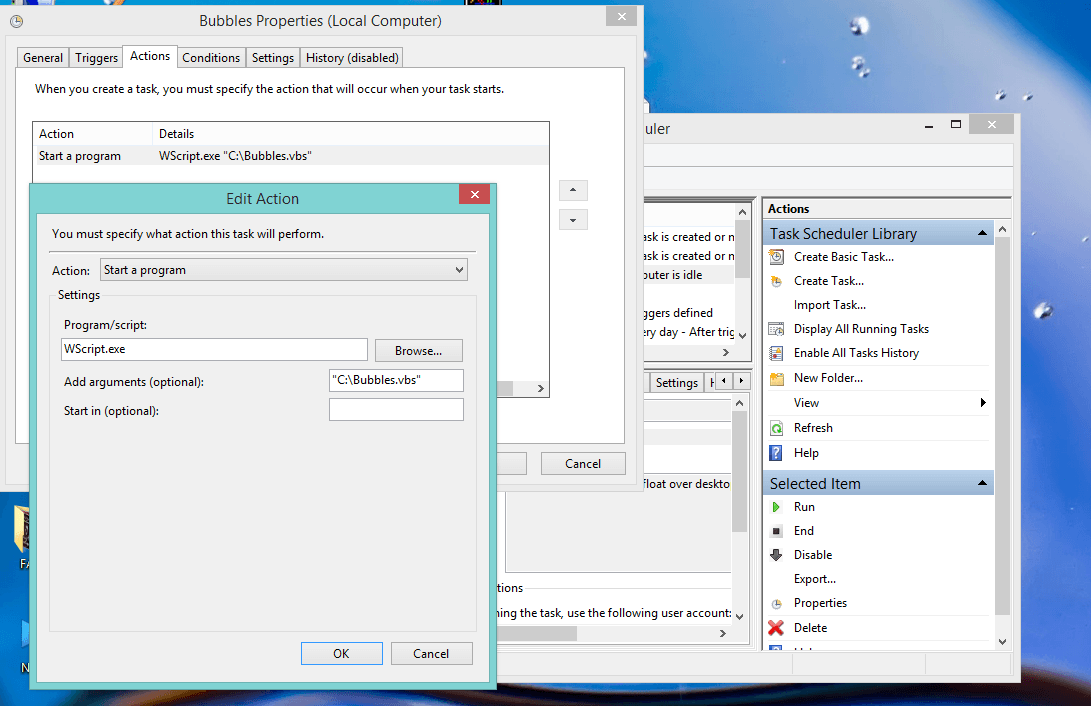

I have kept the Bubbles.vbs file in C:\ drive. Am I putting the arguments correctly ?
Great, we're on the same system. BTW nice screenshot, very helpful. Let's try these steps:
1. Please locate Windows' bubbles.scr:
C:\Windows\WinSxS\x86_microsoft-windows-bubbles_31bf3856ad364e35_6.3.9600.16384_none_031e0ac2e58b36bb\Bubbles.scr
and send it to the desktop as a shortcut. (Delete old shortcut) Test the new shortcut. Does it work?
2. At C:\ rename your script Bubbles.vbs
3. Check the content of your C:\Bubbles.vbs Does it look just like this, only user your name is there, not mine?
Set OWS = CreateObject("Wscript.Shell")
OWS.Run "C:\Users\Chums.Acerberry\Desktop\Bubbles.lnk"
4. Next, in your Task Manager, highlight your bubbles task, and on the lower right sidebar, select properties.
5. When the properties window pops up, select the Actions tab.
5. At the Actions window, highlight Start A Program and click Edit...
6. In the Add arguments (optional): box, be sure you have the path to C:\Bubbles.vbs enclosed in quotes, like this: "C:\Bubbles.vbs" Leave the Start in (optional): box blank. Your Program/script: box should have WScript.exe without quotes.
7. Click OK to save and close the Actions tab.
8. Next, click on the Triggers tab. It should say On Idle. Highlight that and click Edit...
9. Make sure on the Advanced settings portion all boxes are unchecked. Then put a check in Enabled.
10. Click OK to save and OK to close the Properties box.
11. Highlight your Bubbles task again and hit Run in the lower right sidebar to test.
12. If the bubbles float and you are satisfied, shake the mouse and hit End in the lower right sidebar. Say yes to End all instances of the task, and get out of Task Manager.
Let me know if this works for you.
Sonya
Hope this helps, keep me posted.
Sonya

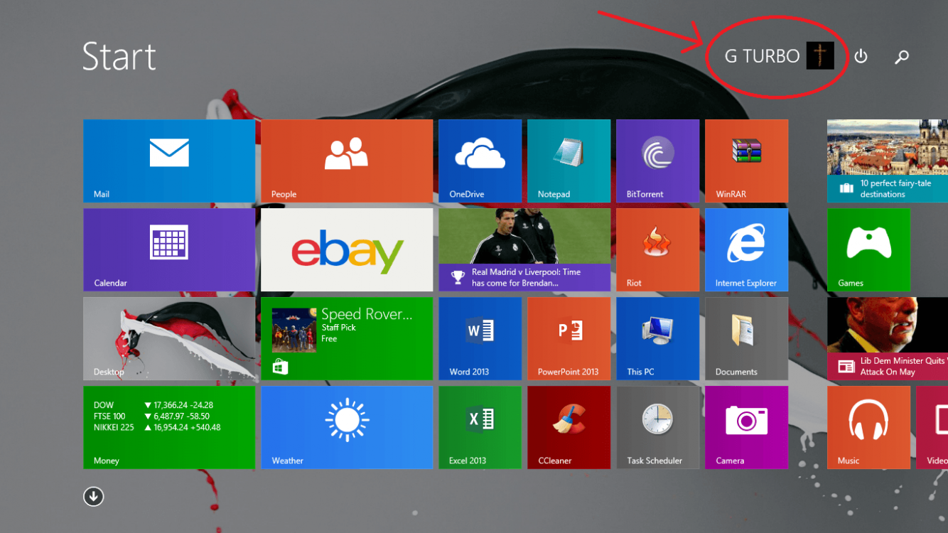

Dumb question alert !! Should my user name be G TURBO ?
I'll try to post screenshots as much as possible if that doesn't matter. I don't want to type much(Lazy Guy, I know). :sleepy:

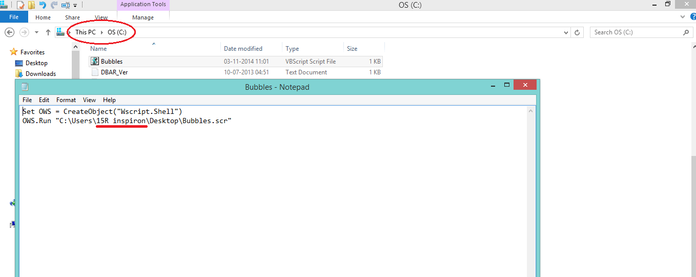

I tried using the .lnk shortcut and also by copying the bubbles screensaver file(Bubbles.scr) in the desktop but none worked. And I have put the Bubbles.vbs file in C:\[here].
Note: I'm now trying with the Bubbles.scr file in the desktop.
Reason why I have put 15R inspiron as username -
