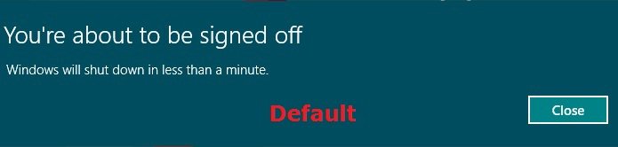

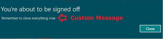

A time-out period can also be for how many seconds you have to use the Abort shortcut to quickly abort the computer from shutting down after using this Shut down shortcut.
EXAMPLE: Shut Down Message
NOTE: This is a comparison between the default and a custom message. You will only see a shut down message if you have a time delay included in the shortcut.

Substitute Your message here in the command above with a custom message up to 512 characters within quotes that you would like to see in the pop-up dialog when using the shutdown shortcut. The message will only be seen for however long you set the time delay set to be.​

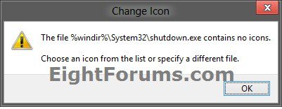

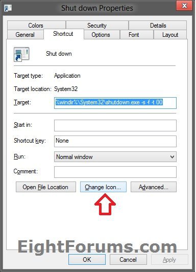

4. Right click on the new Shut down shortcut on the Desktop and click/tap on Properties.​
6. Click/tap on OK. (see screenshot below)​

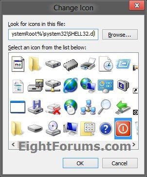

7. In the line under "Look for icons in this file", copy and paste the location below and press Enter. (see screenshot below step 8)​
%SystemRoot%\system32\SHELL32.dll
8. Select the icon highlighted in blue above, and click/tap on OK. (see screenshot above)​
9. Click/tap on OK. (see screenshot below step 5)​
