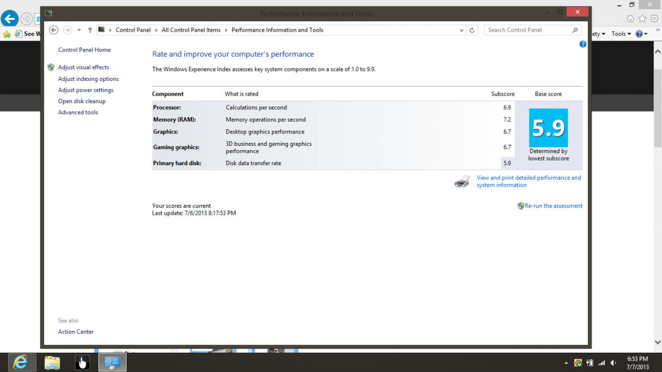

Speaking of laptops, a bit of an update to the WEI score here with an SSD: 8.0 (instead of 5.9 from HDD).
Graphics: just about 6.4 (other drivers had 6.6 it still depends....) but one thing is for sure: if you have dual graphics, Intel HD4000 embedded on CPU and a Nvidia Geforce M, the score would always be done with the embedded (weaker) one, here HD4000 and that's why the gfx score doesn't look too bright when expected.
