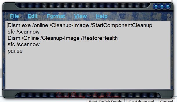

Try this batch file---
Right click it & click Properties & Unblock it & right click it & choose Run as administrator.

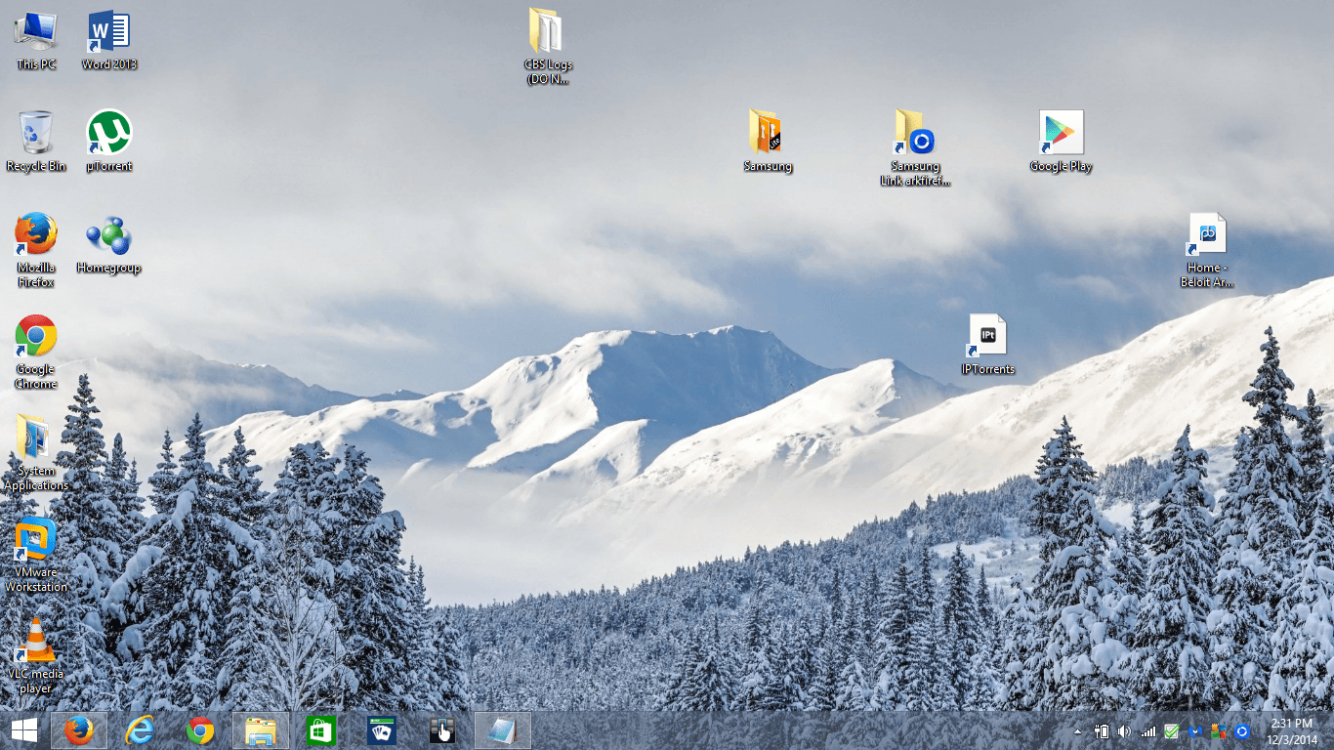

Also i seem to have the homegroup icon on my desktop that wasn't there til after i ran DISM.bat and sfc/scannow.
Usually if I just right click on the desktop and hit refresh, it goes away. :)

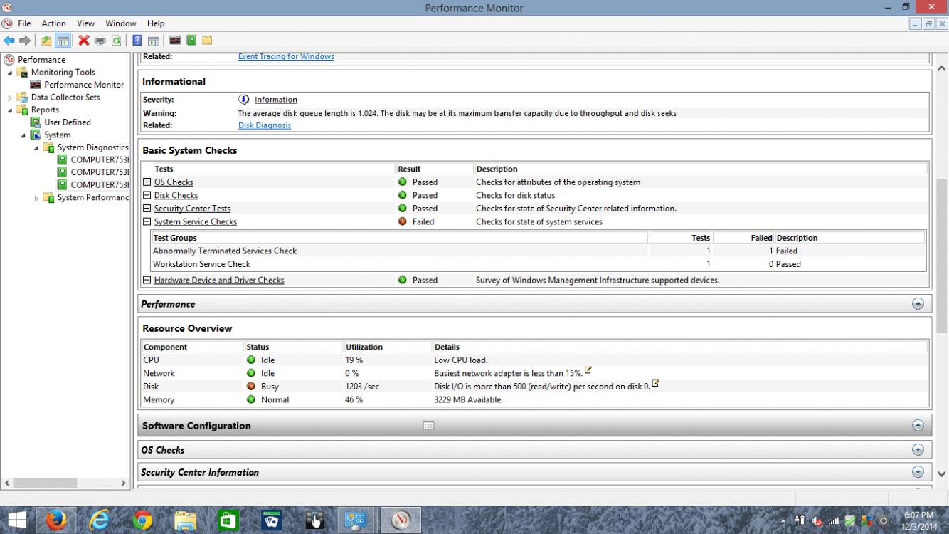

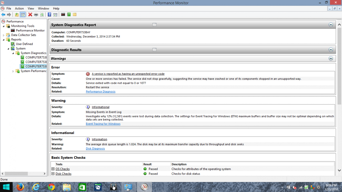

Worked like a charm thanks!!! Also i ran a performance check on it and it came back with this was wondering if you could tell me what the failure was and how to fix it?
Looks like a hard drive error. What does SMART report? Clear logs and see if it shows up again.

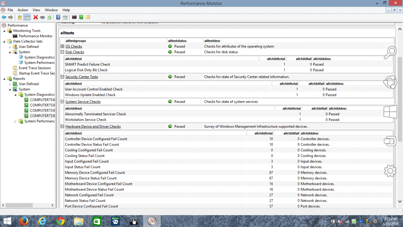

Smart checks out everything is "Good" I also ran a Hard Drive test and it passed as well and fixed 2 errors. Report still shows the same failed event. What is Abnormally Terminated Services check? That is what failed.. The HDD was so active was because i was running Windows Defrag during the logging process.
What does the blue "Related" hot spots bring up?
If I'm understanding correctly when I click the link below it it brings me to here.
Start, stop, pause, resume, or restart a service: Management Services
It don't bring me to a answer. But I did a Google search of Abnormally Terminated Services Check and I read several things that point to running command (sfc /scannow) and the DISM / Restore Health which I did but it presented the same error. Never did find out what it actually means.
