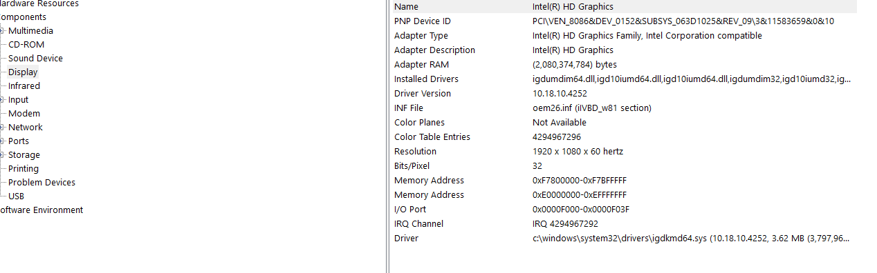

It appears you have a Nvadia Video Card
Repairing corrupted file [l:23 ml:24]"\??\C:\WINDOWS\SysWOW64"\[l:10]"opencl.dll" from store
this is the Known and Common Issue you are having...
That > opencl.dll < is a known issue all through the windows 10 forum...
NV over-writes the MS file and SFC re-writes the MS file..
Your video card needs the NV file - so SFC will always report that MV file as corrupt - until MS and NV get on the same page
And yes, image_health works on windows 10 with windows 10 media
Well so far so good. Ran sfc /scannow with regular command prompt (administrator mode) normally and in safe mode and both times got that it couldn't find any integrity violations. I don't have a Nvidia card, though - I have an Intel one. Do you think it's safe now to go ahead and load the rest of the programs I want to put on my computer now? I just made a restore point btw. Thanks for your help btw.
