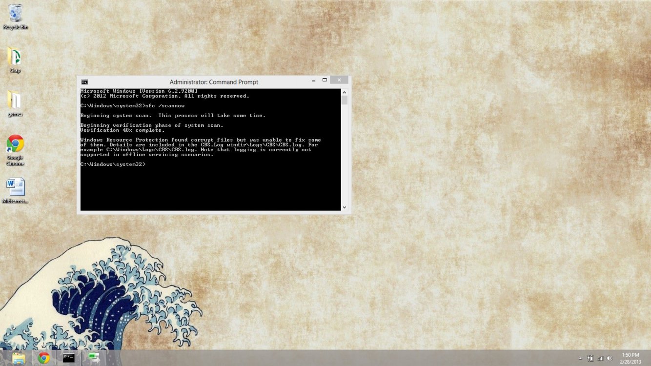

[h=1]Sfc /scannow found corrupt files but was unable to fix some. The log does not say whats wrong just stops. Not really sure where to go from here. Help please. [/h]

The logs are the same as before. I ran a chkdsk /r and even after that made some repairs running sfc still gives me the same error and incomplete logs. I also tried running sfc in safe mode and doing a refresher using windows 8 recovery tool still getting the same logs and sfc issue.
What was the full exact error message that SFC gave you? If you like post a screenshot of the command prompt showing everything to see if something may stand out.

Yep, that's why the log is incomplete. SFC was interrupted with that error.

ok well I have refreshed windows and im still encountering the same issue. one thing I have noticed is that running the check disk /r /f has moved the percentage that sfc stops at. First run was 41% then after runing another check disk the next sfc scannow was at 48% then 50%. After the refresh and then complete re install of windows (from the recovery partition) I am back to 41%. Could this be pointing to a defective hard drive?
