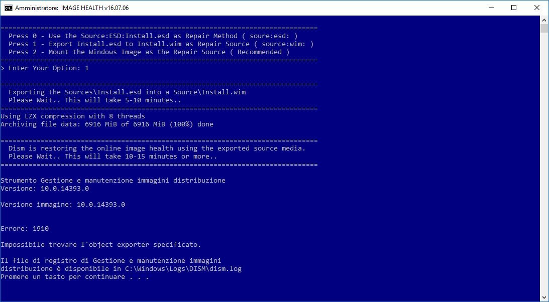

I'm trying to repair my system with your tool.
I ran "sfc /scannow", and it found some corrupted files it can't fix, so, i ran "DISM /Online /Cleanup-Image /RestoreHealth" (like the option 1 in your program), but it failed too, due to missing sources.
I understand that your program is able to run DISM using a "Install.esd/wim" file as source (correct me if I'm wrong :p), so I made a setup media with the "Media creation Tool" (both iso and usb), and i selected option 2:
The first thing I noticed was an additional menu I never saw on this thread:
Press 0 - Use the Source:ESD:Install.esd as Repair Method ( soure:esd: )
Press 1 - Export Install.esd to Install.wim as Repair Source ( source:wim: )
Press 2 - Mount the Windows Image as the Repair Source ( Recommended )
I tried a couple of times the first option (i have Install.esd), but I think it was the wrong one because it returned the source error every time.
After that, I tried 2-3 times the other two options, and I got this:
(in english)
I tried both with the USB drive and with the mounted ISO (both esd, I wouldn't know where to download a .wim one).

Thank you KYHI, but maybe I didn't make myself clear:
Is there a chance to repair those two files with your tool?
Because when I tried I encountered an error that I have described in the post n. 143.
(Error 1910: Could not find the object exporter specified )​

2017-05-05 05:25:05, Info                  DISM   DISM Provider Store: PID=4216 TID=6320 Connecting to the provider located at C:\Users\Su\AppData\Local\Temp\F7FBE3C6-1B44-4B0A-91CA-5D8703F58B5C\UnattendProvider.dll. - CDISMProviderStore::Internal_LoadProvider
2017-05-05 05:25:05, Info                  DISM   DISM Provider Store: PID=4216 TID=6320 Encountered a servicing provider, performing additional servicing initializations. - CDISMProviderStore::Internal_LoadProvider
2017-05-05 05:25:05, Info                  DISM   DISM Provider Store: PID=4216 TID=6320 Connecting to the provider located at C:\Users\Su\AppData\Local\Temp\F7FBE3C6-1B44-4B0A-91CA-5D8703F58B5C\SmiProvider.dll. - CDISMProviderStore::Internal_LoadProvider
2017-05-05 05:25:05, Warning               DISM   DISM Provider Store: PID=4216 TID=6320 Failed to Load the provider: C:\Users\Su\AppData\Local\Temp\F7FBE3C6-1B44-4B0A-91CA-5D8703F58B5C\EmbeddedProvider.dll. - CDISMProviderStore::Internal_GetProvider(hr:0x8007007e)
2017-05-05 05:25:05, Info                  DISM   DISM Provider Store: PID=4216 TID=6320 Connecting to the provider located at C:\Users\Su\AppData\Local\Temp\F7FBE3C6-1B44-4B0A-91CA-5D8703F58B5C\AppxProvider.dll. - CDISMProviderStore::Internal_LoadProvider
2017-05-05 05:25:05, Info                  DISM   DISM Provider Store: PID=4216 TID=6320 Connecting to the provider located at C:\Users\Su\AppData\Local\Temp\F7FBE3C6-1B44-4B0A-91CA-5D8703F58B5C\ProvProvider.dll. - CDISMProviderStore::Internal_LoadProvider
2017-05-05 05:25:05, Info                  DISM   DISM Provider Store: PID=4216 TID=6320 Connecting to the provider located at C:\Users\Su\AppData\Local\Temp\F7FBE3C6-1B44-4B0A-91CA-5D8703F58B5C\AssocProvider.dll. - CDISMProviderStore::Internal_LoadProvider
2017-05-05 05:25:05, Info                  DISM   DISM Provider Store: PID=4216 TID=6320 Connecting to the provider located at C:\Users\Su\AppData\Local\Temp\F7FBE3C6-1B44-4B0A-91CA-5D8703F58B5C\GenericProvider.dll. - CDISMProviderStore::Internal_LoadProvider
2017-05-05 05:25:05, Info                  DISM   DISM Provider Store: PID=4216 TID=6320 Connecting to the provider located at C:\Users\Su\AppData\Local\Temp\F7FBE3C6-1B44-4B0A-91CA-5D8703F58B5C\OfflineSetupProvider.dll. - CDISMProviderStore::Internal_LoadProvider
2017-05-05 05:25:05, Info                  DISM   DISM Provider Store: PID=4216 TID=6320 Connecting to the provider located at C:\Users\Su\AppData\Local\Temp\F7FBE3C6-1B44-4B0A-91CA-5D8703F58B5C\TransmogProvider.dll. - CDISMProviderStore::Internal_LoadProvider
2017-05-05 05:25:05, Info                  DISM   DISM Transmog Provider: PID=4216 TID=6320 Current image session is [ONLINE] - CTransmogManager::GetMode
2017-05-05 05:25:05, Info                  DISM   DISM Transmog Provider: PID=4216 TID=6320 Audit Mode: [No] - CTransmogManager::Initialize
2017-05-05 05:25:05, Info                  DISM   DISM Transmog Provider: PID=4216 TID=6320 GetProductType: ProductType = [WinNT] - CTransmogManager::GetProductType
2017-05-05 05:25:05, Info                  DISM   DISM Transmog Provider: PID=4216 TID=6320 Product Type: [WinNT] - CTransmogManager::Initialize
2017-05-05 05:25:05, Info                  DISM   DISM Transmog Provider: PID=4216 TID=6320 Product Type ServerNT : [No] - CTransmogManager::Initialize
2017-05-05 05:25:05, Info                  DISM   DISM.EXE: Got the collection of providers. Now enumerating them to build the command table.
2017-05-05 05:25:05, Info                  DISM   DISM.EXE: Attempting to add the commands from provider: DISM Log Provider
2017-05-05 05:25:05, Info                  DISM   DISM.EXE: Attempting to add the commands from provider: OSServices
2017-05-05 05:25:05, Info                  DISM   DISM.EXE: Attempting to add the commands from provider: DISM Package Manager
2017-05-05 05:25:05, Info                  DISM   DISM.EXE: Succesfully registered commands for the provider: DISM Package Manager.
2017-05-05 05:25:05, Info                  DISM   DISM.EXE: Attempting to add the commands from provider: MsiManager
2017-05-05 05:25:05, Info                  DISM   DISM.EXE: Succesfully registered commands for the provider: MsiManager.
2017-05-05 05:25:05, Info                  DISM   DISM.EXE: Attempting to add the commands from provider: IntlManager
2017-05-05 05:25:05, Info                  DISM   DISM.EXE: Succesfully registered commands for the provider: IntlManager.
2017-05-05 05:25:05, Info                  DISM   DISM.EXE: Attempting to add the commands from provider: IBSManager
2017-05-05 05:25:05, Info                  DISM   DISM.EXE: Attempting to add the commands from provider: DriverManager
2017-05-05 05:25:05, Info                  DISM   DISM.EXE: Succesfully registered commands for the provider: DriverManager.
2017-05-05 05:25:05, Info                  DISM   DISM.EXE: Attempting to add the commands from provider: DISM Unattend Manager
2017-05-05 05:25:05, Info                  DISM   DISM.EXE: Succesfully registered commands for the provider: DISM Unattend Manager.
2017-05-05 05:25:05, Info                  DISM   DISM.EXE: Attempting to add the commands from provider: SmiManager
2017-05-05 05:25:05, Info                  DISM   DISM.EXE: Attempting to add the commands from provider: AppxManager
2017-05-05 05:25:05, Info                  DISM   DISM.EXE: Succesfully registered commands for the provider: AppxManager.
2017-05-05 05:25:05, Info                  DISM   DISM.EXE: Attempting to add the commands from provider: ProvManager
2017-05-05 05:25:05, Info                  DISM   DISM.EXE: Succesfully registered commands for the provider: ProvManager.
2017-05-05 05:25:05, Info                  DISM   DISM.EXE: Attempting to add the commands from provider: AssocManager
2017-05-05 05:25:05, Info                  DISM   DISM.EXE: Succesfully registered commands for the provider: AssocManager.
2017-05-05 05:25:05, Info                  DISM   DISM.EXE: Attempting to add the commands from provider: GenericManager
2017-05-05 05:25:05, Info                  DISM   DISM.EXE: Succesfully registered commands for the provider: GenericManager.
2017-05-05 05:25:05, Info                  DISM   DISM.EXE: Attempting to add the commands from provider: OfflineSetupManager
2017-05-05 05:25:05, Info                  DISM   DISM.EXE: Succesfully registered commands for the provider: OfflineSetupManager.
2017-05-05 05:25:05, Info                  DISM   DISM.EXE: Attempting to add the commands from provider: Edition Manager
2017-05-05 05:25:05, Info                  DISM   DISM.EXE: Succesfully registered commands for the provider: Edition Manager.
2017-05-05 05:25:05, Info                  DISM   DISM Package Manager: PID=4216 TID=6320 Processing the top level command token(cleanup-image). - CPackageManagerCLIHandler::Private_ValidateCmdLine
2017-05-05 05:25:05, Info                  DISM   DISM Package Manager: PID=4216 TID=6320 Attempting to route to appropriate command handler. - CPackageManagerCLIHandler::ExecuteCmdLine
2017-05-05 05:25:05, Info                  DISM   DISM Package Manager: PID=4216 TID=6320 Routing the command... - CPackageManagerCLIHandler::ExecuteCmdLine
2017-05-05 05:25:05, Warning               DISM   DISM Package Manager: PID=4216 TID=6320 CBS AddSource failed with HRESULT=0x8007007b! - CDISMPackageManager::Internal_Finalize
2017-05-05 05:25:05, Info                  DISM   DISM Package Manager: PID=4216 TID=6320 CBS session options=0x20100! - CDISMPackageManager::Internal_Finalize
2017-05-05 05:26:35, Info                  DISM   DISM Package Manager: PID=4216 TID=1736  Error in operation: source for package or file not found, ResolveSource() unsuccessful. (CBS HRESULT=0x800f081f) - CCbsConUIHandler::Error
2017-05-05 05:26:35, Error                 DISM   DISM Package Manager: PID=4216 TID=6320 Failed finalizing changes. - CDISMPackageManager::Internal_Finalize(hr:0x800f081f)
2017-05-05 05:26:35, Error                 DISM   DISM Package Manager: PID=4216 TID=6320 The source files could not be found; their location must be specified using the /source option to restore the feature. - GetCbsErrorMsg
2017-05-05 05:26:35, Error                 DISM   DISM Package Manager: PID=4216 TID=6320 Failed processing package changes with session option CbsSessionOptionRepairStoreCorruption - CDISMPackageManager::RestoreHealth(hr:0x800f081f)
2017-05-05 05:26:35, Error                 DISM   DISM Package Manager: PID=4216 TID=6320 Failed to restore the image health. - CPackageManagerCLIHandler::ProcessCmdLine_CleanupImage(hr:0x800f081f)
2017-05-05 05:26:35, Error                 DISM   DISM Package Manager: PID=4216 TID=6320 Failed while processing command cleanup-image. - CPackageManagerCLIHandler::ExecuteCmdLine(hr:0x800f081f)
2017-05-05 05:26:35, Info                  DISM   DISM Package Manager: PID=4216 TID=6320 Further logs for online package and feature related operations can be found at %WINDIR%\logs\CBS\cbs.log - CPackageManagerCLIHandler::ExecuteCmdLine
2017-05-05 05:26:35, Info                  DISM   DISM Provider Store: PID=4216 TID=6320 Found the OSServices.  Waiting to finalize it until all other providers are unloaded. - CDISMProviderStore::Final_OnDisconnect
2017-05-05 05:26:35, Info                  DISM   DISM Provider Store: PID=4216 TID=6320 Found the PE Provider.  Waiting to finalize it until all other providers are unloaded. - CDISMProviderStore::Final_OnDisconnect
2017-05-05 05:26:35, Info                  DISM   DISM Provider Store: PID=4216 TID=6320 Finalizing the servicing provider(DISM Package Manager) - CDISMProviderStore::Internal_DisconnectProvider
2017-05-05 05:26:35, Info                  DISM   DISM Package Manager: PID=4216 TID=6320 Finalizing CBS core. - CDISMPackageManager::Finalize
2017-05-05 05:26:35, Info                  DISM   DISM Provider Store: PID=4216 TID=6320 Disconnecting Provider: DISM Package Manager - CDISMProviderStore::Internal_DisconnectProvider
2017-05-05 05:26:35, Info                  DISM   DISM Provider Store: PID=4216 TID=6320 Finalizing the servicing provider(MsiManager) - CDISMProviderStore::Internal_DisconnectProvider
2017-05-05 05:26:35, Info                  DISM   DISM Provider Store: PID=4216 TID=6320 Disconnecting Provider: MsiManager - CDISMProviderStore::Internal_DisconnectProvider
2017-05-05 05:26:35, Info                  DISM   DISM Provider Store: PID=4216 TID=6320 Finalizing the servicing provider(IntlManager) - CDISMProviderStore::Internal_DisconnectProvider
2017-05-05 05:26:35, Info                  DISM   DISM Provider Store: PID=4216 TID=6320 Disconnecting Provider: IntlManager - CDISMProviderStore::Internal_DisconnectProvider
2017-05-05 05:26:35, Info                  DISM   DISM Provider Store: PID=4216 TID=6320 Finalizing the servicing provider(IBSManager) - CDISMProviderStore::Internal_DisconnectProvider
2017-05-05 05:26:35, Info                  DISM   DISM Provider Store: PID=4216 TID=6320 Disconnecting Provider: IBSManager - CDISMProviderStore::Internal_DisconnectProvider
2017-05-05 05:26:35, Info                  DISM   DISM Provider Store: PID=4216 TID=6320 Finalizing the servicing provider(DriverManager) - CDISMProviderStore::Internal_DisconnectProvider
2017-05-05 05:26:35, Info                  DISM   DISM Provider Store: PID=4216 TID=6320 Disconnecting Provider: DriverManager - CDISMProviderStore::Internal_DisconnectProvider
2017-05-05 05:26:35, Info                  DISM   DISM Provider Store: PID=4216 TID=6320 Finalizing the servicing provider(DISM Unattend Manager) - CDISMProviderStore::Internal_DisconnectProvider
2017-05-05 05:26:35, Info                  DISM   DISM Provider Store: PID=4216 TID=6320 Disconnecting Provider: DISM Unattend Manager - CDISMProviderStore::Internal_DisconnectProvider
2017-05-05 05:26:35, Info                  DISM   DISM Provider Store: PID=4216 TID=6320 Finalizing the servicing provider(SmiManager) - CDISMProviderStore::Internal_DisconnectProvider
2017-05-05 05:26:35, Info                  DISM   DISM Provider Store: PID=4216 TID=6320 Disconnecting Provider: SmiManager - CDISMProviderStore::Internal_DisconnectProvider
2017-05-05 05:26:35, Info                  DISM   DISM Provider Store: PID=4216 TID=6320 Finalizing the servicing provider(AppxManager) - CDISMProviderStore::Internal_DisconnectProvider
2017-05-05 05:26:35, Info                  DISM   DISM Provider Store: PID=4216 TID=6320 Disconnecting Provider: AppxManager - CDISMProviderStore::Internal_DisconnectProvider
2017-05-05 05:26:35, Info                  DISM   DISM Provider Store: PID=4216 TID=6320 Finalizing the servicing provider(ProvManager) - CDISMProviderStore::Internal_DisconnectProvider
2017-05-05 05:26:35, Info                  DISM   DISM Provider Store: PID=4216 TID=6320 Disconnecting Provider: ProvManager - CDISMProviderStore::Internal_DisconnectProvider
2017-05-05 05:26:35, Info                  DISM   DISM Provider Store: PID=4216 TID=6320 Finalizing the servicing provider(AssocManager) - CDISMProviderStore::Internal_DisconnectProvider
2017-05-05 05:26:35, Info                  DISM   DISM Provider Store: PID=4216 TID=6320 Disconnecting Provider: AssocManager - CDISMProviderStore::Internal_DisconnectProvider
2017-05-05 05:26:35, Info                  DISM   DISM Provider Store: PID=4216 TID=6320 Finalizing the servicing provider(GenericManager) - CDISMProviderStore::Internal_DisconnectProvider
2017-05-05 05:26:35, Info                  DISM   DISM Provider Store: PID=4216 TID=6320 Disconnecting Provider: GenericManager - CDISMProviderStore::Internal_DisconnectProvider
2017-05-05 05:26:35, Info                  DISM   DISM Provider Store: PID=4216 TID=6320 Finalizing the servicing provider(OfflineSetupManager) - CDISMProviderStore::Internal_DisconnectProvider
2017-05-05 05:26:35, Info                  DISM   DISM Provider Store: PID=4216 TID=6320 Disconnecting Provider: OfflineSetupManager - CDISMProviderStore::Internal_DisconnectProvider
2017-05-05 05:26:35, Info                  DISM   DISM Provider Store: PID=4216 TID=6320 Finalizing the servicing provider(Edition Manager) - CDISMProviderStore::Internal_DisconnectProvider
2017-05-05 05:26:35, Info                  DISM   DISM Provider Store: PID=4216 TID=6320 Disconnecting Provider: Edition Manager - CDISMProviderStore::Internal_DisconnectProvider
2017-05-05 05:26:35, Info                  DISM   DISM Provider Store: PID=4216 TID=6320 Releasing the local reference to OSServices. - CDISMProviderStore::Internal_DisconnectProvider
2017-05-05 05:26:35, Info                  DISM   DISM Provider Store: PID=4216 TID=6320 Disconnecting Provider: OSServices - CDISMProviderStore::Internal_DisconnectProvider
2017-05-05 05:26:35, Info                  DISM   DISM Provider Store: PID=4216 TID=6320 Releasing the local reference to DISMLogger.  Stop logging. - CDISMProviderStore::Internal_DisconnectProvider
2017-05-05 05:26:35, Info                  DISM   DISM Manager: PID=6048 TID=5944 Closing session event handle 0x188 - CDISMManager::CloseImageSession
2017-05-05 05:26:35, Info                  DISM   DISM.EXE: Image session has been closed. Reboot required=no.
2017-05-05 05:26:35, Info                  DISM   DISM.EXE: <----- Ending Dism.exe session ----->
2017-05-05 05:26:35, Info                  DISM   DISM Provider Store: PID=6048 TID=5944 Found the OSServices.  Waiting to finalize it until all other providers are unloaded. - CDISMProviderStore::Final_OnDisconnect
2017-05-05 05:26:35, Info                  DISM   DISM Provider Store: PID=6048 TID=5944 Disconnecting Provider: FolderManager - CDISMProviderStore::Internal_DisconnectProvider
2017-05-05 05:26:35, Info                  DISM   DISM Provider Store: PID=6048 TID=5944 Releasing the local reference to DISMLogger.  Stop logging. - CDISMProviderStore::Internal_DisconnectProvider
Please help, I had this problem 1 year ago but I can not fix it. Thanks and appreciate the help.
