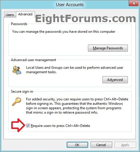

1. From the Start screen, start typing netplwiz and press Enter when finished.​
NOTE: You could also press Windows+R to open the Run dialog, type netplwiz, and click on OK.​
2. If prompted by UAC, then click on Yes.​
3. Do step 4 or 5 below for what you would like to do.​
4. To Enable Secure Sign-in
A) Check the Require users to press Ctrl+Alt+Delete box, and click on OK. (see screenshot below)​
NOTE: If the setting is grayed out, then do OPTION TWO or OPTION THREE below instead.​
5. To Disable Secure Sign-in
A) Uncheck the Requires users to press Ctrl+Alt+Delete box, and click on OK. (see screenshot below)
NOTE: This is the default setting. If the setting is grayed out, then do OPTION TWO or OPTION THREE below instead.​

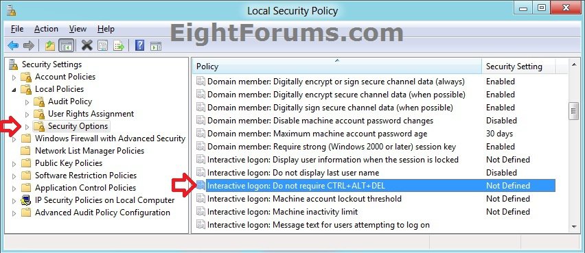

1. From the Start screen, start typing secpol.msc and press Enter when finished.​
NOTE: You could also press Windows+R to open the Run dialog, type secpol.msc, and click on OK.​
3. In the left pane, expand Local Policies, and click on Security Options. (see screenshot below)​
4. In the right pane, right click on Interactive Logon: Do not required CTRL+ALT+DEL and click on Properties. (see screenshot above)​

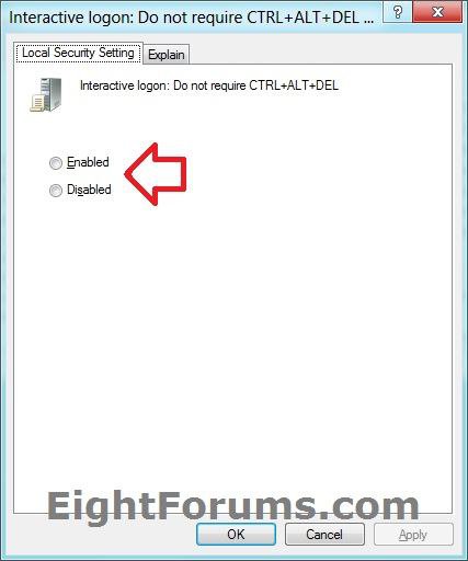

6. To Enable Secure Sign-in
A) Select (dot) Disabled, and click on OK. (see screenshot below)​
B) Go to step 8 below.​
7. To Disable Secure Sign-in
A) Select (dot) Enabled, and click on OK. (see screenshot below)

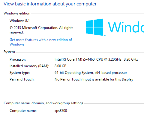

I just tried using the 3rd option to typing secpol.msc and press Enter. But I keep getting a message that it can't be found. To trying checking the spelling and try again.
Is that option not available on my computer?
Never mind - I just did some more searching and found out that it is not available in the home / basic edition of windows 8.1. I guess I will have to use the registry option to change the settings. They tell you not to mess with the registry, but don't make things available to those who purchase the basic editions - gotta love MS reasoning :sarc:
Thanks
