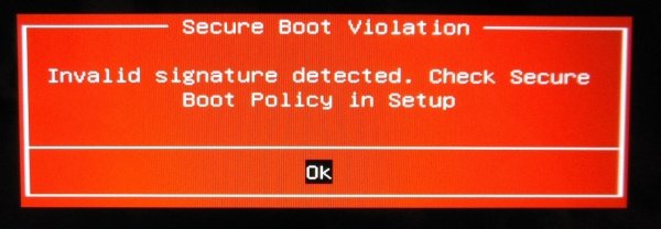

Hello all,
I own an Asus laptop with pre-installed Windows 8.1 and, after downloading & installing recent Windows updates (20th of September 2014, if memory serves me correctly), I am unable to access desktop because system freezes at boot sequence returning me this error: "Secure Boot Violation. Invalid signature detected. Check Secure Boot Policy in Setup" printed inside a small red box.
After googling around, someone suggested to disable "Secure Boot" from BIOS and enable "Launch CSM". I performed such operations but I got no results (BIOS menu automatically appears after every reboot). Someone else suggested to change boot sequence and start system from a Recovery CD but I got no CD supplied with my laptop as Asus stopped providing CDs from very long time AFAIK.
I am quite sure problem relies on Windows Updates because I used this Laptop very little times and no p2p or hacked programs are installed. In addition to that, as far as I read, it seems other Win users experienced the same issue after installing WinUpdates but they have different BIOS so is not easy for me to understand my BIOS accordingly to what they do in their own BIOS in order to solve issue.
What annoys me most is that I bought this Laptop in July 2014 and, just three months later, it got freezes because of official Windows Updates and not because of bad behaviour of user.
Thank you all for reading.
I appreciate your help very much.
Thanks for your hint, I just tried to do what you suggested.
Unfortunately, it didn't solve my issue: now BIOS menu appears every time I turn on PC.
I get same effect if I disable "Secure Boot", "Launch CSM" as well as "Fast Boot" option.
Wish I could get another hint...
I gave up. After I disabled "Secure Boot", I ran Ubuntu 14.04.1 from USB, then I formatted hard disk and I installed Ubuntu OS which is more free and reportedly stabler than Windows 8.1.; issue not formally "solved" but I consider it "solved" for lack of interest. Thank you all for your kind attention.

As far as I remember, I just downloaded a bunch of updates and then I installed all of them after proper computer shutdown; two days later, I turned on laptop and, since that moment, I had been welcomed with this hateful red box:
No BSOD nor looping system restarts as reported in that website you linked to me: only this red box or BIOS menu when "Secure boot" was disabled. I really had no chance to do anything. I couldn't even run Windows in safe mode. Nothing at all.
