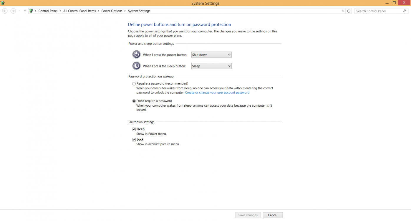

My motherboard has a utility which tells me that fast boot is enabled and I also have Intel rapid start enabled.
As for windows, this is the page with my power options - I don't know how to enable windows fast startup, or check to see if it is already enabled.

Clicking on the link in my post above will help show you how to check Fast Startup. It requires that you have hibernate enabeled though.
