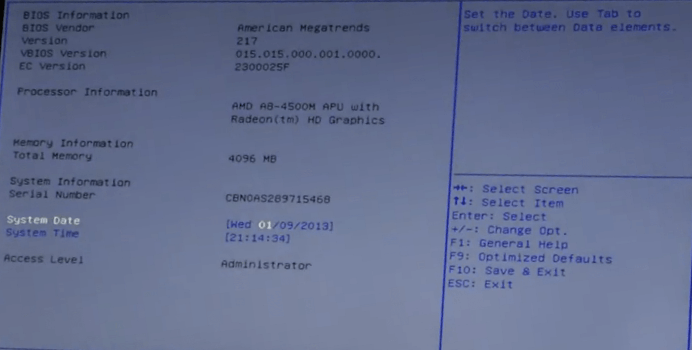

New Asus K55 laptop has under BIOS Security tab>I/O Interface Security>Secure Boot state>Enabled
but the cursor will not go to it.
Just below that there's Secure Boot Control>Enabled which description is Secure Boot flow control and allows changing to Disabled.
How exactly do I disable Secure Boot in this case? Do I need to give it an Admin Password first?

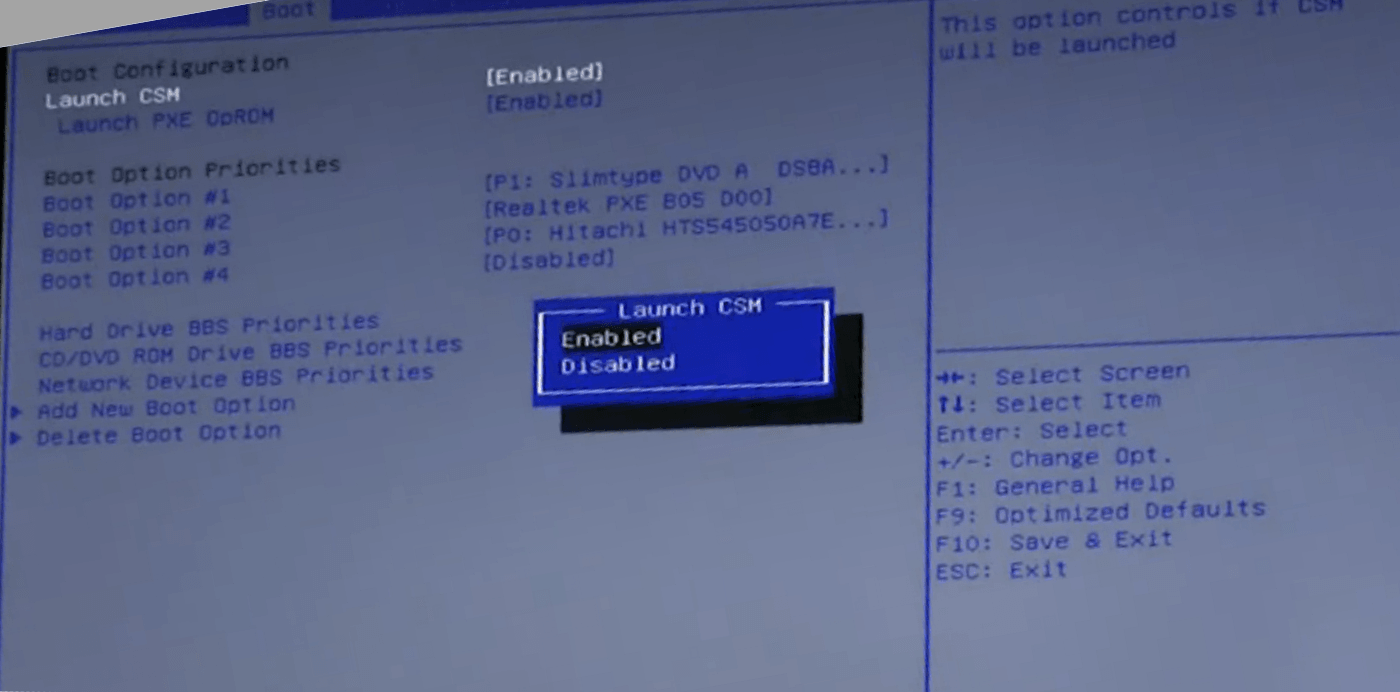

Have ENABLED CSM?
How to ENABLE CSM.
ASUSTeK Computer Inc. -Support- Windows 8 Support Information
ASUS said:
How do I boot to DOS with USB Flash drive or USB CD-ROM?
Solution
Enter the BIOS setup menu by pressing and holding F2 key when powering on.
Switch to "Boot" and set “Lunch CSM” to Enabled.
Switch to "Security" and set "Secure Boot Control" to Disabled.
Press F10 to save and exit.

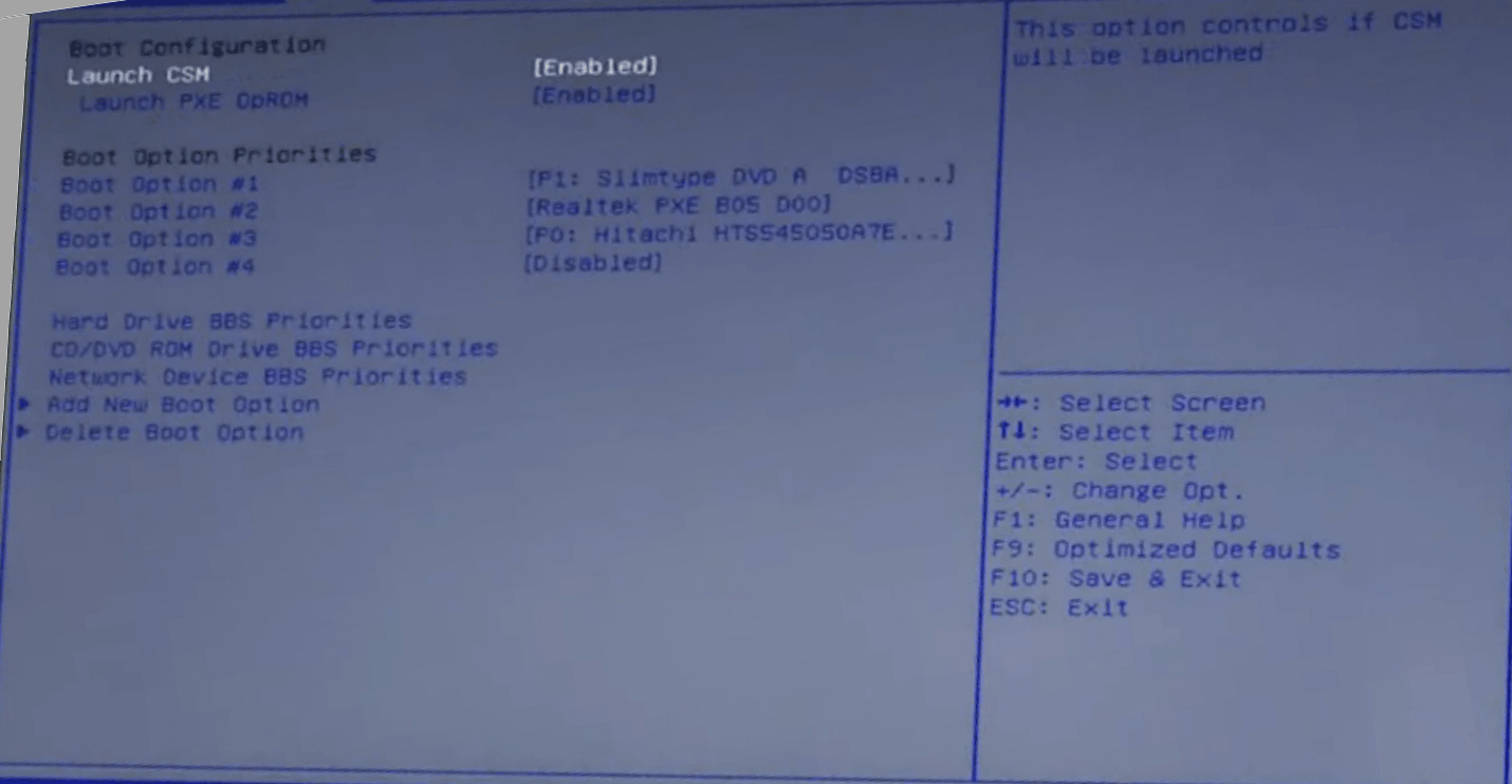

What options do you have in CSM, UEFI or UEFI & Legacy is needed.
Found some Asus K55N screenshots, but not options in CSM.
ENABLE CSM
ENABLE PXE OpROM
ENABLE Secure Boot
