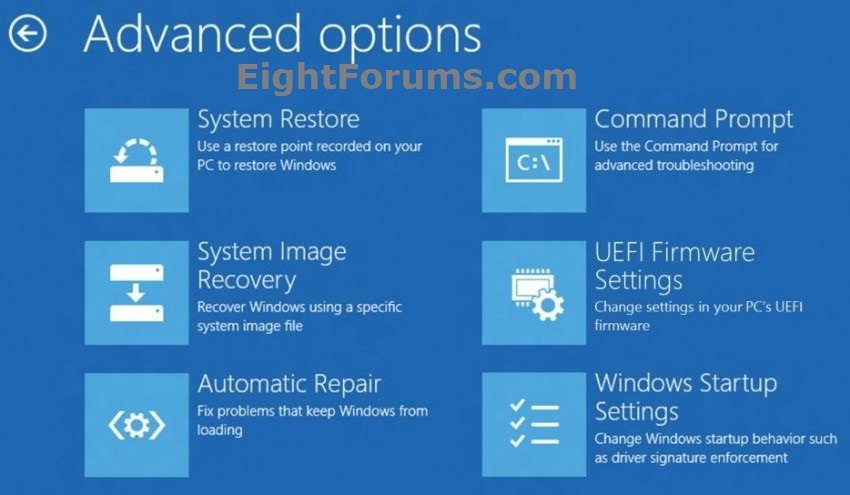

1. Do step 2 or 3 below depending on how you would like to boot to the UEFI firmware settings.
2. Boot to UEFI Firmware Settings in Windows 8/8.1 "Advanced Options" UI
A) Boot to the UEFI Firmware Settings, then go to step 4 below. (see screenshot below)

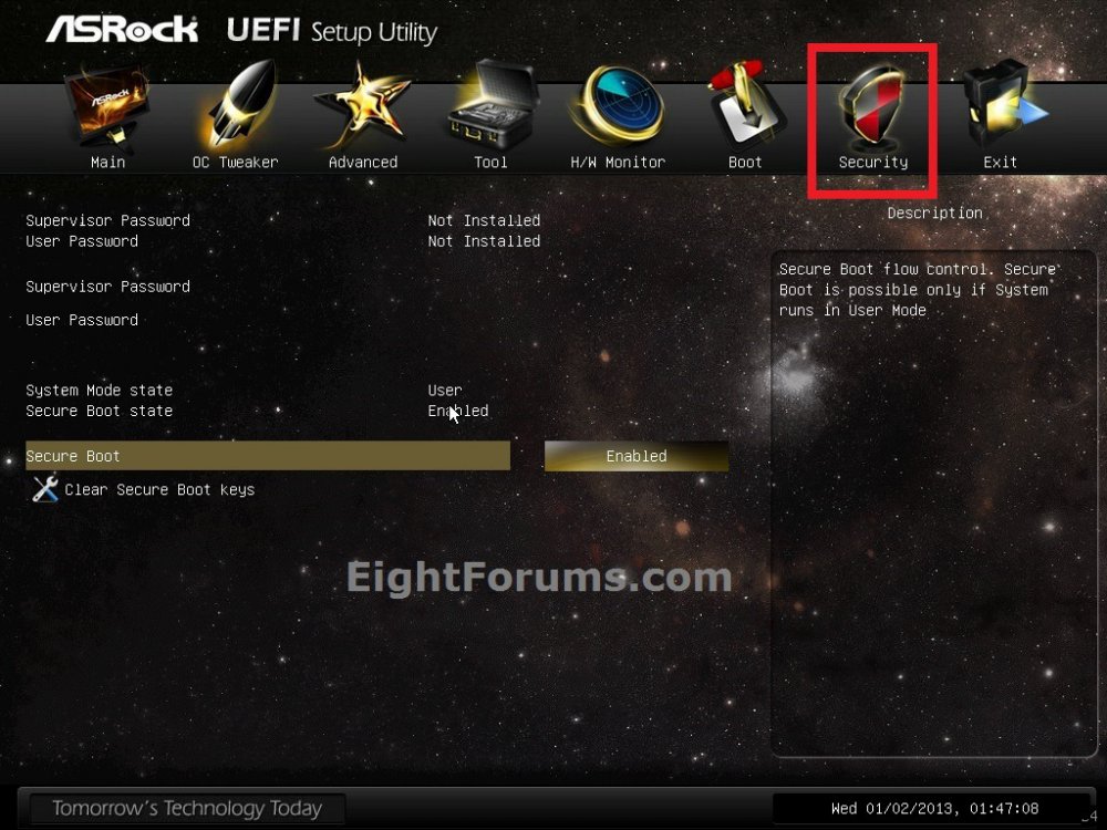

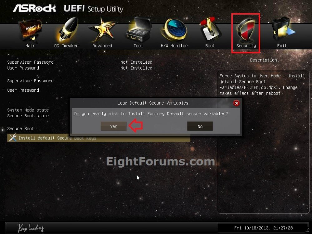

4. In the motherboard's UEFI firmware settings, click/tap on the Security menu, select the Secure Boot option, and click/tap/press Enter to enable or disable it. (see screenshots below)

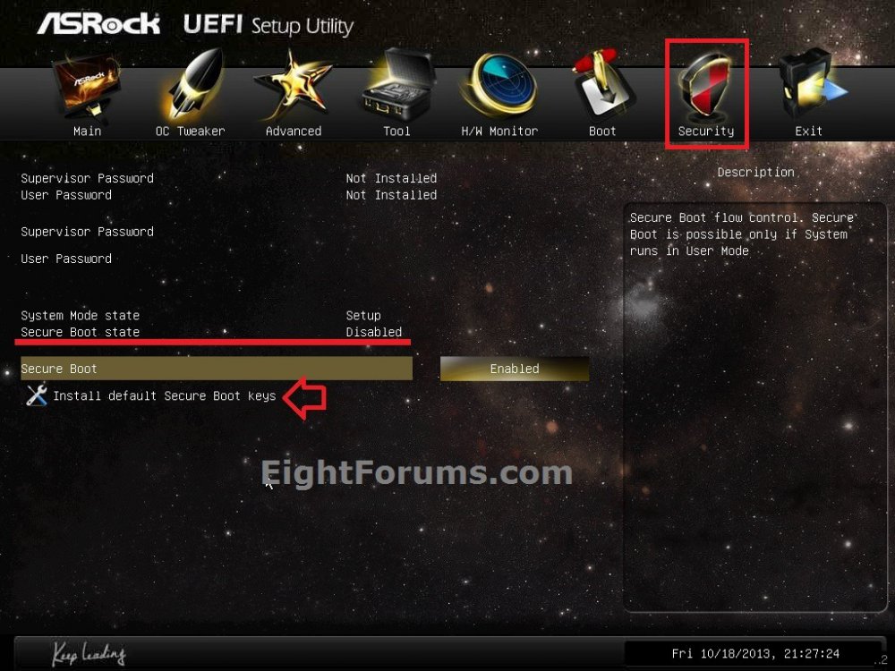

5. If you enabled secure boot, then click/tap on the "Install default Secure Boot keys" option. (see screenshot below)
NOTE: This is to configure secure boot.
A) Click/tap on Yes to approve. (see screenshot below)
B) Secure boot has now been enabled and configured. (see screenshot below)

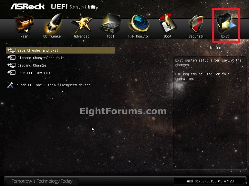

8. Click/tap on the Exit menu, and click/tap on Save Changes and Exit (reboot). (see screenshot below)
NOTE: You can usually also press the F10 to save changes and exit.
9. The computer will now restart to startup Windows.

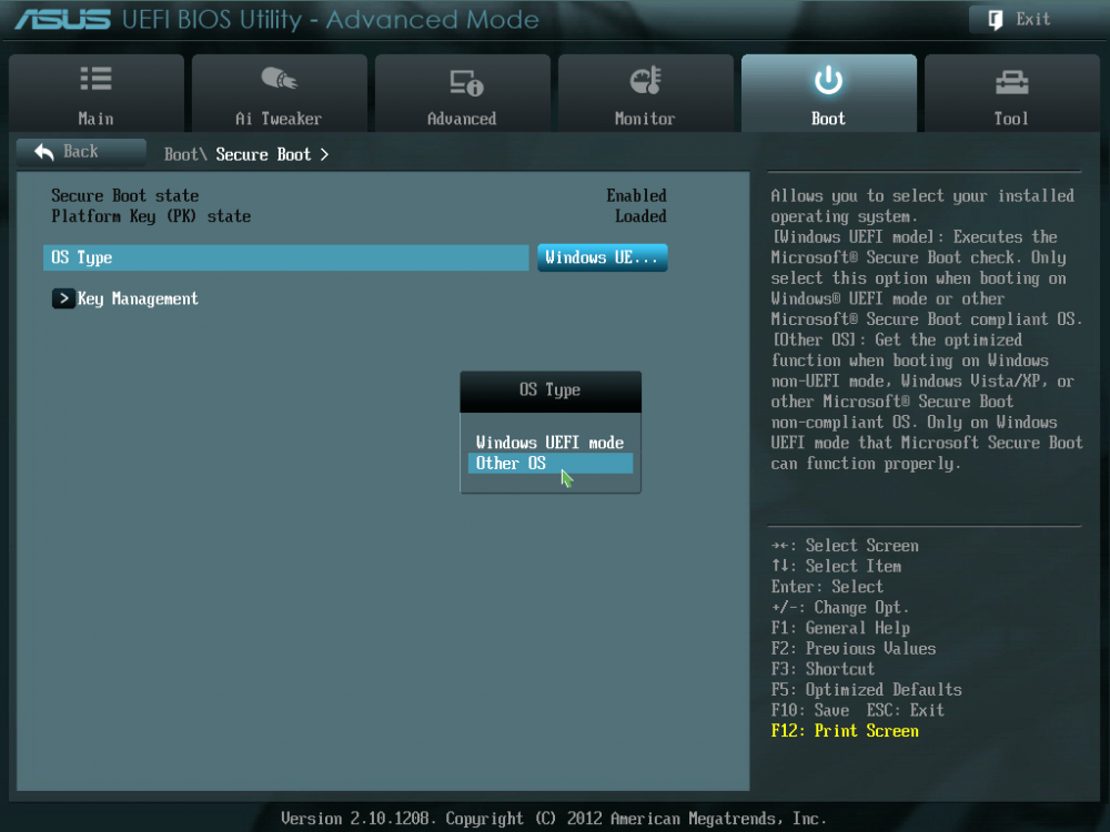

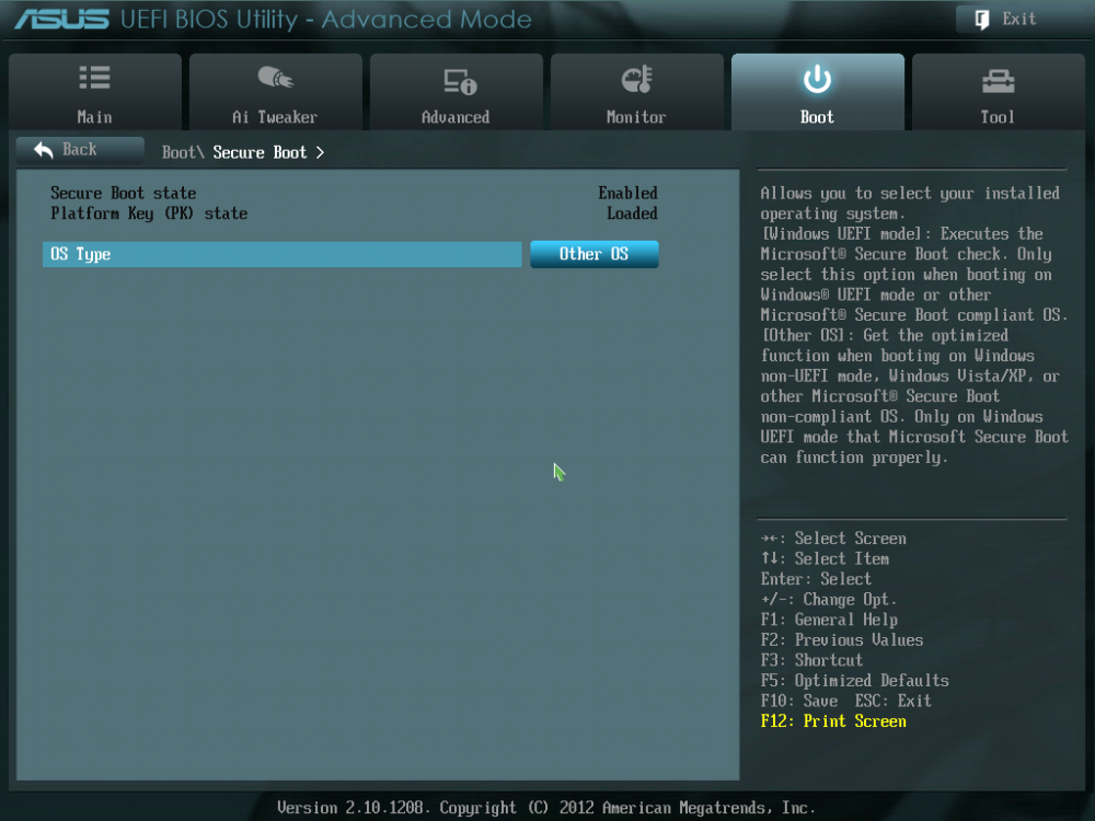

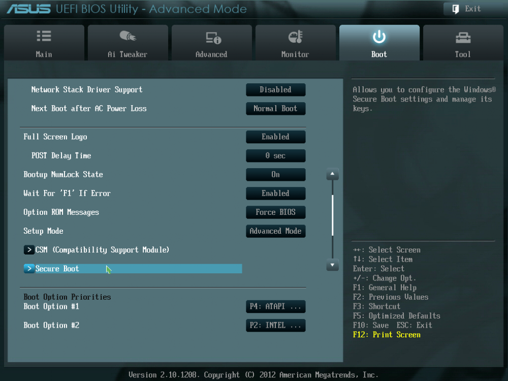

Using an ASUS P8Z77-V Pro motherboard, it's worded slightly differently
1) In advanced mode after hitting the delete key to get into the UEFI settings, click the boot tab
2) Scroll down to "secure boot"
3) Click OS type, and then click Other OS, I am presuming this is another way of saying Secure boot disabled, looking at the description on the right

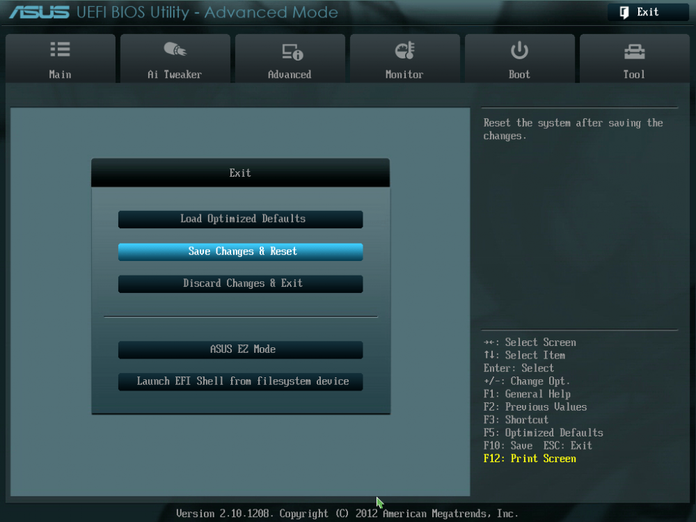

4) Click exit in the top right and then click save changes and reset

Thank you Danspy. I added this motherboard to the Note box for others to reference to help them with. :)

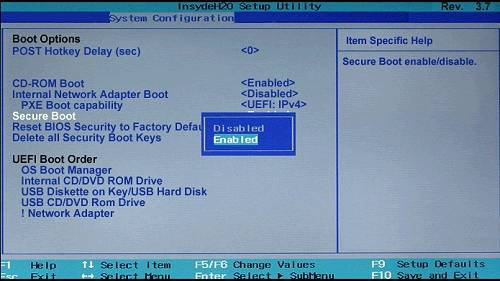

By seting your uEFI/BIOS firmware, to Secure Boot DISABLED, you can install
NOTE: Check your manufacturer's uEFI BIOS manual for settings.
