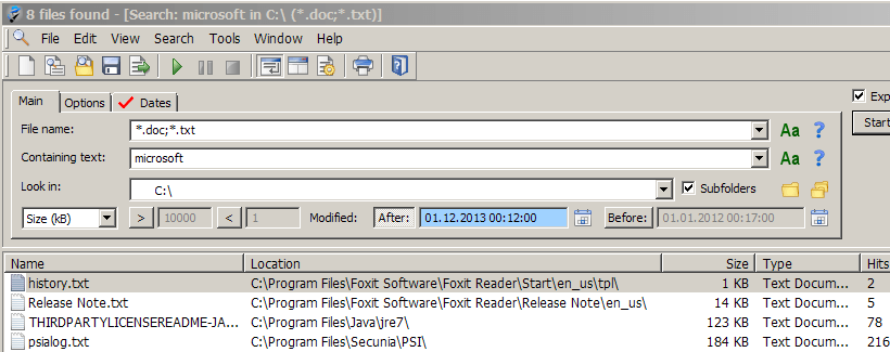

Hello, yes, Agent is 'terribly' good at finding stuff, I personally gladly trade some speed for reliability and ease of use compared to w search. For 'content search' remember to set a few criteria (if practical), see example in attachment (you may be doing this already, then please disregard this comment). That search took 10 seconds, without the criteria it may take an hour while it ransacks many file types not likely to contain anything one is looking for.

4wd, thanks, I did discover that narrowing down the search speeds up the search enormously, and makes the tool quite usable.
the easiest way I know, go into Windows file explorer and select something like My Documents, or Dropbox, and then start up AgentRansack with a right mouse-click, it will then search only in the select area, with impressive results. Tell me if you have a better way to do it
