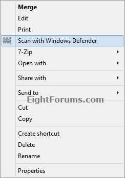

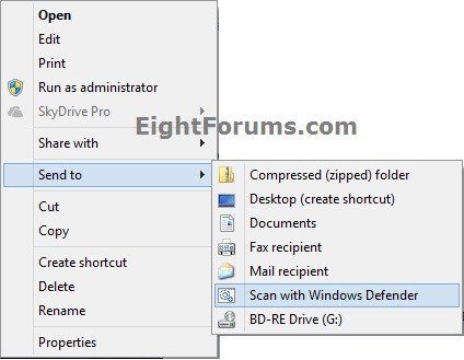

This tutorial will show you how to add "Scan with Windows Defender" to the context menu for you to be able to scan any file or folder in Windows 8, Windows RT, Windows 8.1, and Windows RT 8.1.
When added, you will be able to right click or press and hold on any file or folder, then either click/tap on Send to and/or Scan with Windows Defender to scan it.

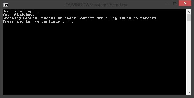

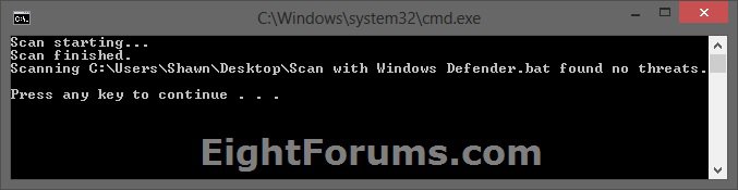

This will open a command prompt showing you the scan results, then you can press any key to close the command prompt.
EXAMPLE: "Scan with Windows Defender" in Context Menu in Windows 8
EXAMPLE: "Scan with Windows Defender" in "Send to" Context Menu in Windows 8

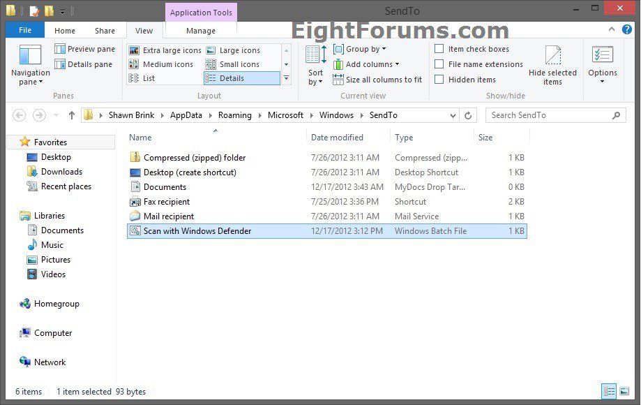

Add or Remove "Scan with Windows Defender" Send to Context Menu
This option will only add this to your user account, and not all users.
1. Click/tap on the download button below to download the .bat file.​
Scan with Windows Defender.bat
2. Save the .bat file to your desktop, and unblock it.​
3. Press the :winkey: + R keys to open the Run dialog.​
4. Type shell:sendto, and press Enter.​
5. Move the Scan with Windows Defender.bat file into the SendTo folder, and close the SendTo folder. (see screenshot below)​
Tip   Tip
To remove "Scan with Windows Defender" in "Send to", you would just need to delete the Scan with Windows Defender.bat file in the SendTo folder.
Tip   Tip
If you like, you could keep the .bat file saved at another location, and create a shortcut to place in the SendTo folder instead. This way you could change the icon to what you like, and not have the file extension show if set to do so. The Windows Defender icon is located in the "C:\Program Files\Windows Defender\MSASCui.exe" file.​

Hello, I spent some hours trying to figure out how to add a file scan by right clicking and also being able to pause it after the scan is complete even when threats are not found. So here it is:
This .reg file adds a folder & file scan context menu for Windows Defender and it always pauses after the scan is complete to clearly see the results.

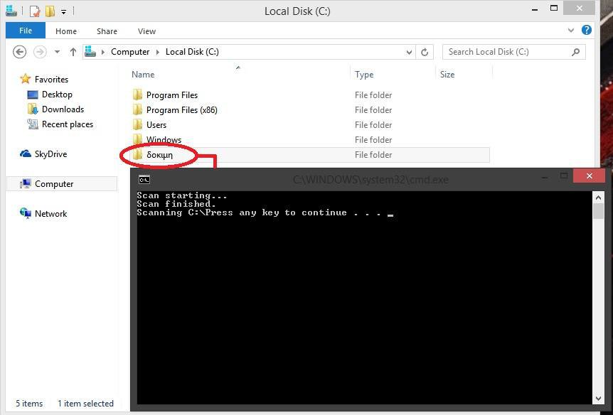

It woks great and yes the remove.reg needed some cleanup now that I saw it. The only limitation I know of is that when non-english paths are scanned the string will be cut from cmd window.
So if the path is for example: C:\NON-ENGLISH-FOLDER-NAME\
It will show after scan: Scanning C:\Press any key to continue...
That's a MpCmdRun.exe limitation and not really a problem.

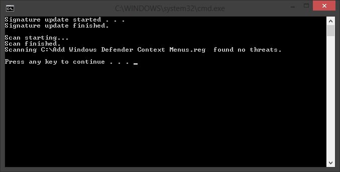

Update:
I noticed that the -UpdateSignatures command was doing nothing the way it was implemented so I fixed it. Now the script first updates Windows Defender with the latest online signatures and then scans the requested file, folder, drive etc.
Changelog:
- Fixed/Added Signature Update before Scan
- Added "new lines" between update - scan - pause to look better (like pressing enter)
