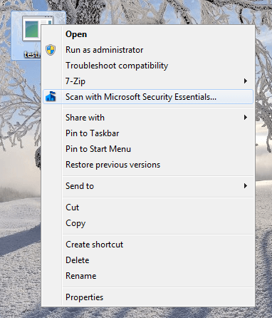

This tutorial will show you how to add "Scan with Windows Defender" to the context menu for you to be able to scan any file or folder in Windows 8, Windows RT, Windows 8.1, and Windows RT 8.1.
EXAMPLE: "Scan with Windows Defender" in Context Menu in Windows 8
EXAMPLE: "Scan with Windows Defender" in "Send to" Context Menu in Windows 8
Add or Remove "Scan with Windows Defender" Context Menu

2. To Remove "Scan with Windows Defender" from Context Menu
NOTE: This is the default setting. It will remove both step 3 and 4 below.
A) Click/tap on the Download button below to download the file below, and go to step 5 below.
Remove_Scan_with_Windows_Defender__Context_Menu.reg
3. To Add "Scan with Windows Defender" to Context Menu
Add_Scan_with_Windows_Defender__Context_Menu.reg
4. Add Update Windows Defender and "Scan with Windows Defender" to Context Menu
Add_Update_and_Scan_with_Windows_Defender_Context_Menu.reg
5. Save the .reg file to your desktop.
6. Double click/tap on the downloaded .reg file to Merge it.
7. If prompted, click/tap on Run, Yes (UAC), Yes, and OK to approve the merge.
Add or Remove "Scan with Windows Defender" Send to Context Menu
This option will only add this to your user account, and not all users.
1. Click/tap on the download button below to download the .bat file.
Scan with Windows Defender.bat
2. Save the .bat file to your desktop, and unblock it.
3. Press the :winkey: + R keys to open the Run dialog.
4. Type shell:sendto, and press Enter.
5. Move the Scan with Windows Defender.bat file into the SendTo folder, and close the SendTo folder. (see screenshot below)
To remove "Scan with Windows Defender" in "Send to", you would just need to delete the Scan with Windows Defender.bat file in the SendTo folder.
If you like, you could keep the .bat file saved at another location, and create a shortcut to place in the SendTo folder instead. This way you could change the icon to what you like, and not have the file extension show if set to do so. The Windows Defender icon is located in the "C:\Program Files\Windows Defender\MSASCui.exe" file.
