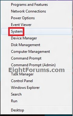

2. Open the Power User Tasks Menu, click on System, and go to step 5. (see screenshot below)

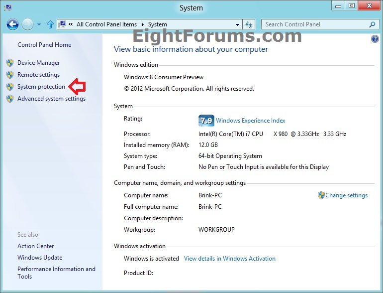

3. Open the Control Panel (icons view), click on the System icon, and go to step 5.

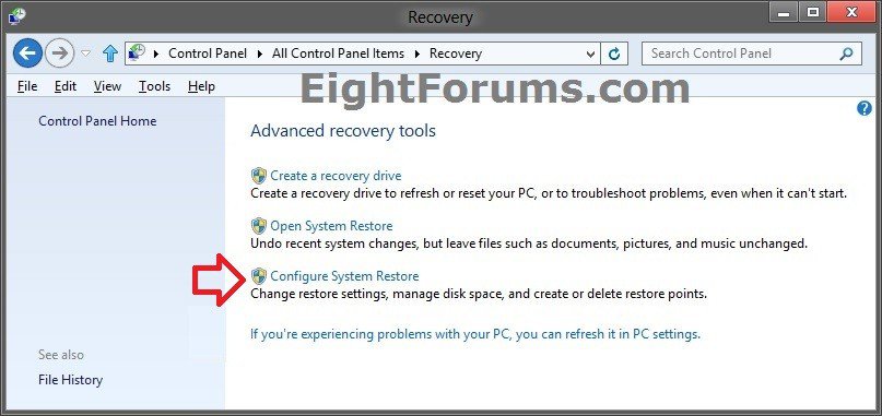

4. Open the Control Panel (icons view), click on the Recovery icon, click on the Configure System Restore link, and go to step 6. (see screenshot below)
5. Click on the System protection link in the left pane. (see screenshot below)

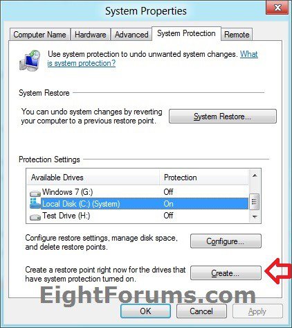

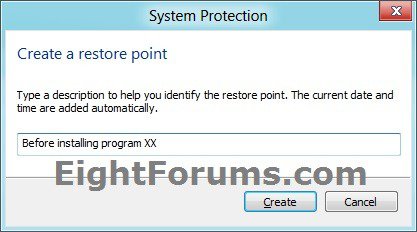

7. Click on the Create button. (see screenshot below)
NOTE: This will create a restore point for all drives that have system protection turned on.
8. Type in a description that helps you to identify the restore point when doing a system restore. (see screenshot below)
NOTE: The current date and time are added automatically to the restore point.

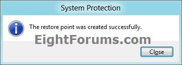

9. When it's finished creating the restore point, click on Close. (see screenshots below)

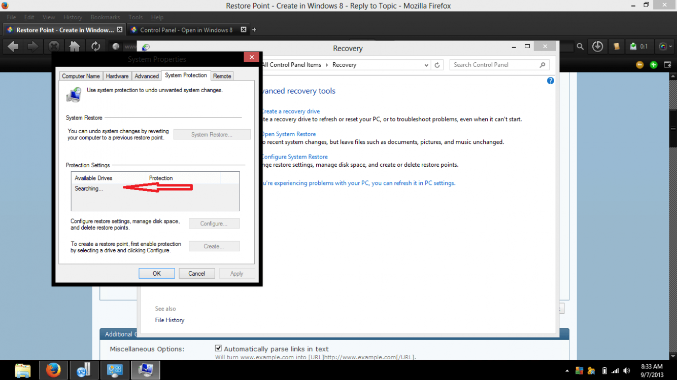

I am trying to set up a restore point but I'm not having much luck. If you'll notice beside the arrow in the included pic, it just says "searching". It's been searching for a while now. :think: Also, "configure" and "create" aren't clickable buttons? What am I doing wrong?
