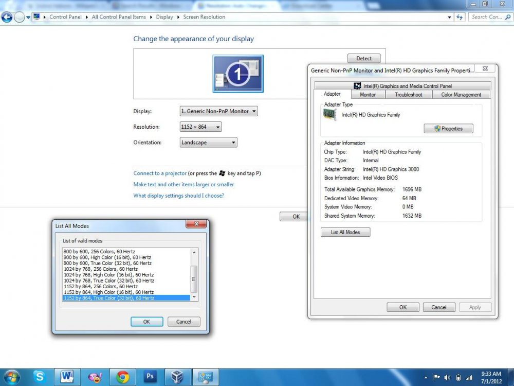

I Run Windows 7 as my host OS on my Laptop for the past 2 years.. And about a week ago, i realized that my resolution changed from 1366x 768 px to 1156x 864 px. Because of this, my Virtualbox also can not run in Full Screen mode on 1366 x 568px. Any help?
Additional Details: My Maximum resolution now is 1366x 768 Pixels.

Can you see and post your resolution from these windows (here example 1024x768):
There should be a solution for that problem.

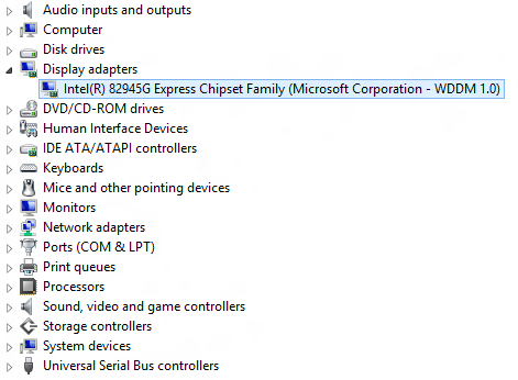

Have a look in your Device Manager (here's example):
Look for that (whatever your card is named) on Intel's drivers site and update it manually (download a zip) or automatically (download a exe)

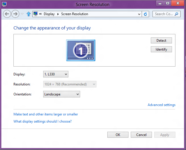

I have a laptop too but I see the one resolution in top of the list marked as recommended (this is native for the LCD).
Is there a resolution marked as recommended? The 1152x864 isn't marked as recommended above. So I also think it's not the highest.
As you said, there should be a 1366x768 on the list and that's missing now: have to say I've never encountered this before.

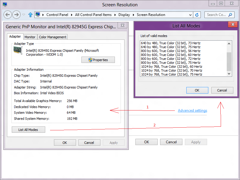

Some examples about the recommended resolution on LCD's:
On an older LCD monitor with maximum 1024x768 I get this:
Important:

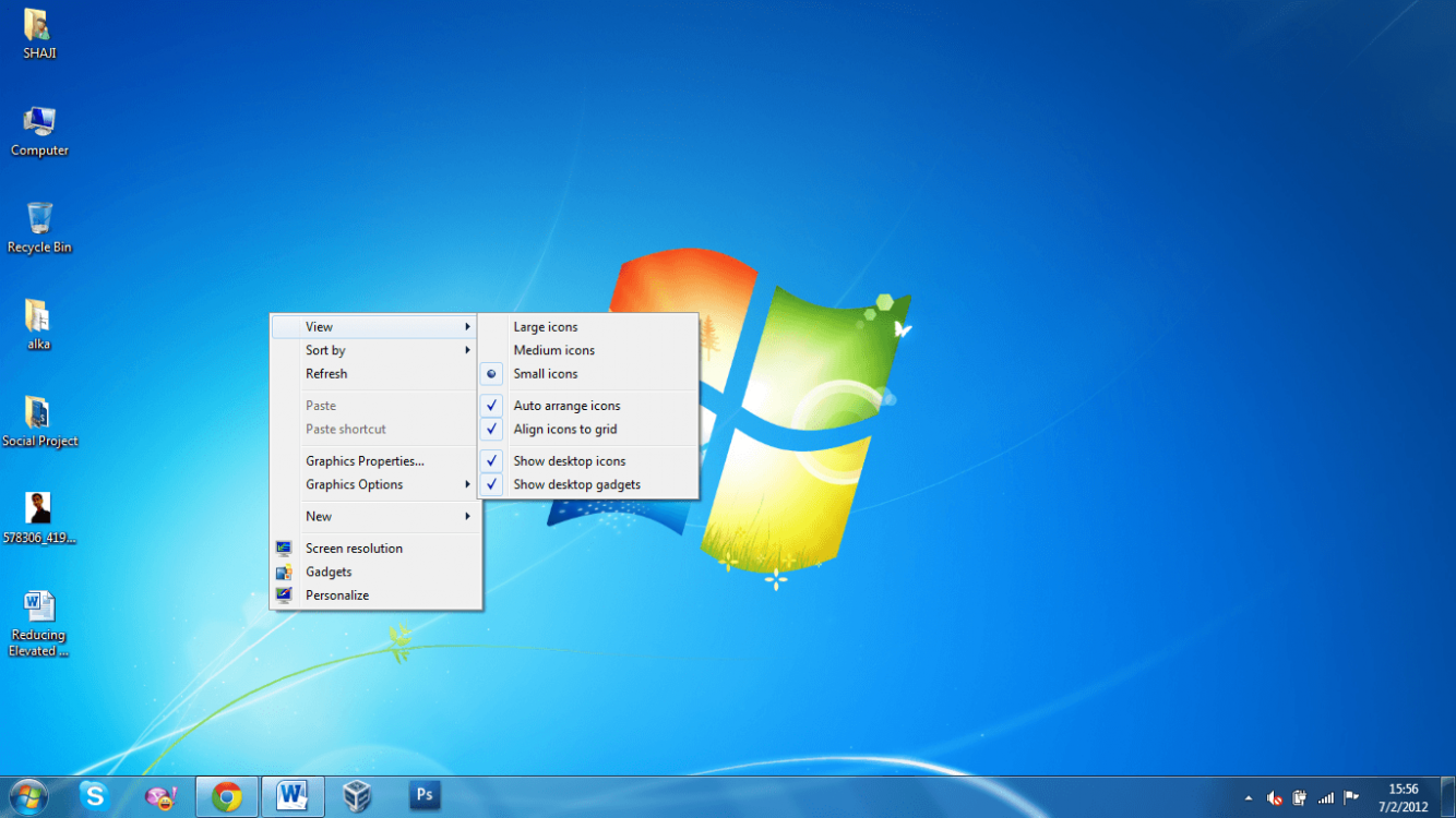

Is there a Intel Graphics icon in tray? (see screenshot below) or Control Panel:
Look there for graphics settings and resolutions.

Normally there has to be a Intel option in tray icon (down in right corner) or
ctrl+alt+f11 toggle keys.
