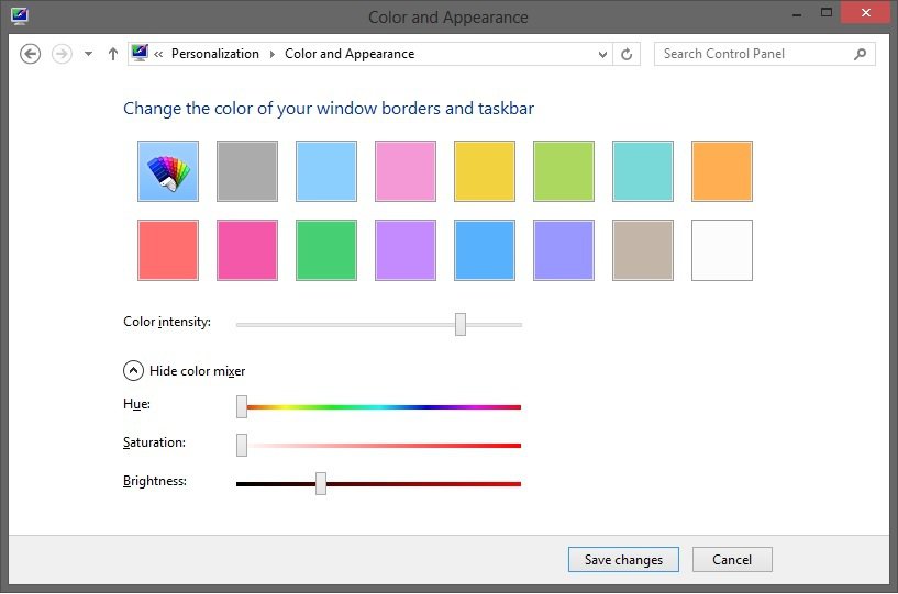

Very Very Nice Tutorial Shawn...... :)
I have one question for you, Are you using anything like classic shell ,etc to customize your Windows 8 theme? because your theme looks more realistic than the original Win8 Theme.
If you are using please tell me the name of the software, I also want to use it...... :)
Thanks........... :)
    Windows® 8.1 Pro 64-Bit
    Dell® XPS® 15-9530
    Intel® Core™ i7 4702HQ @3.20GHz
    Intel® HM86 Express Chipset
    Dell® 16GB DDR3 1600MHz
    NVIDIA® GeForce® GT 750M 2GB GDDR5
    Intel® High-Definition Audio
    Dell® LED™ 15.6-Inch QHD+
    3200 x 1800
    Samsung® SSD™ 840 Pro 512GB
    Dell® 91 WHR 6-Cell Battery
    Dell® Machined Aluminium Chassis
    Dell® Cooling
    Dell® Integrated Keyboard
    Dell® TouchPad
    Download Speed- 50.0 MBPS Upload Speed- 20.0 MBPS
    Mozilla® Firefox® 29.0
    Kaspersky® PURE® 3.0 Total Security
    Network Adapter- Intel® Dual Band Wireless-AC 7260 + Bluetooth 4.0
25,084
Thank you Narayan. I'm glad you like it. :)
Nope, just using a "Windows Default Theme" with these color settings below.
(top second from left color)
