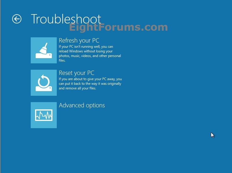

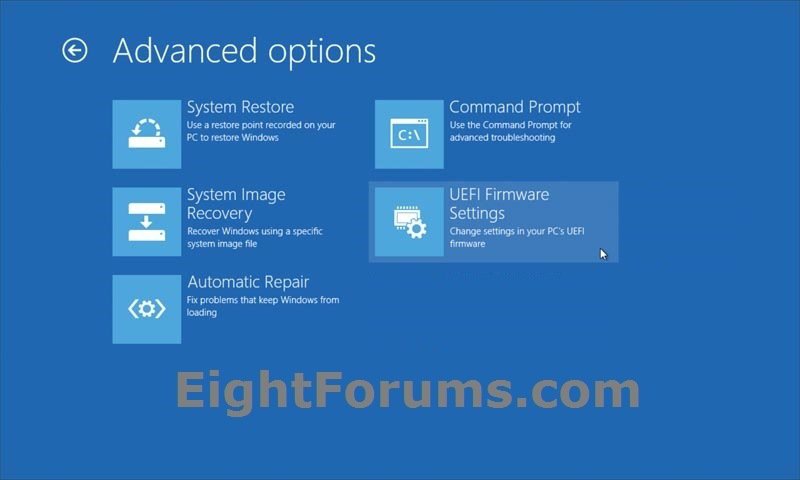

EXAMPLE: System Recovery Options
NOTE:

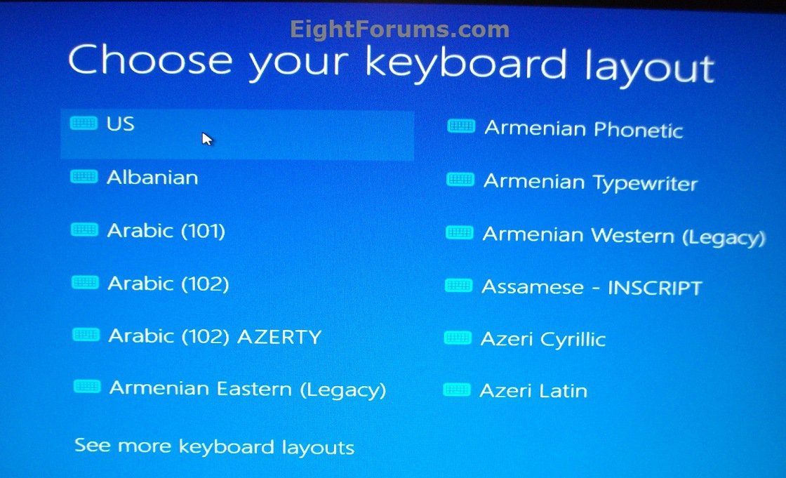

After you boot from the recovery USB flash drive, you will need to select your language and keyboard layout (if displayed) for Windows 8, then select Troubleshoot to see the system recovery options.

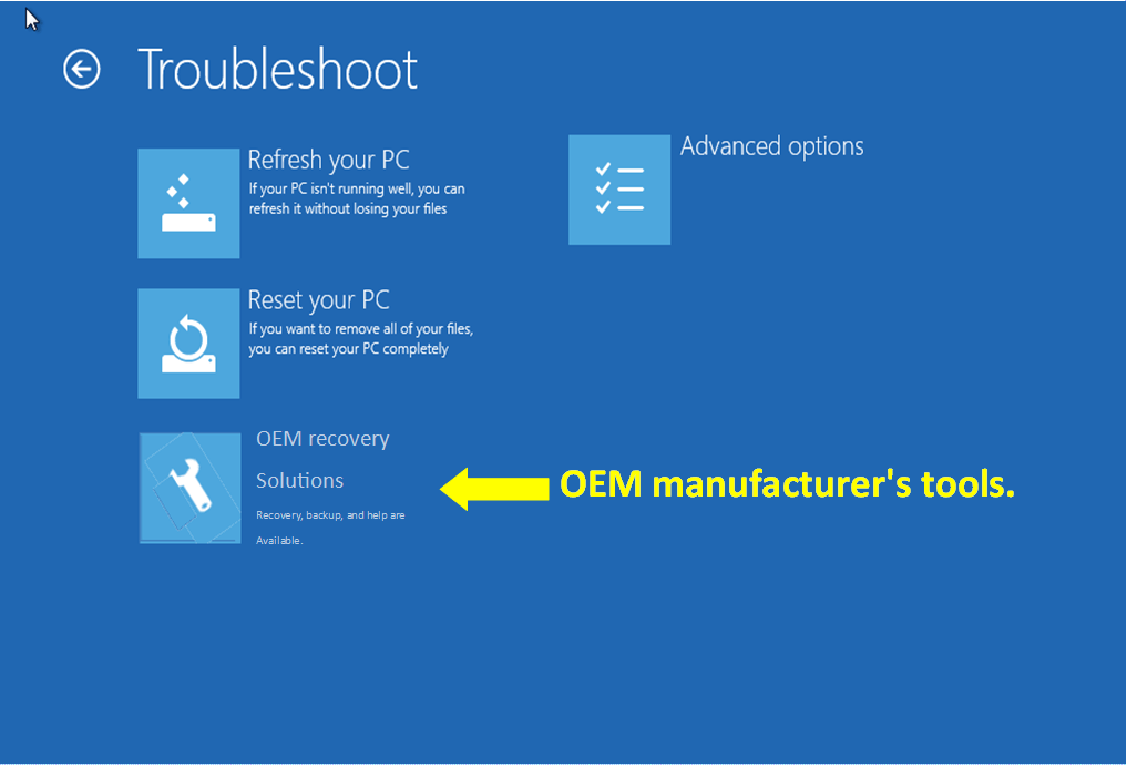

(On some newer OEM PC's with Windows 8 preinstalled, you may have the option to reinstall in the OEM manufacturer's tools like below if the Recovery Partition is still in place.)​

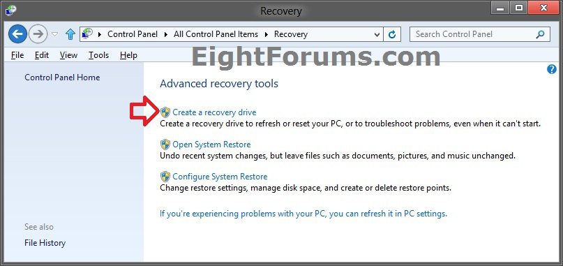

3. Open the Control Panel (icons view), and click/tap on the Recovery icon.
A) Click/tap on the Create a recovery drive link, and go to step 4 below. (see screenshot below)​

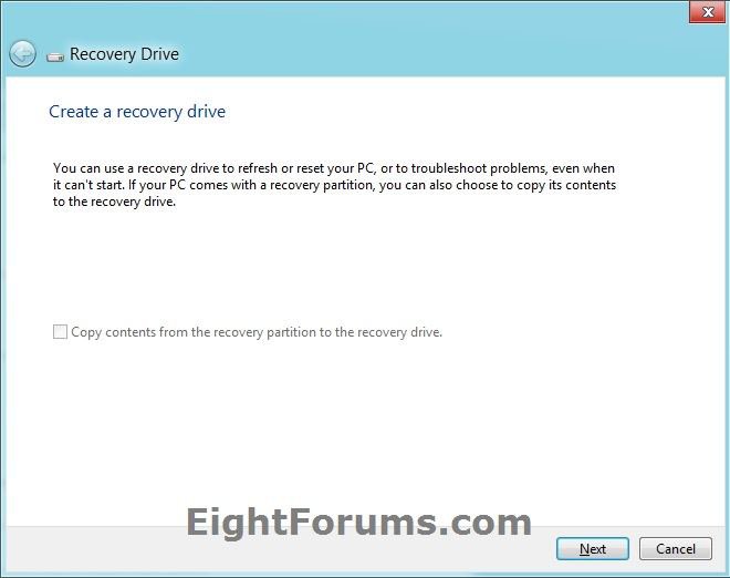

5. Click/tap on Next. (see screenshot below)
If you have a store bought OEM computer that came with Windows 8 preinstalled, then you could also check the Copy contents from the recovery partition to the recovery drive box to be able to use the recovery USB flash drive to do a factory restore/recovery of Windows 8.
If you do not have an OEM recovery partition, then the Copy contents from the recovery partition to the recovery drive option will be grayed out.
If you checked the Copy contents from the recovery partition to the recovery drive box, then once the Recovery Media creation has completed, you will have an option to delete the recovery partition at step 10 below. On most systems, this partition is about 10G in size.

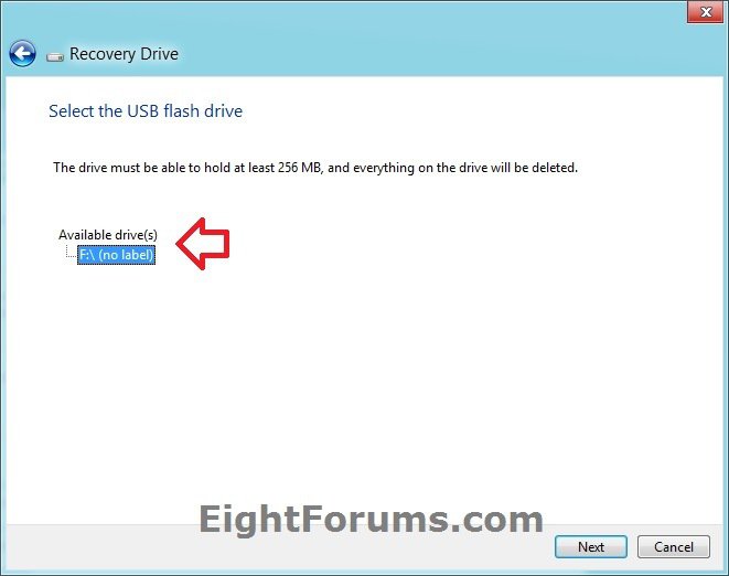

6. Select a USB flash drive at least 256 MB in size that you would like to make a bootable recovery drive with, and click/tap on Next. (see screenshot below)

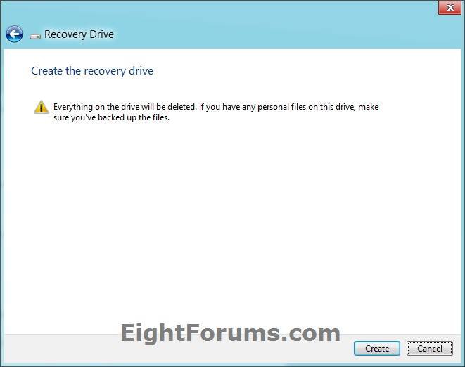

WARNING: Everything on the selected USB flash drive will be deleted, so be sure to backup anything on it that you do not want to lose first.
7. Click/tap on Create. (see screenshot below)
WARNING: This is your last chance to backup anything on the USB flash drive that you do not want to lose before doing this.

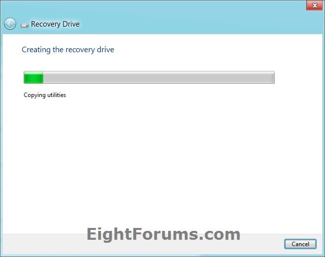

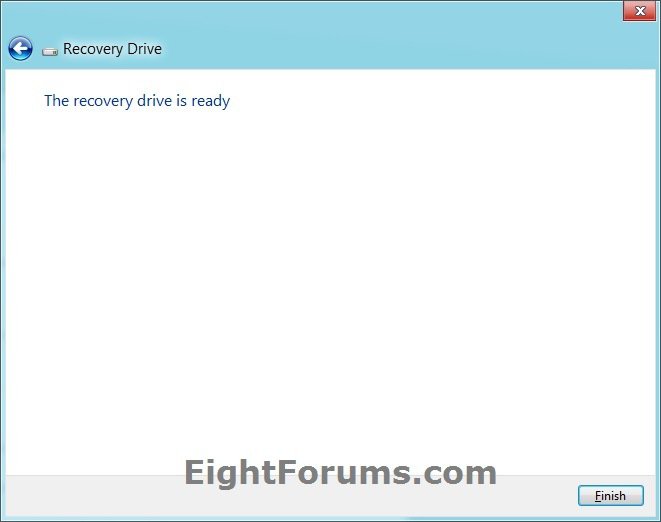

8. The USB recovery drive will now be created. (see screenshot below)
9. Do step 10 or step 11 below for what you would like to do.

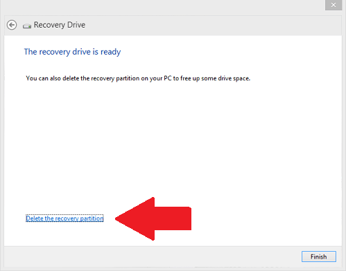

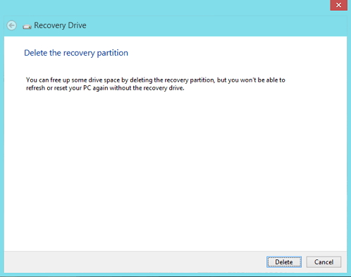

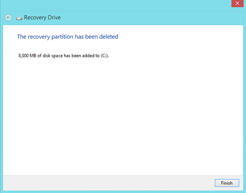

10. If you wanted to Delete the Recovery Partition
It is recommended to NOT DELETE the recovery partition. It has been reported by many that they were unable to restore Windows 8 to the hard drive using the recovery USB drive without the OEM factory recovery partition still intact.
You can free up some drive space by deleting the recovery partition, but you won't be able to refresh or reset your PC again without the recovery drive.
A) If you checked the Copy contents from the recovery partition to the recovery drive box at step 5 above, click/tap on the Delete the recovery partition link. (see screenshot below)​
B) Click/tap on Delete to confirm. (see screenshot below)​
C) Click/tap on Finish. (see screenshots below)​
11. Click/tap on Finish. (see screenshot below)

Hello. When I try to create the Recovery USB I can never seem to reach step 8 (Finish). The green progress bar moves across the screen until it reaches about a half inch from the end, then it seems to freeze up at that point. How long should it take to make the Recovery USB if the "copy contents from the recovery partition to the recovery drive" is checked, and what can I do to solve this problem? Any help here would be appreciated.

How long did you wait? Mine took a long time. It's a lot of data to flash.

It only took about 1/2 minute to create mine on a 4GB USB 2.0 flash drive.

It has been going for the last 6 hours now... I have tried this 3 times and each time it has the same problem.

Yeah that's a bit long. Mine was quite a bit longer than Brink's 30 seconds, but way way shorter than 6 hours. Maybe 10 mins? I am also copying the whole recovery partition (I suspect Brink is not?). Not sure why it would take 6 hours and not be done. Is it an old flash drive? Are you sure it's good? Have you tried a different one?

It seems like there may be an issue with your USB flash drive. It shouldn't take that long even with the slowest USB flash drive on the planet.
I would recommend to do what mbratch posted above, and try it with another USB flash drive.
I have tried on two of them, both new. 18.8GB is where it is getting stuck at.

After I unchecked the 'Copy Recovery Drive' box, I was able to complete in less than a min.

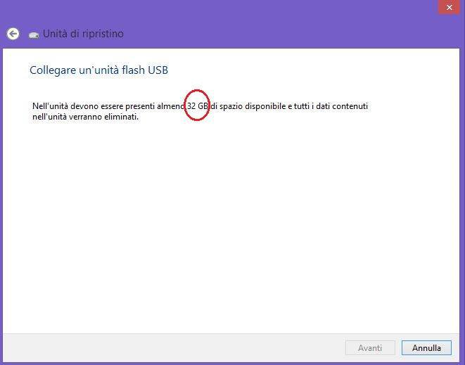

I didn't even started, it asks me for a 32 GB device... whats wrong? thanksrecovery.JPG ps I'm sorry for the italian in the screenshot but is the default setting... however is should be quite clear :(
