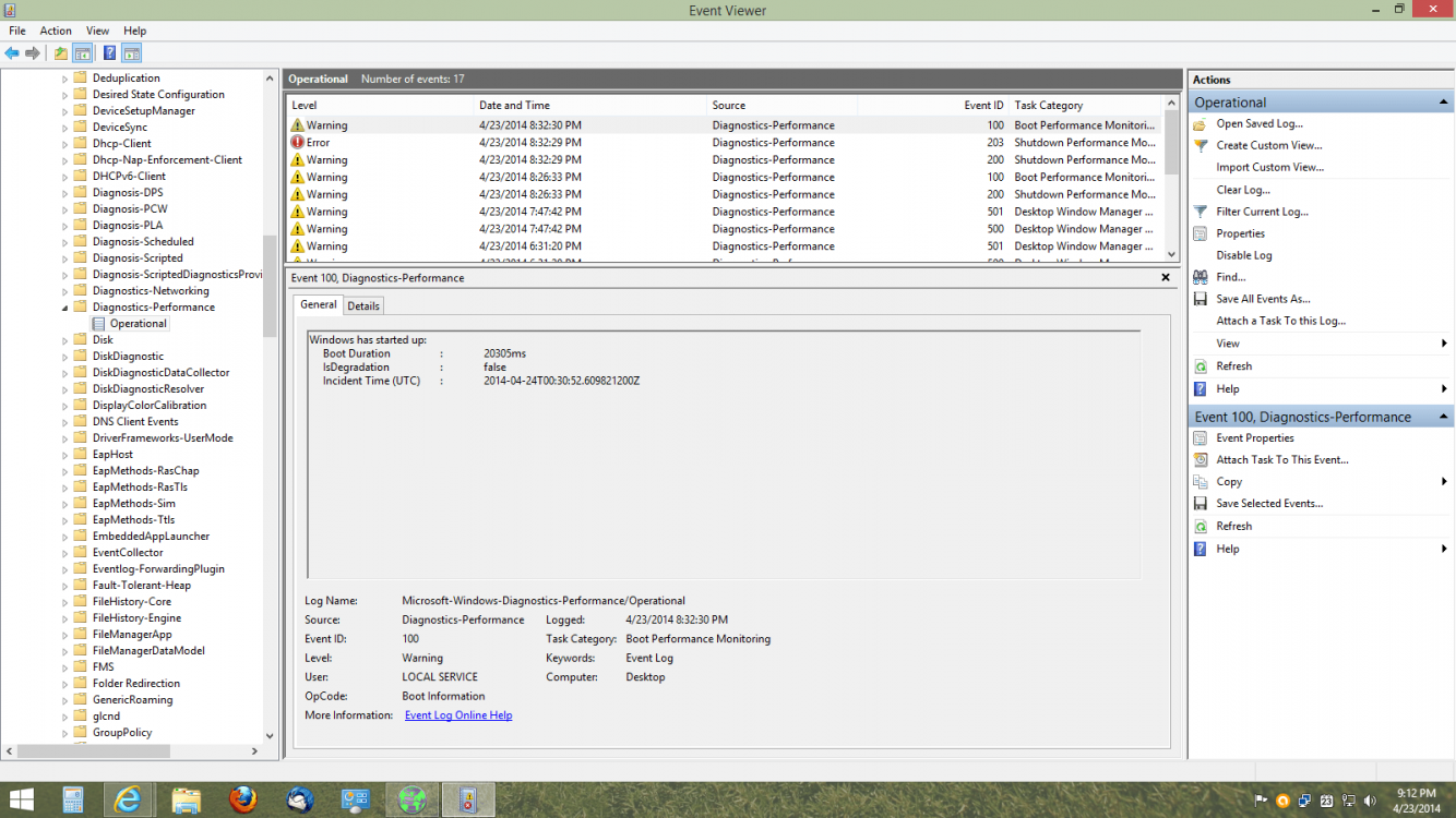

You certainly have done all the right things up to this point and your hardware looks quite capable so I cannot offer much else in the way of something you might have missed because your statement "I have booted into safemode and it occurs there as well" has me perplexed as well. [DEL]However, you might want to check your event viewer for any warnings or errors that are time-coincident with your temporary freezing situation.[/DEL] One other thought might be that, if you are using a fast UEFI boot option (the one that claims a boot to desktop in about 1 second), this might be why those icons are unclickable for an extended period because the full boot process is not actually completed at the point the desktop becomes visible. Now, I don't know if you are aware of this event log, but there is one that identifies the true boot time (and shutdown time) as well. It is located here in the event logs:
Now in my particular case, my desktop is visible in about 9-10 seconds but my total boot time was 20 seconds for my last boot and during a portion of that extended boot time, my desktop icons are slow to respond (at times). So, I'm just trying to give you some food for thought as you continue your efforts. If you need me to do any compares for you, I'm here.

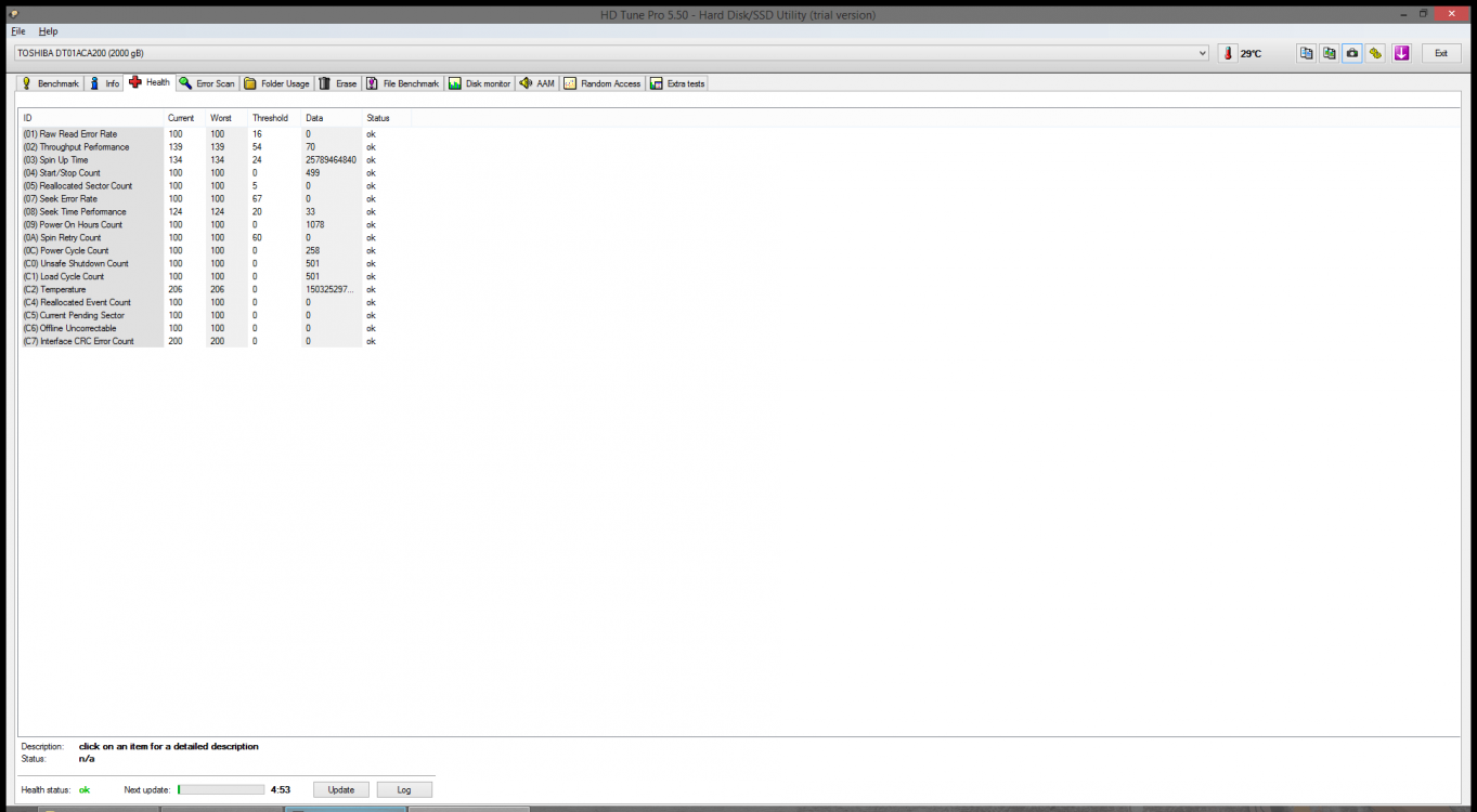

I installed HD tune pro but wasnt quite sure which tests i needed to run. Health status was good. Ran the quick scan of the bad sector test. do i need to run benmark ?
Sure run the benchmark too, will not hurt. You have extended test too. In SMART report look for "Relocated" sectors, that shows history of eventual bad sector problems.

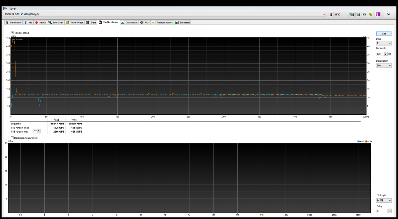

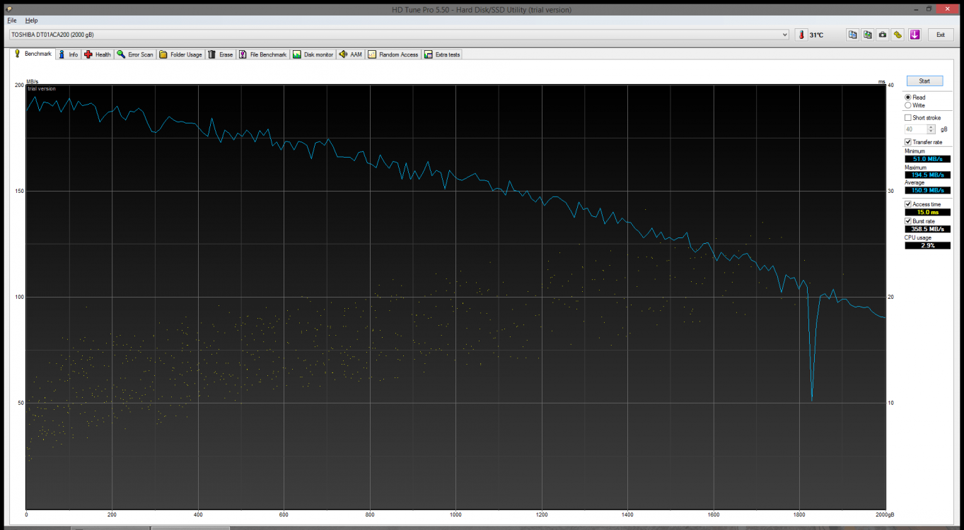

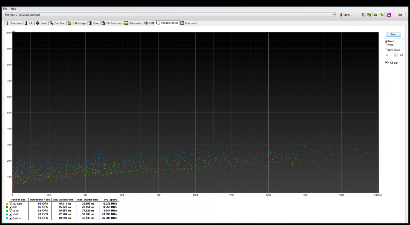

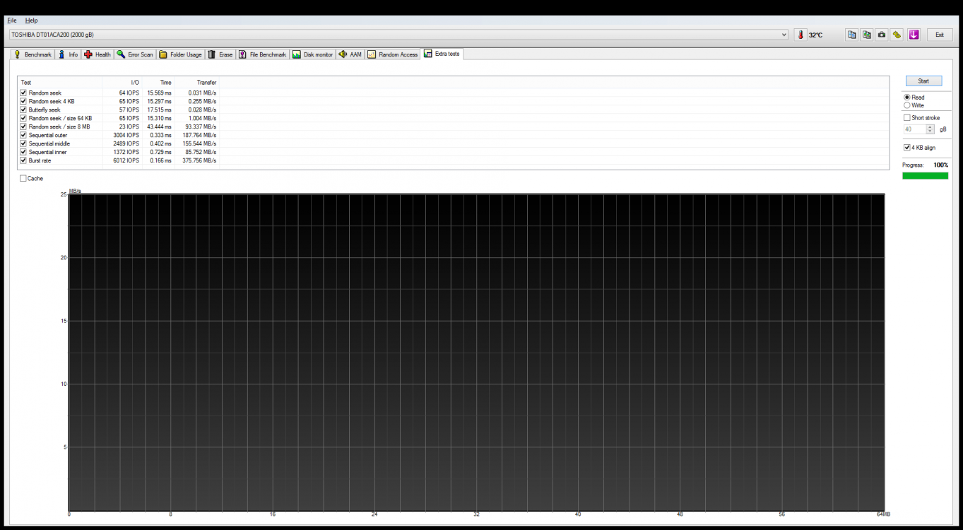

My SMART data seems to check out ok, here are some pics of the tests that were completed via HD Tune Pro. Yes, this does happen on a restart... Does GPT have any advantage over MBR for secondary hard drive? Do you think it would have any effect to reformat the secondary hard drive?
24-April-2014_05-15.png24-April-2014_05-18.png24-April-2014_05-20.png24-April-2014_05-22.png24-April-2014_15-37.png
I thought the desktop icons in question were actually pointing to locations on that secondary hard drive. However, if I read incorrectly, why not just unplug that secondary drive for a test. That should prove something.
