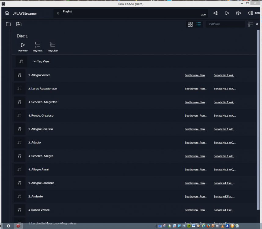

I use the audio program Linn Kazoo. When I first installed it several weeks ago, its window opened a normal size, but since an uninstall/reinstall for unrelated reasons - now three times - that's no longer been the case. Kazoo's window now always opens wide and off the bottom of the screen, down through the bottom taskbar. See the screenshot. The way I adjust window size permanently in Windows is to hold the Cntl key while resizing, but unlike other programs, such as Opera browser last night, Kazoo refuses to hold the resize on the next open or the next computer session. I've run Yamicsoft Win 8 Mgr and scannow but that didn't help. I posted the problem on the Linn forum, but someone else with the same size monitor - 1920x1200 - hasn't seen this. This is Windows 8.1 Pro x64, dpi=115%. Any ideas? Thanks,

Try holding the Shift key while resizing.
Also you can set the size and position, then save it as a custom size. You can hit a hotkey to set size and position using my MoveIt freeware. Unfortunately it only has single monitor support as that's all I have to test with. You may download from

Thanks. Holding Shift doesn't work, I had already tried it. I'm having a hard time with MoveIt. It's having no effect on Kazoo but resizing this window as I type. I don't normally use hot keys other than a few standard Windows' ones, so probably don't quite get it. Also, I don't have a Win key (IBM model M keyboard).
Did you run MoveIt as administrator? In W8 it seems to need that.
The fastest thing to try is put the mouse on the caption bar of Linn Kazoo window, hold down the middle mouse button, press the 'c' key. It should take up most of the screen and be above the Taskbar. If the Taskbar is set to AutoHide then the system does not give work area info. The work area is reported the same numbers as the screen res. Try it with AutoHide disabled.
If it does resize when you press 'c' then size the window with the mouse, middle mouse hold on caption bar and press 'z' key. An input box will open. Press the 'c' key and click OK. Now when you hotkey 'c' using the middle mouse as before, it should size and position as you set it with the mouse.
