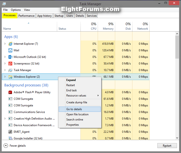

2A) Click/tap on the Processes tab, do step 2B, 2C, 2D, 2E, 2F, or 2G below, and go to step 4 below. (see screenshots below)
2B) Right click or press and hold on a parent task (ex: Internet Explorer), and click/tap on End task.

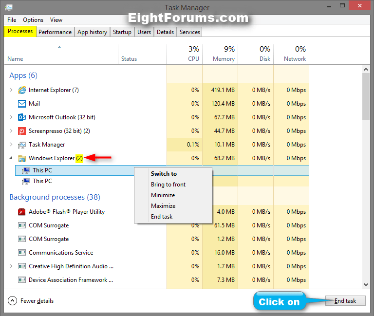

2E) Expand a parent process (ex: Windows Explorer), click/tap on a child process (ex: This PC), and click/tap on End task.
OR
2F) Expand a parent process (ex: Windows Explorer), click/tap on a child process (ex: This PC), and click/tap on the End task button.
OR
2G) Expand a parent process (ex: Windows Explorer), click/tap on a child process (ex: This PC), and press the Delete key.
If you like, you can use Switch To or Bring To Front to determine which window belongs to the child process of an app.
Switch To = Minimizes Task Manager, and brings to front the window of the selected task as the active window.
Bring To Front = Has the window of the selected task as the active window displaying up front and on top of any other windows.

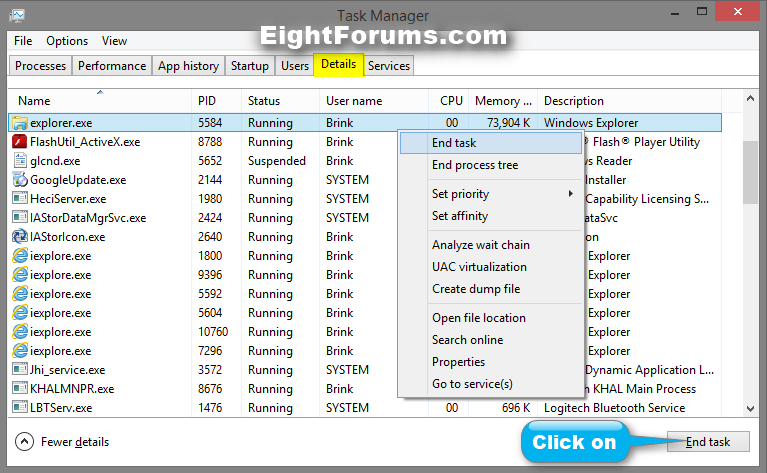

3A) Click/tap on the Details tab, do step 3B, 3C, or 3D below. (see screenshot below)

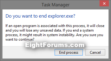

3B) Right click or press and hold on a process name (ex: explorer.exe), click/tap on End Process (only this parent process) or End Process Tree (this parent process and all child processes), and go to step 3E.
OR
3C) Click/tap on a process name (ex: explorer.exe), click/tap on the End Process button, and go to step 3E.
OR
3D) Click/tap on a process name (ex: explorer.exe), press the Delete key, and go to step 3E.
3E) Click/tap on End process to confirm, and go to step 4 below. (see screenshot below)
4. The process/task will now be ended. Sometimes it may take a moment, and sometimes you may need to end the process again before it will actually end. If the process will not end, then you could use OPTION TWO below to forcefully end the process.

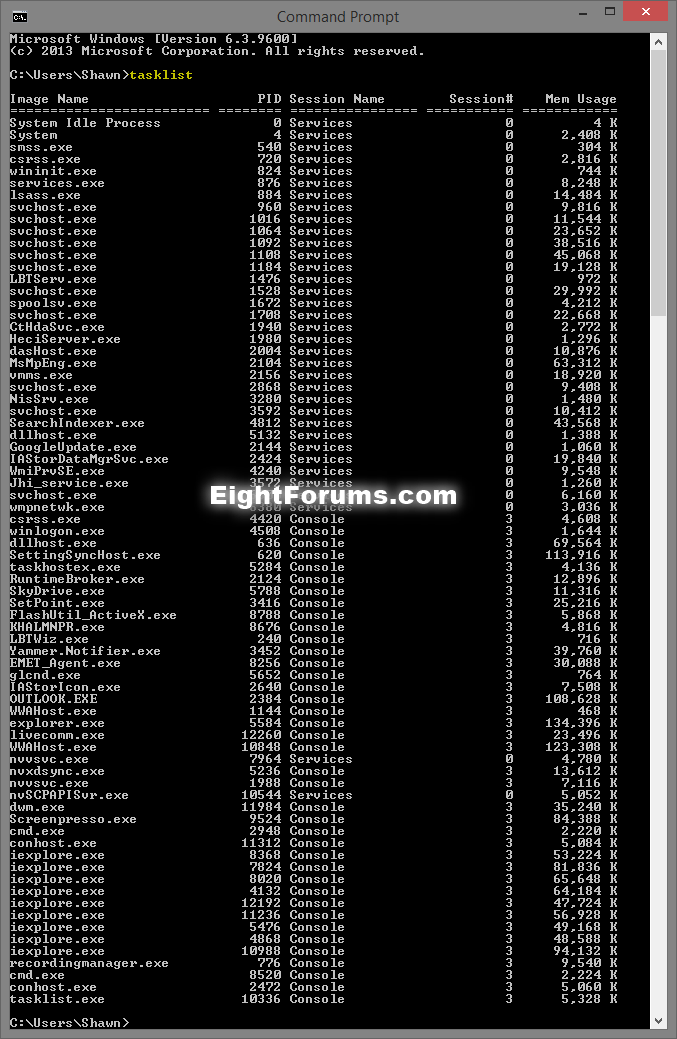

To Forcefully End a Process in Command Prompt
2. In the command prompt, type tasklist, and press Enter. (see screenshot below)
The tasklist command will display a list of all the processes that are currently running on the computer from all users.
Make note of the Image Name or PID of the process you want to end.

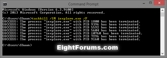

4. To Forcefully End Process using Image Name of Process
A) In the command prompt, type the command below you want, press Enter, and go to step 6 below. (see screenshots below)
(To end this process only)
taskkill /IM ImageName /F

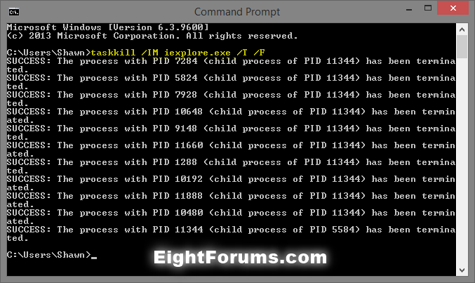

(To end this process and any child processes started by it)
taskkill /IM ImageName /T /F
Substitute ImageName with the actual image name (ex: iexplorer.exe) from step 2 above.

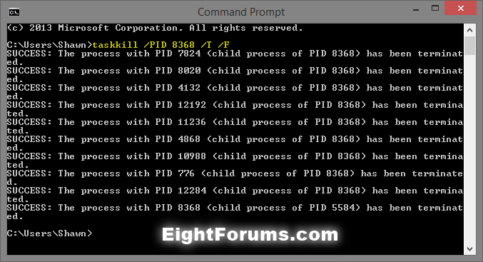

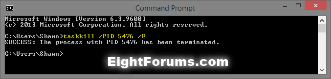

5. To Forcefully End Process using Process ID (PID)
taskkill /PID ProcessID /F
taskkill /PID ProcessID /T /F
Substitute ProcessID with the actual PID (ex: 5476) for the process (ex: iexplorer.exe) from step 2 above.
