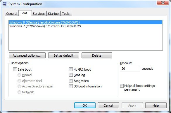

Once you've managed to boot up, type msconfig.exe into the search and you should get this (it'll start up in the general tab):
If you can see both OSes, highlight Windows 7 and select 'Set as default' and re-boot to see if it works.
